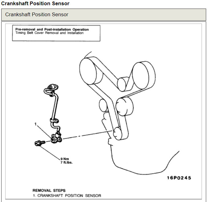

It sounds like you have a crankshaft angle sensor that is out but we should run the codes first to see what comes up.

Yes, some chain stores can be iffy. The crankshaft sensor would be my first guess. Here is a guide to help you see what you are in for when changing the sensor out:
When these sensor go out they usually dont set a code. Here is the location for your car.
