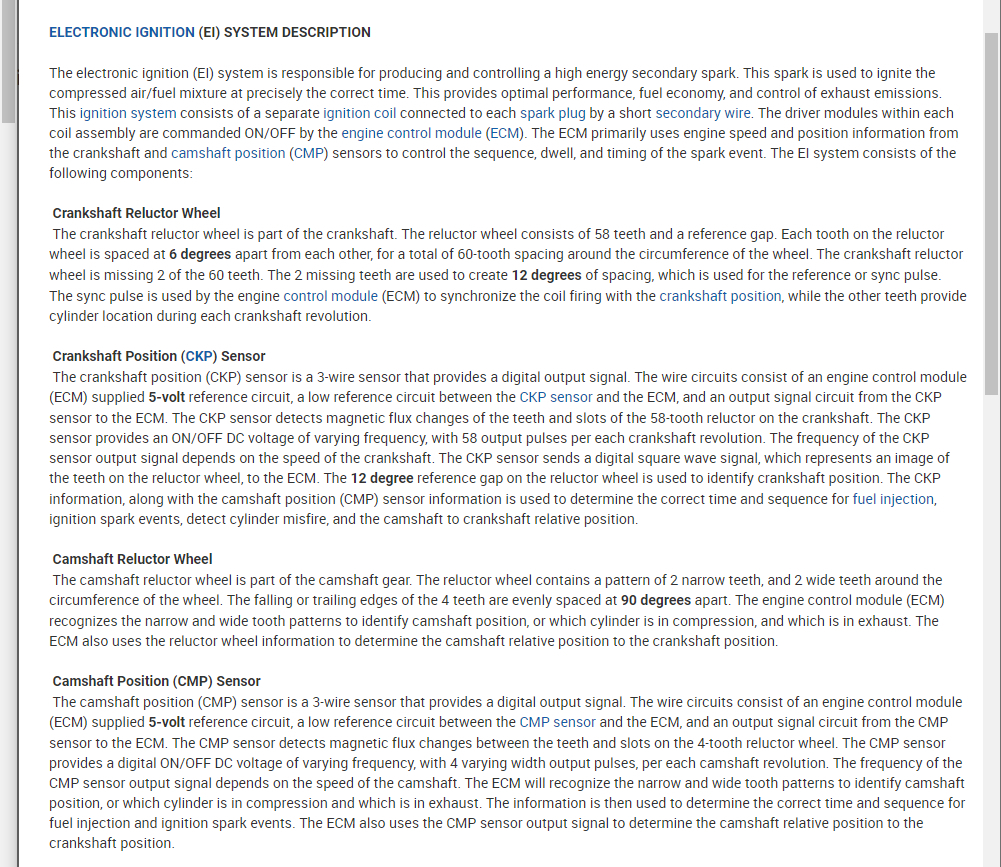

If you don't hear the fuel pump and you don't have spark then we could have an issue with the crank sensor.

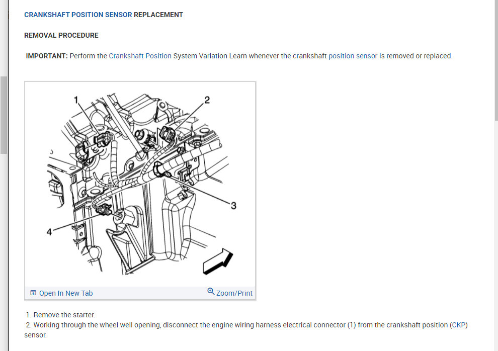

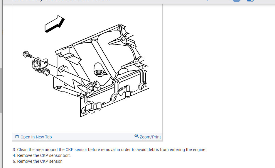

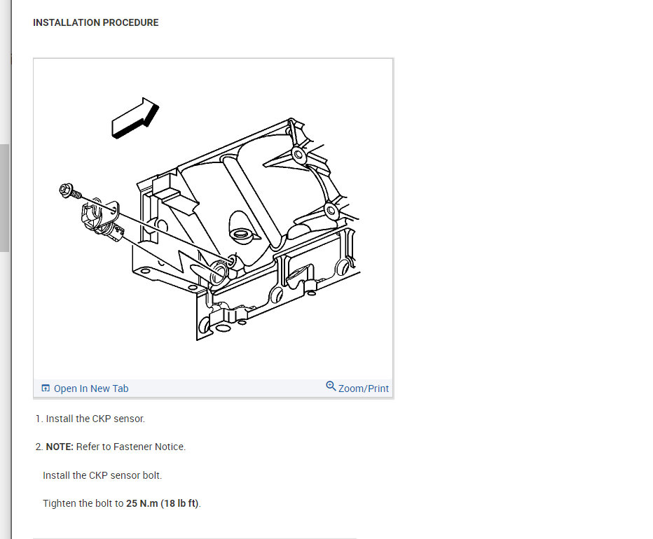

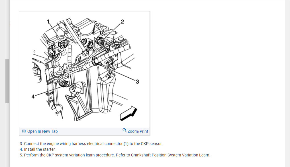

I am attaching the info below from the manual on how this works but if you are not getting fuel or spark then the crank sensor would be the first place I would look.
Let me know about this info and we can go from there. Thanks

You need to do a crank shaft relearn or the engine will not start up
P0315 — Crankshaft Position System Variation Not Learned
You will need a scanner for this. I know this happens sometimes when changing the crankshaft sensor.
