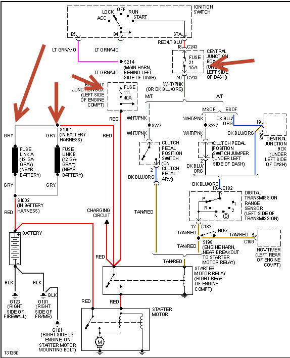

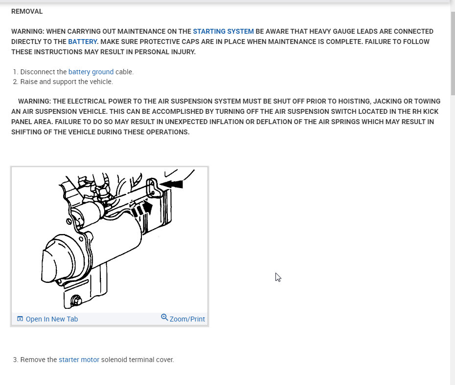

HMAC300
  • 48,601 POSTS
Check battery for condition and load test. Auto parts can do this for free. Then check items in pic then see if starter gets same voltage as battery with voltmeter.
Sunday, May 30th, 2021 AT 3:46 PM (Merged)

Truck will not start. Starter does not engage. Solenoid is not working. I put a volt meter on the small wire to the solenoid, and do not get any voltage there when the starter switch is engaged. With head lights on, they do not dim when the starter switch is engaged.
RACEFAN966
  • 5,029 POSTS
OK so it isn't to much trouble then disconnect the battery and then pull the starter and have it tested so you know weather or not it is good. Let me know how it goes as it could be the ignition switch. Also check fuse 111 in the under hood fuse box it should be 40 amp. Also check the fuse 21 in the fuse box inside the cab. This could be the nuetral safety switch too. So if the start is good and the fuses are good then you will need a digital multi meter.
this guide will help

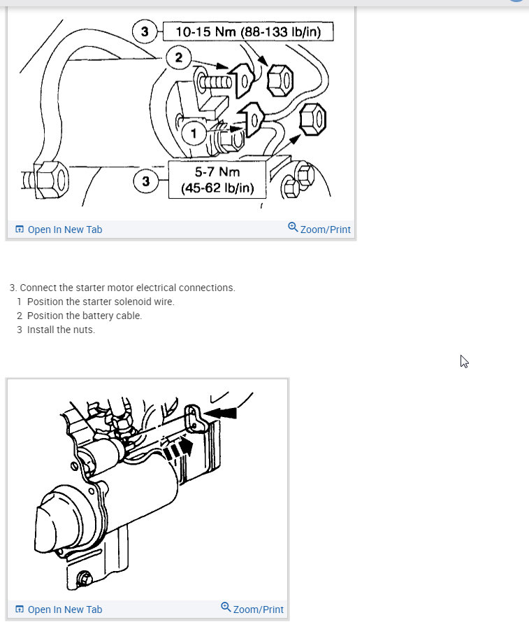

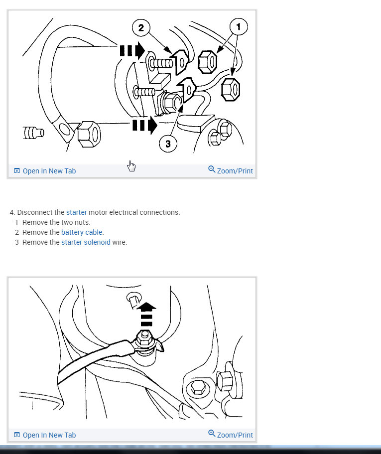

When the starter clicks but doesn't turn over it is normally the starter has failed.
Here is a guide that goes into a little more detail:
There are some other possible causes but the vast majority of the time it is the starter. As long as the battery is charged properly, I would go ahead and replace the starter.
