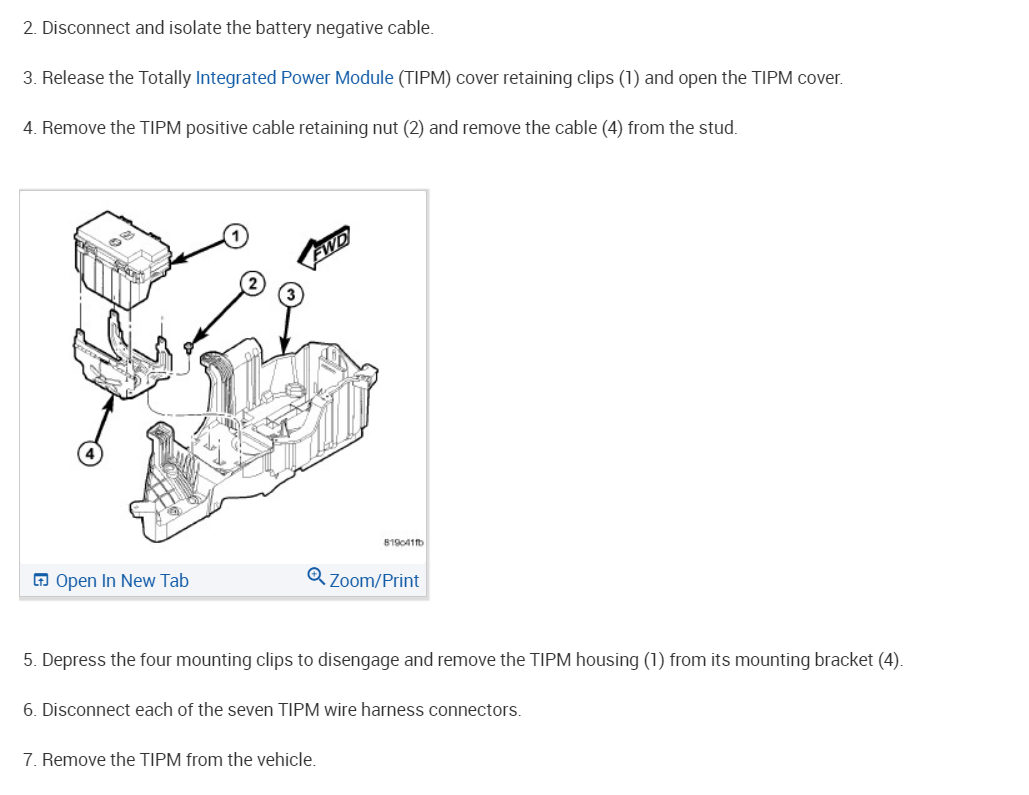

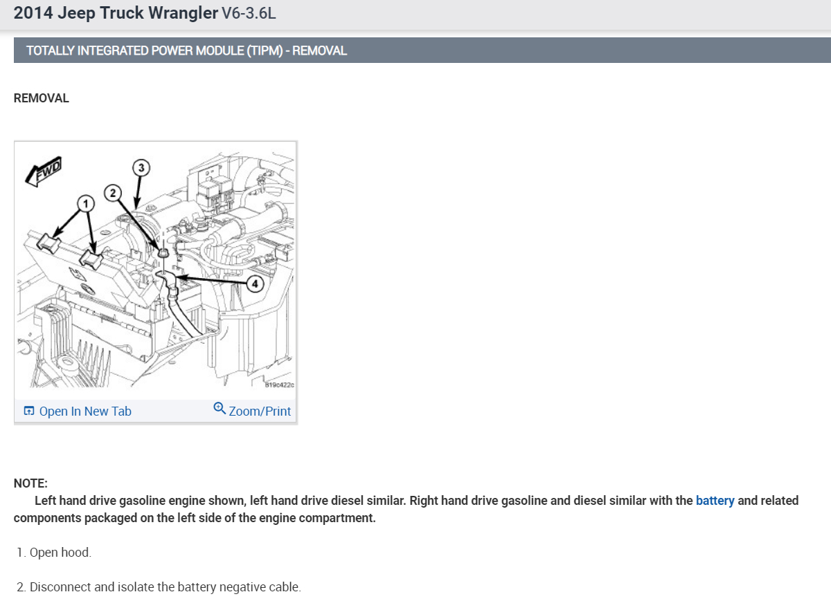

When you say scan do you mean a CAN scan? Which is what I would recommend. You can get a CAN scanner (Controller Area Network) from Amazon.
https://youtu.be/u-4syLc-ifQ
and
Here is one for about $99.00 if you need it:
https://amzn.to/3ZixY4v

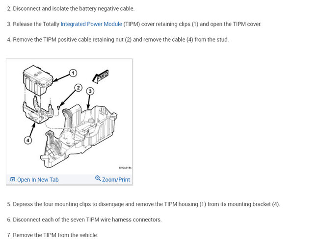

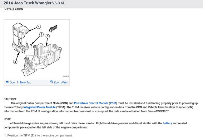

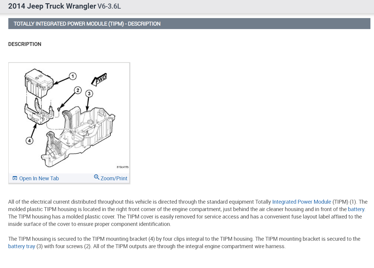

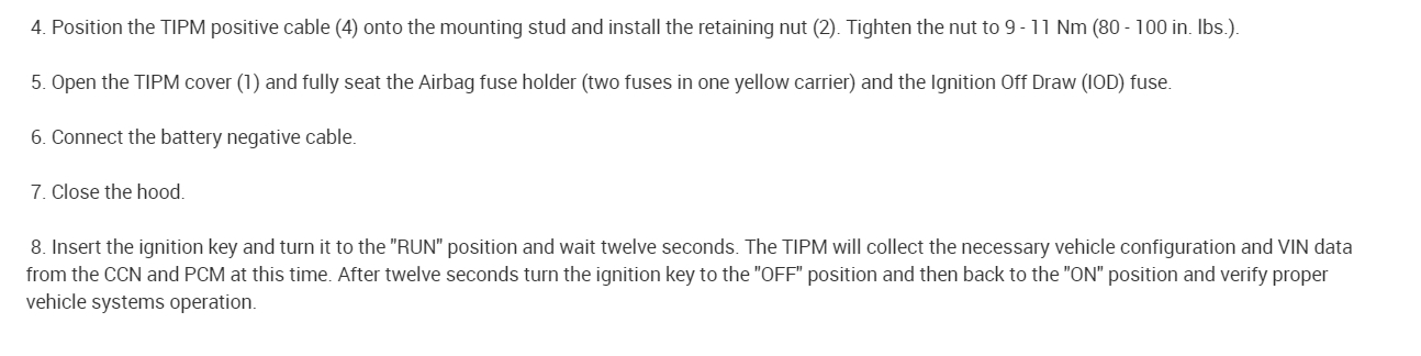

It sounds like the TIPM module is out which a CAN scan can confirm which is common on these cars. It is easy to replace because it-self learns, and no programming is required. Here is the location and how to change it out in case you need it. Check out the images (below). Please let us know if you need anything else to get the problem fixed.

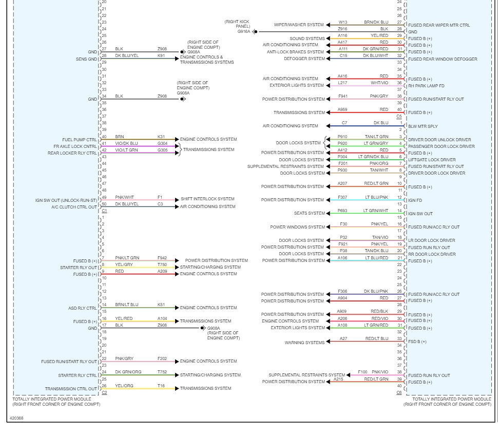

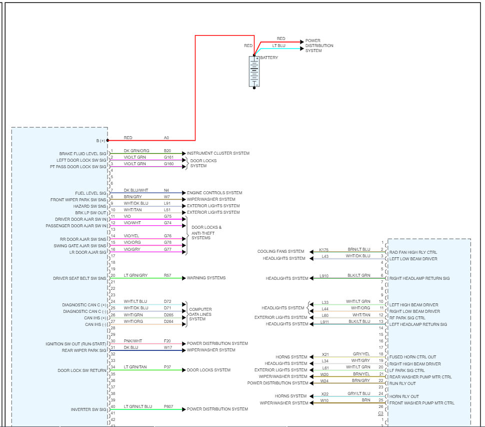

Yep, I like your style, I do believe the TIPM is out looking at the codes that are begin outputted. Unfortunately testing the TIPM is difficult especially when the problem is intermittent. I can tell you they had big problem with the TIPM, and they go out frequently.
Apr 10, 2023 at 7:19 AM
BEAMZ
  • 34 POSTS
I pulled the TIPM and sent it in for diagnosis. It passed all of the tests and is operating as expected.

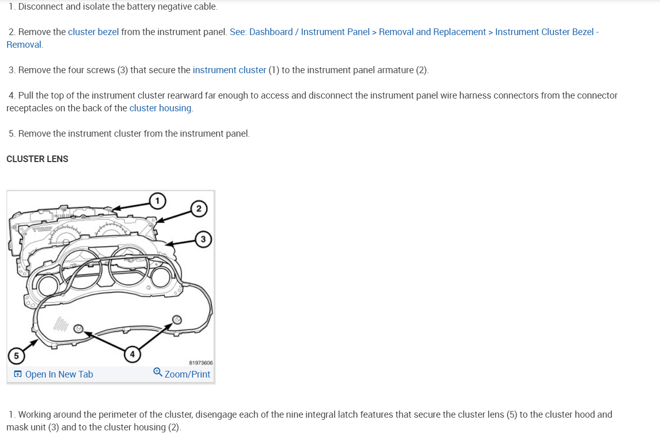

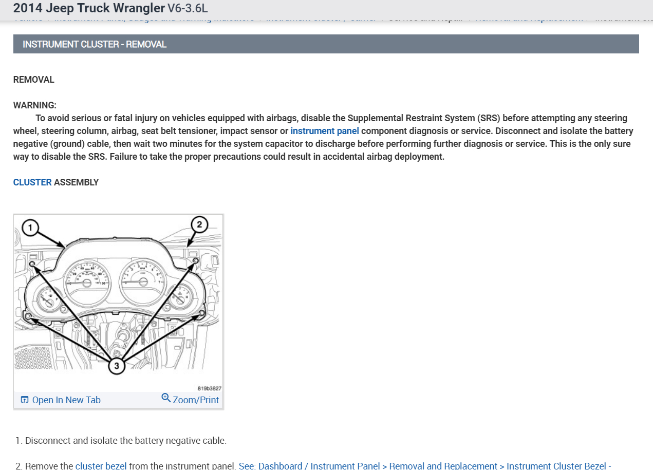

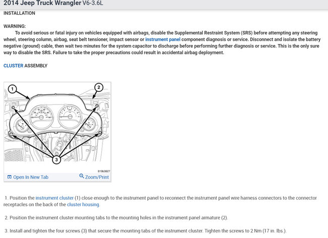

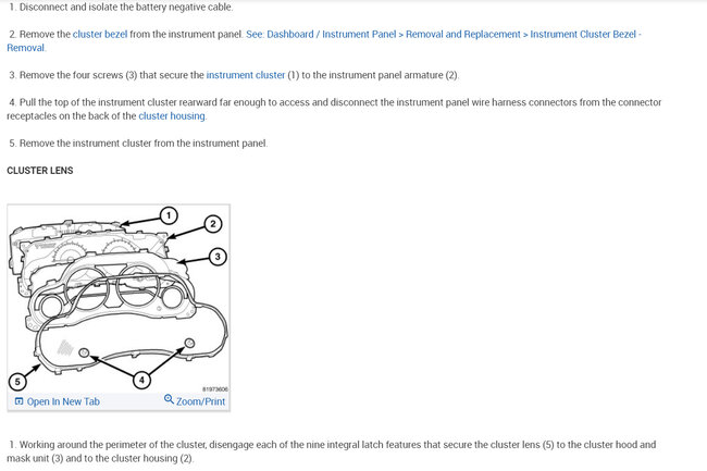

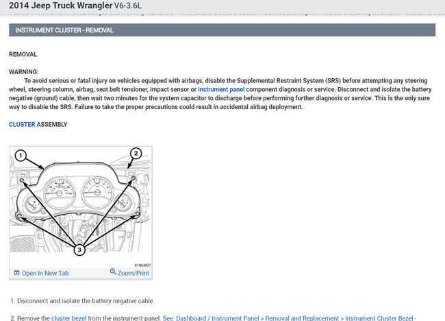

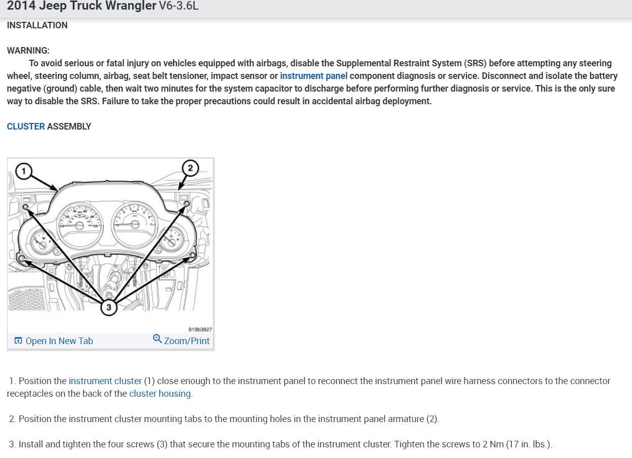

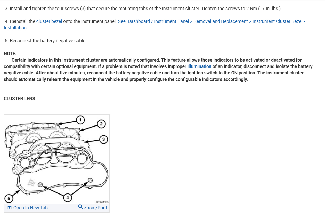

The next part I would have tested is the instrument cluster. Also have you tested all of the fuses with the system on? Here is how to remove the cluster. Check out the images (below). Please let us know what happens.
Apr 24, 2023 at 4:50 AM
BEAMZ
  • 34 POSTS
I ran the gauge cluster self test and did not get any error messages. What would I look for if I took it out entirely?

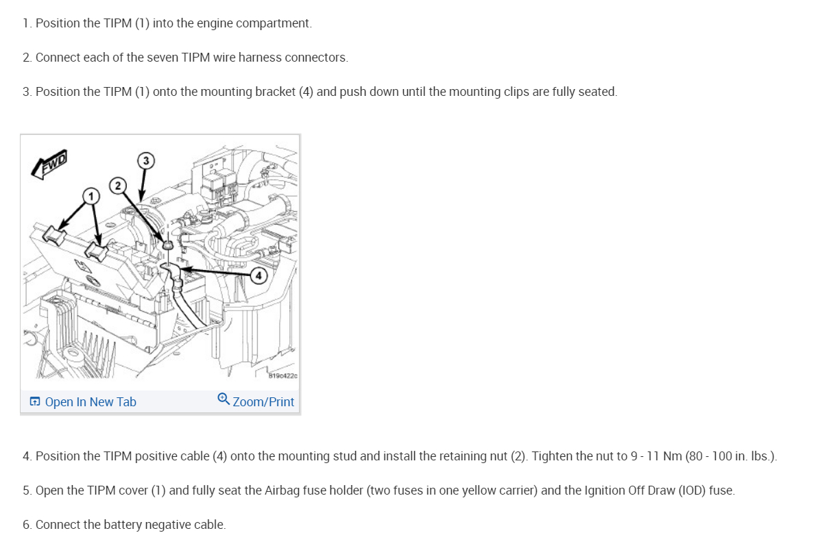

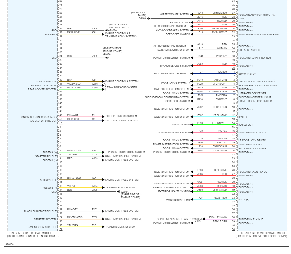

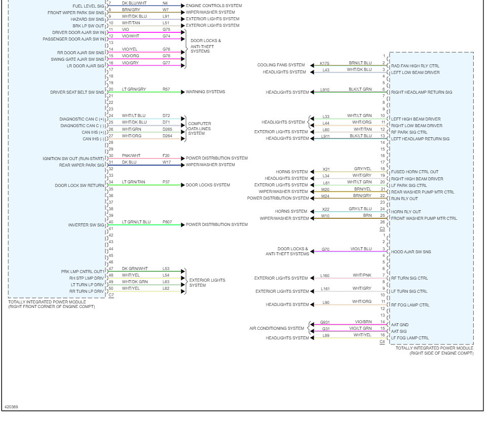

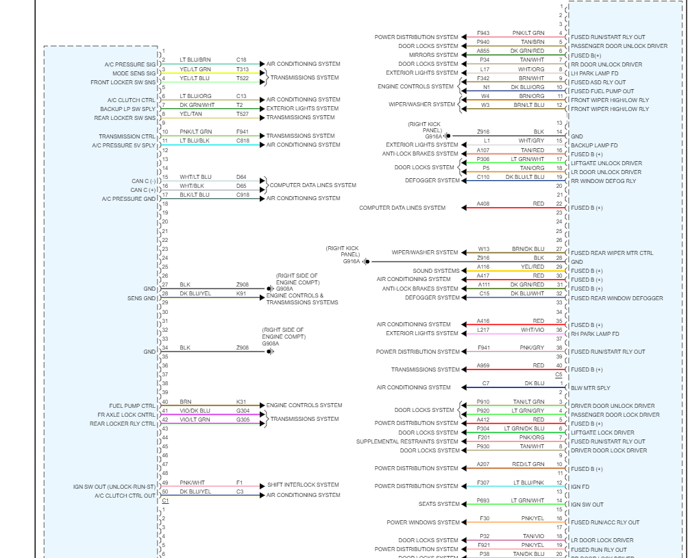

U0141 - Lost communication with IPM (FCM/TIPM) is the concerning code. How was the TIPM tested? It still sounds like it is bad. I would test the power and ground circuits to the TIPM. Here is a guide to help with the test and the TIPM wiring diagrams so you can see which wires are power or ground:

I did have them replace the fuel pump relay as a precaution, and they did a thorough cleaning of the TIPM before sending it back to me. I put it back in 4/30, and the jeep starts right up without any lights on the gauge cluster.

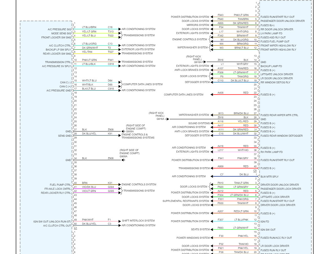

Okay, let's try to narrow this problem down, clean all codes and then without starting the engine turn the system on (key on) and then run the codes (CAN scan). BTW the TIPM is the only thing that supplies power to the other computers and modules.

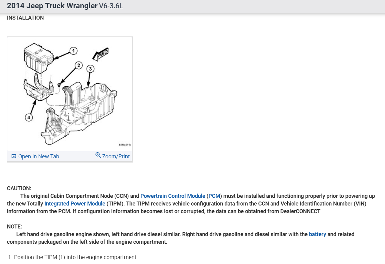

These are tire pressure codes and shouldn't have anything to do with the engine running. How did the jeep run on the drive? I would replace the TIPM with a new unit the problem could be intermittent, and the shop missed it. Also start a new question for the tire monitoring problem.
