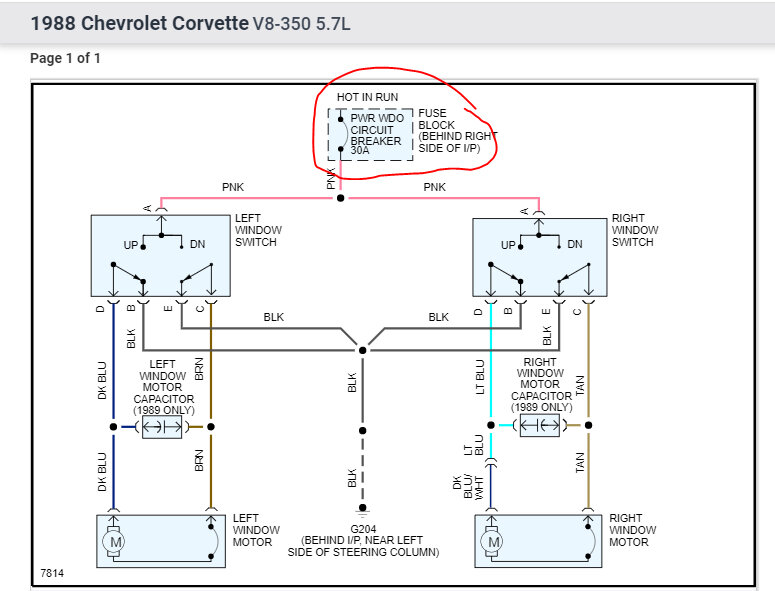

I was pulling the interior door panel to replace a trim piece. I used a screwdriver to pry off a flat plug off the door panel. Goes to windows, locks, etc. I caused an arc. Now the electrical is 100% dead. No starter, no windows, no dash. I have pulled each fuse in the fuse block and all are okay. I have considered a fusible link. I pulled the battery and saw seven different links, but none were visibly damaged.

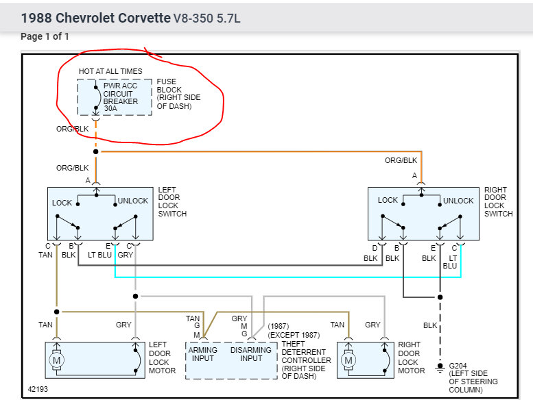

I attached two pics below. One is for the power locks and the other is for the power windows. Both have a 30-amp circuit breaker. However, the power window's circuit breaker only has power when the key was on. I suspect the key was off, so that should eliminate the windows from causing the issue.
On the other hand, the power locks' circuit breaker has power at all times, so that is my first suspect as far as having a short occur.
Let me know if the key was off. Also, let me know if anything electrical is working. If nothing does and the battery is good, check the terminals at the battery and make sure we have a good connection.
