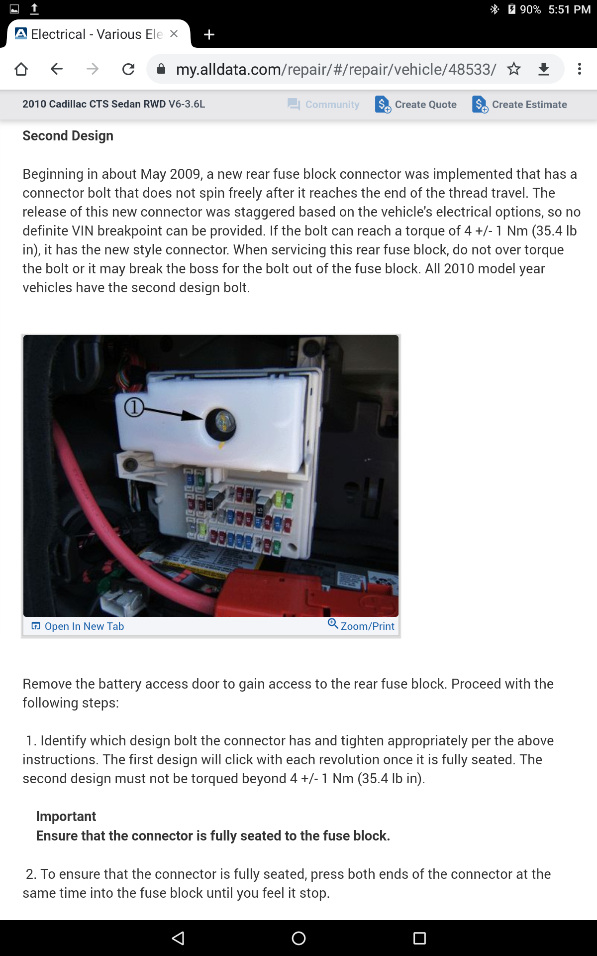

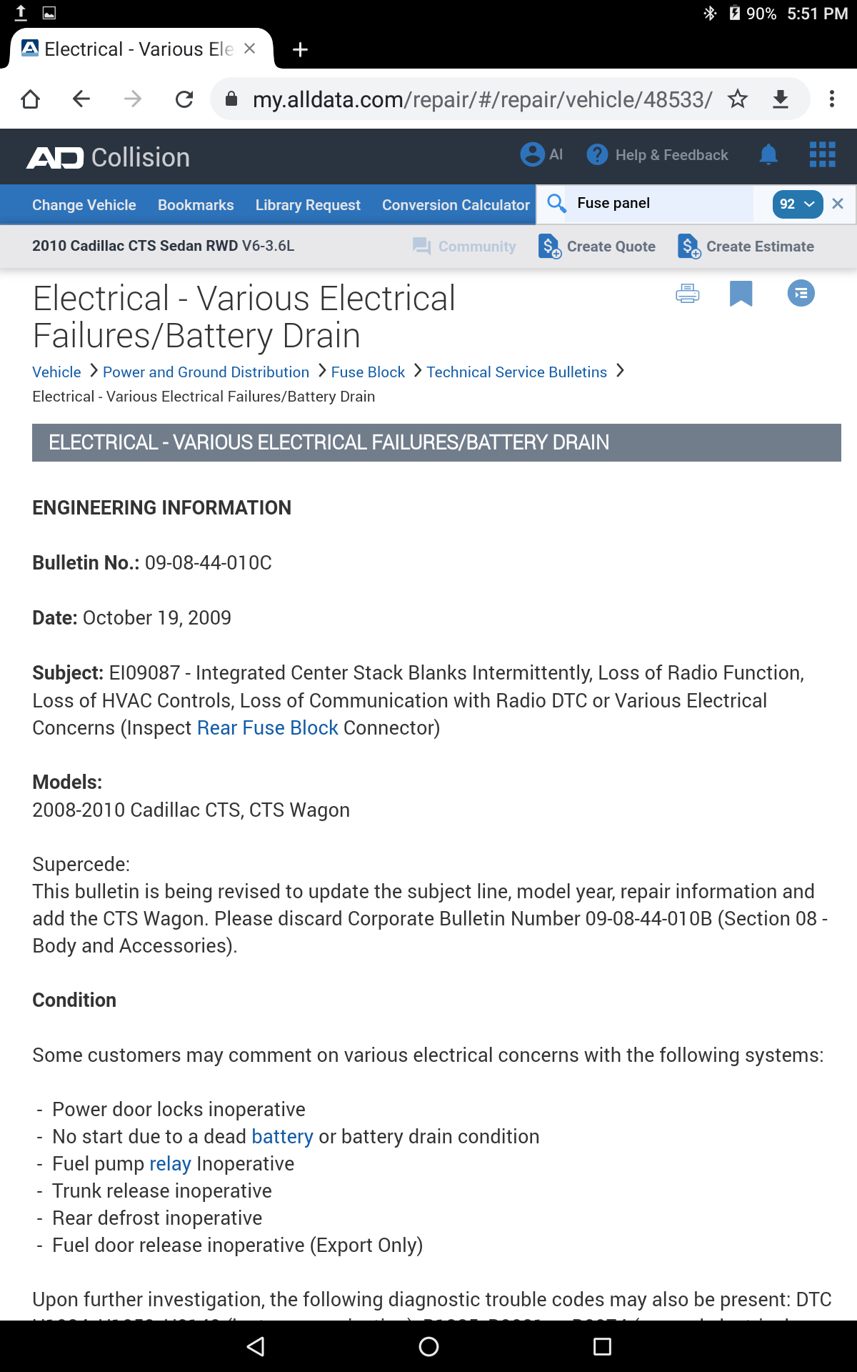

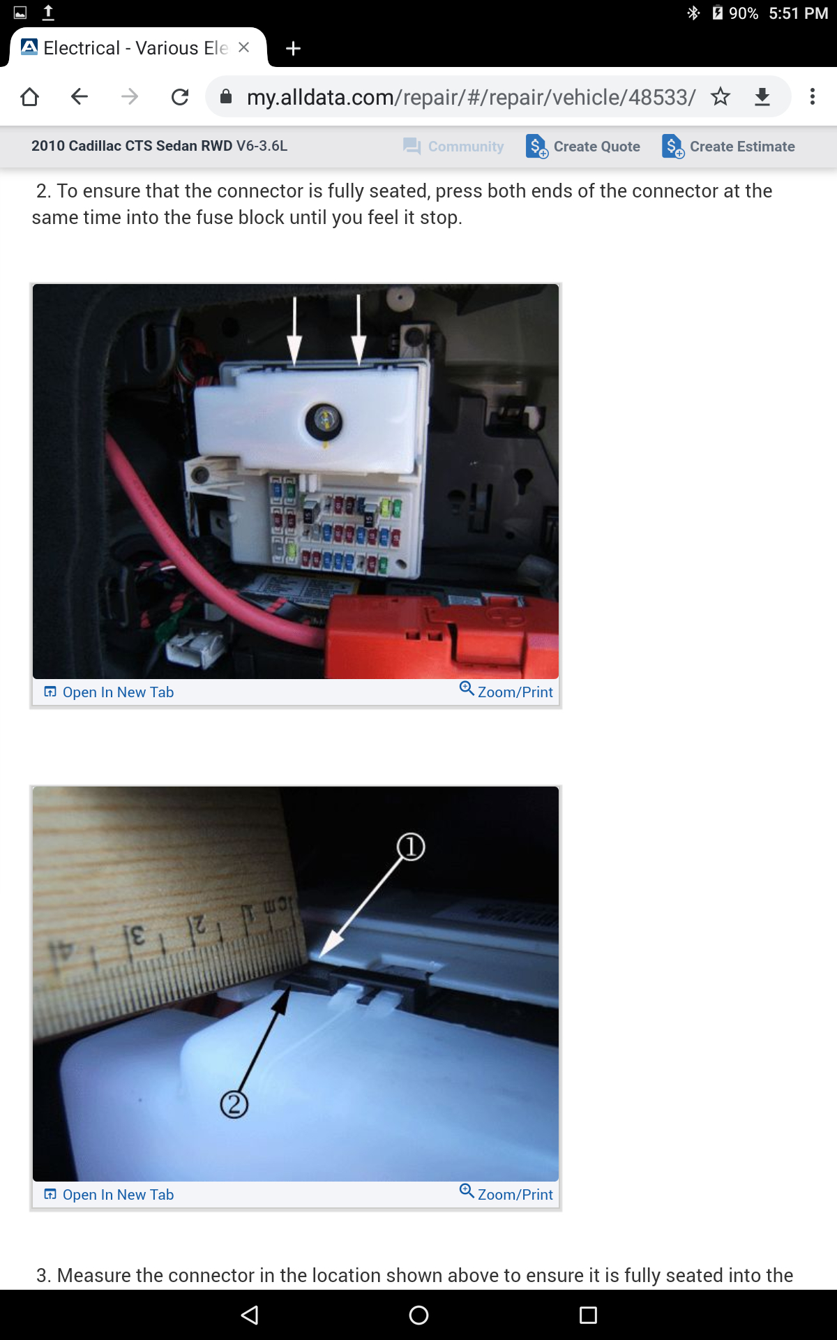

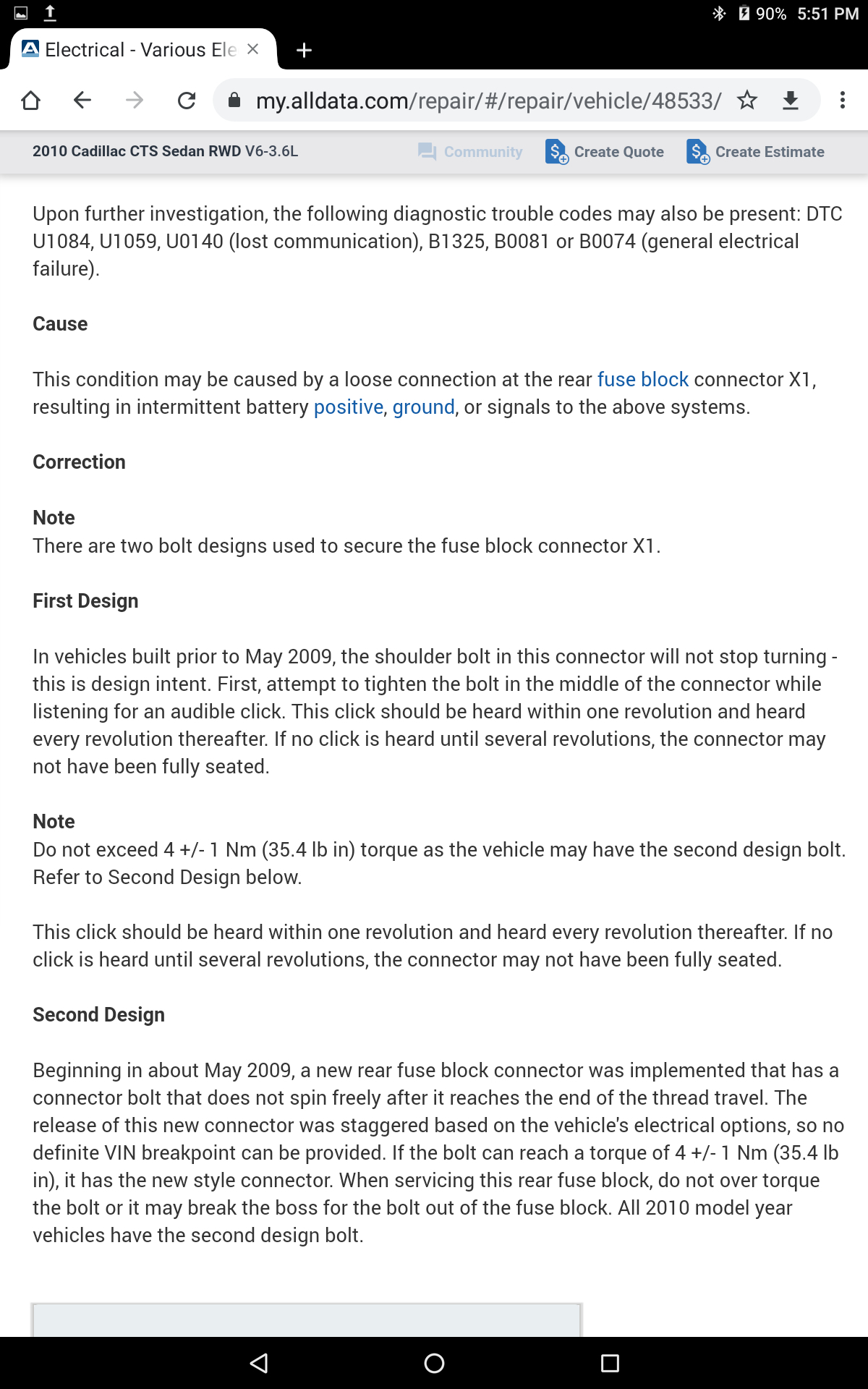

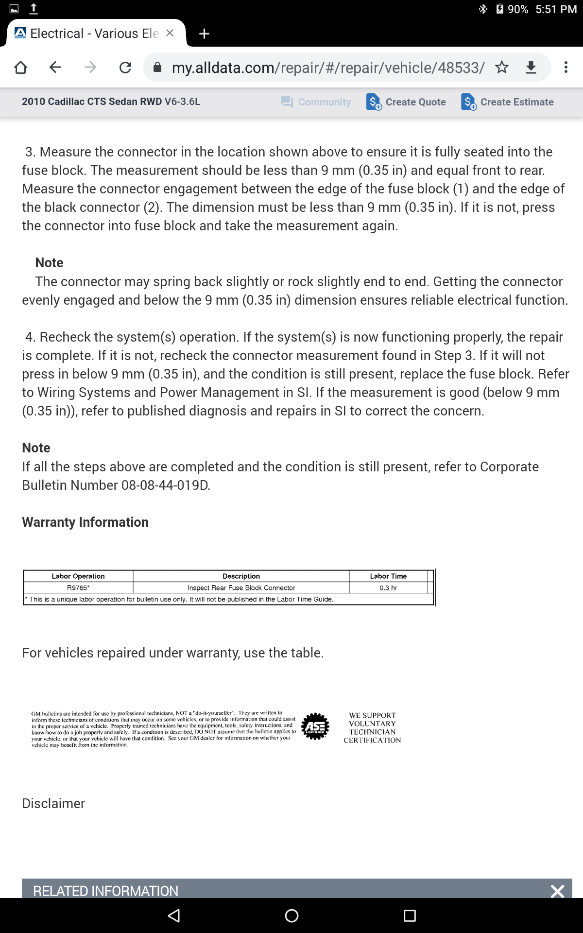

ECM replacement ?
2010 CADILLAC CTS
175,000 MILES • 3.6L • V6 • 2WD • AUTOMATIC
JOE WRIGHT2
  • 81 POSTS

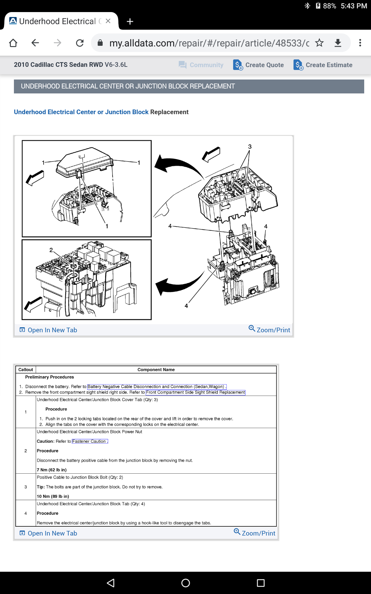

I see the service bulletin, how does it release from the panel?

So i check everything, no corrosion, put it back together, and i had 11.50vdc at 86 to positive, but coil not energized. check in battery compartment, nothing noticeable, except both cable connection were loos, because the guy didn't get them on far enough to be tight. that was a year ago.. After tighten, 86 was 9.4 vdc to positive. put everything back closed hood, turned car around into driveway other direction, let it set for 5 or so minutes.. Got in and started.
Guess what? Now A/C is cooling.. this is what happens on a daily basis. OMG this is crazy!

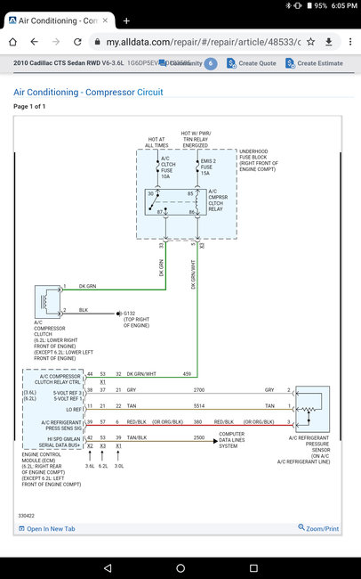

Pin 86, the control wire to the ECM has 9volts on it with the relay out? Ahh I had a thought, the reason you have 9.6 volts on pin 86 with your meter going to positive is the ECM is grounding that circuit. It's just not making a good ground which is why this problem is coming and going. You have a bad ground somewhere. The ECM is unable to fully ground the circuit,, you need to check both batteries and all the grounds on the car. Or you have a corroded ground going to the engine block. Try running some jumper wires from the engine block to the frame and to the housing of the compressor. See what happens. Make sure they're good solid ground connections. Check the exhaust for any melted wires on it as well. Both sides of the engine.

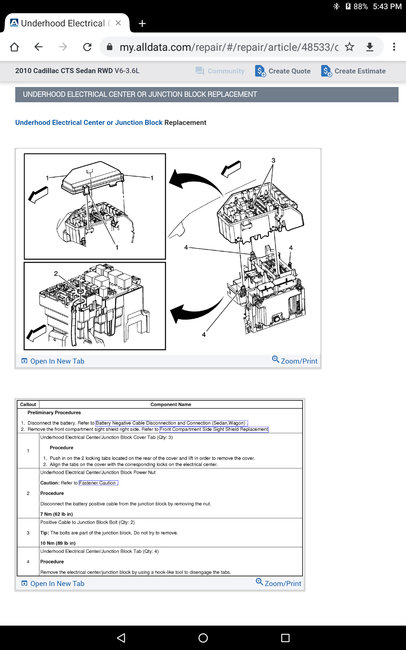

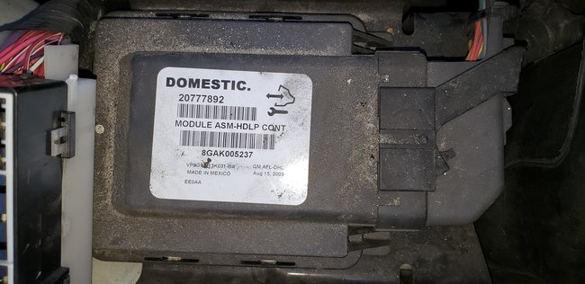

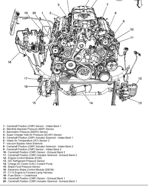

The ECM under the fuse box is for the lights...(chassis ECM).....this is it, in pic....where is the real ECM?
Mar 17, 2021 at 11:50 PM

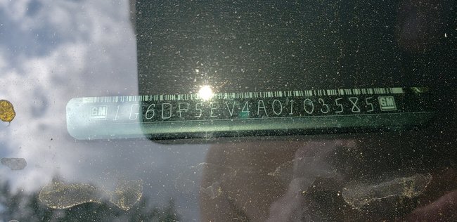

This is the cts sedan rwd , correct? Can you send the VIN number please.
Mar 18, 2021 at 12:26 AM
AL514
  • 5,653 POSTS
Here's a different location than All Data:
Mar 18, 2021 at 12:54 AM
JOE WRIGHT2
  • 81 POSTS
Sure, Premium loaded with almost everything, no backup camera.

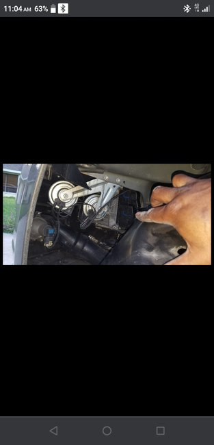

Here's another picture:
Mar 18, 2021 at 1:06 AM
AL514
  • 5,653 POSTS
Check behind driver side headlight. I've looked in 4 different places, for whatever reason these ECMs seem to placed in different locations depending on where the vehicle was manufactured. Did you try running some ground wires from the frame to the engine block? This would tell you if there's a bad ground between the two.
Mar 18, 2021 at 1:11 AM
JOE WRIGHT2
  • 81 POSTS
What is that a picture of?
Mar 18, 2021 at 1:16 AM
AL514
  • 5,653 POSTS
That's another location for the ECM, down behind the driver side headlights. Looks like he's going through the wheel well. But you should be able to see it from up top on driver side looking down.

No it won't turn the A/C clutch on unless the cars running. There's no reason to. I think you have a bad ground really. Because of the readings you're getting. If you were on the ECM pin that grounds the relay, and on battery positive with your meter, if you think about it, you're reading positive and ground through the ECM. But with only 9.6v, that tells me something is not grounding correctly. You should be reading full battery power in that case because the ECM is giving you ground. Same way it activates the relay. I am a bit concerned about those power pins for the relay being reversed. That's very odd.

You should take the relay out, turn the A/C on and put your meter across pin 86, the ECM pin and battery negative. With the car on. This will voltage drop that ground circuit while it's hot. If you read anything besides very close to 0. There's a ground issue or the ECM driver for that ground is having problems. You're correct though you may have an ac pressure sensor issue. It's a 3 wire sensor on the A/C line. It should have a 5 volt reference, a ground, and the pressure signal wire. But there's so much involved in this HVAC system. The BCM, HVAC control module, inside air temperature sensors, ECM, and the ambient temperature sensor on the front grill near the radiator.

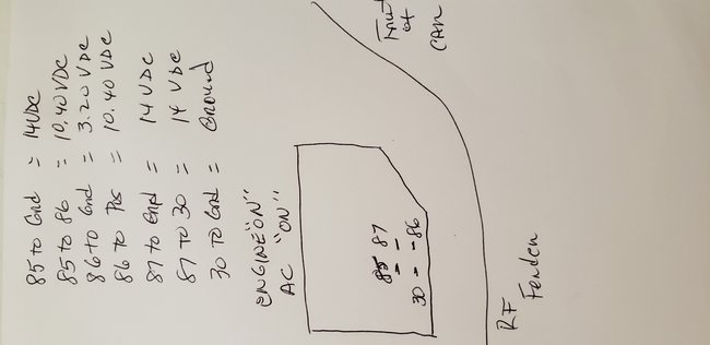

Just asking because relays have a coil in them. What I need you to do is take the relay out and put your meter set on voltage, from pin 86 to a good ground and turn the A/C on so the ECM grounds that pin. Going to battery negative would be best but I know that will be difficult since it's in the trunk. So find a good ground on the frame. It should read close to zero. This is voltage dropping that circuit. We need to know if there's a drop in that circuit while it's active with the key on. Just don't stuff the meter leads in the relay pin, just touch it, you don't want to spread those relay pins.
Mar 18, 2021 at 5:55 AM
JOE WRIGHT2
  • 81 POSTS
I've done all that. the ECM is not grounding all the time, that's the problem.
Mar 18, 2021 at 7:33 AM
AL514
  • 5,653 POSTS

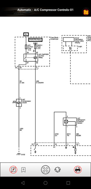

Okay good, nice to have someone who knows what he's doing. Definitely something seriously wrong there. I'm looking at actual Cadillac wiring diagrams now, and I'm still concerned about those pins being backwards. Has anyone done any work to this before? I've looked in 3 different places and pin 30 is where the power should be coming from, not 87. And 86 to ground should be 0volts. I don't know why you're getting reversed voltages like you are. I'm wondering if someone replaced that fuse box and wired it wrong or something. The voltage drop on that control wire is 3.2 volts. Cause the 3.2+10.4 is your battery voltage in full.
Mar 18, 2021 at 8:06 AM
AL514
  • 5,653 POSTS
Can you pull a fan relay and see if pin 30 is battery power on that one? Because all the other relays are the same. The only relay that's different is the Fan S/P relay. But that's getting power from fan relay 1 for different fan speeds.

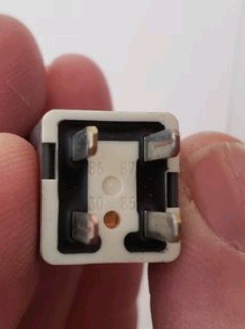

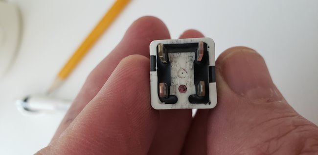

I guess the relay can be a reversed relay, but the voltage drop of 3.2v isn't right. Does the compressor relay have 4 or 5 pins?
Mar 18, 2021 at 9:05 AM
JOE WRIGHT2
  • 81 POSTS
The numbers are on relay not the fuse Box. So if you reverse the relay it would still work, and 87 would be where 30 is. And 85 86 would also reverse etc., then 85 and 86 would be odd.. If there are numbers on the fuse box, i haven't seen any.
Mar 18, 2021 at 9:48 AM
JOE WRIGHT2
  • 81 POSTS
So if the relay is reversed then 30 and 85 move to the hot(30) and switched hot(85).
Mar 18, 2021 at 9:58 AM
JOE WRIGHT2
  • 81 POSTS
Sorry 30 and 86 not 85.
AL514
  • 5,653 POSTS
Well 85 and 86 can be reversed, the relay would still work. I just think there's got to be a corroded wire or connector causing that 3.2v drop to the ECM. Which is why I think when you're driving you have the ac coming and going. Road and engine vibrations can causing a connection to made then broken. I'd find that dark green/white wire coming out of the fuse box and trace the wire looking for a connection issue. Unless the ECM is having a pin issue. But the voltage drop is the issue. The maximum voltage drop you should have is .050v. I don't see any connections on that wire between the ECM and relay. That's why I was wondering if under the fuse box there was corrosion. If not try tracing the wire.
