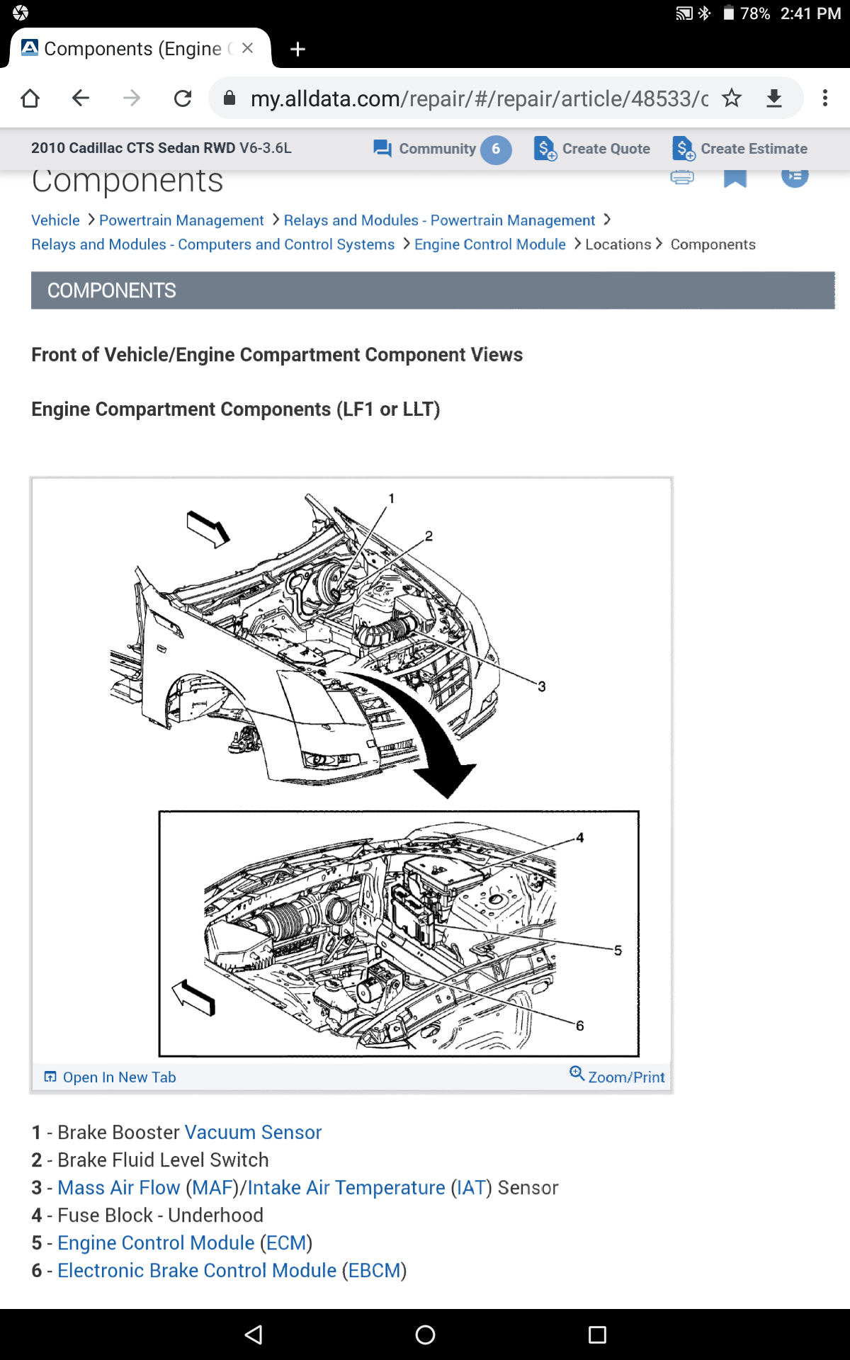

I can’t find the ECM, it is not next to the fuse box, under the hood. your diagram, says that the v-6 is on the left rear engine compartment, but I still don’t see it.. I’m not an idiot, I just can’t find the darn thing.. is it under the air box?

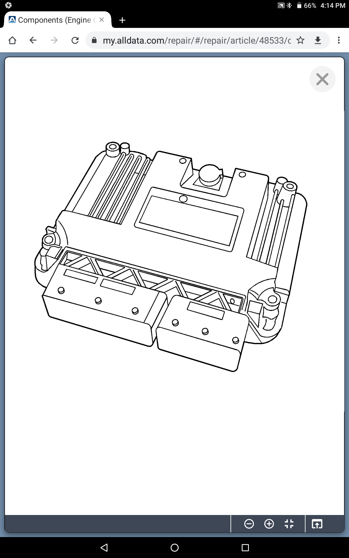

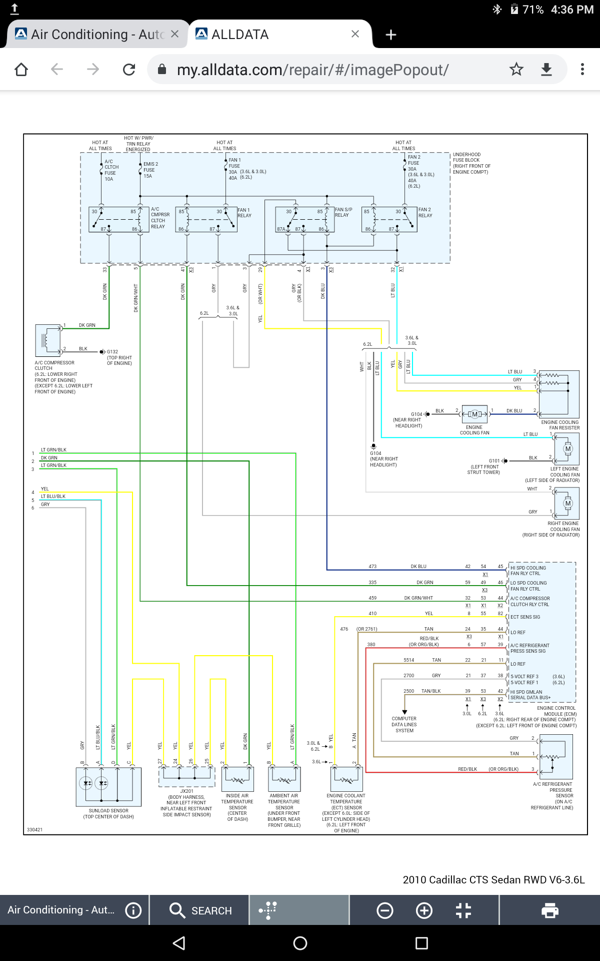

Hello, this is 2010 Cadillac cts sedan 2wd, 3.6liter engine. The ECM is located in the left front of the engine compartment. This diagram should help. Sorry for the 3 diagrams, I'm having trouble erasing 2 of them. But they're all the same.

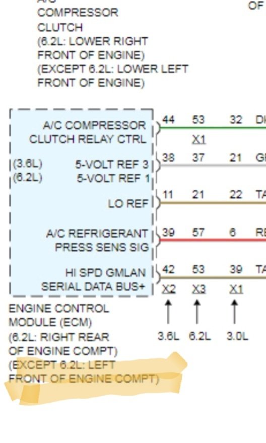

So what does this say that you sent a few days ago, because the ECM is not next to the fuse box. As i have stated several times before. i highlighted the statement from your email.

Is not left front, the drivers side?

If you look at the lower picture, notice the arrow, that's pointing forward on the vehicle. So if you're looking at the engine compartment it will be on your left side (passenger side). It's probably under the fuse block. I understand your frustration, we go through the same thing trying to find modules some times. Try following the wire harness, that might help as well. Is there something wrong with the ECM?

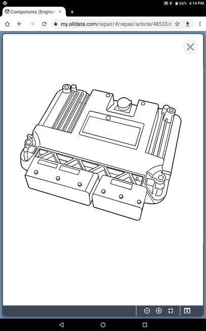

Here is a picture of the ECM:
Mar 17, 2021 at 6:19 AM

Okay, I see what's going on, you're saying that pin 86 isn't going to ground. That's the pin the ECM grounds to engage the A/C relay. I'm just catching up on what's going on. So you are reading 3v on pin 86?

If you're reading 3v and using the battery as ground, then you're reading voltage drop on that circuit. I see pin 44 dark green/white wire is the ECM pin for the relay. So I'm assuming you're trying to check that pin at the ECM. You're getting only 10volts at pin 85?

Then yes on pin 86, if you're reading 3v, that's voltage drop on the ground circuit to the ECM, or one of the ECM grounds is corroded. The ECM grounds are going to the top right of the engine block. But if you can follow the dark green/white wire from the fuse block and see if you find any contact points where it might have rubbed threw and got corroded inside. But that ECM is in the left front of the engine compartment. Probably under the fuse block. It's got 2 bulk connectors going to it.

Left front facing the car?

That's odd about the pins being backwards. I'm going to check if it's different on another model. But these diagrams are from All Data. It says pin 30 comes from A/C clutch fuse and 87 goes to compressor.

Yes, facing the engine, left front is ECM.

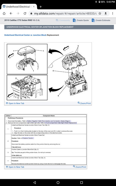

JOE WRIGHT2
  • 81 POSTS
Help. I’ve loosened the two screws and 5 plastic tabs, but the rear of the fuse box won’t release.
Mar 17, 2021 at 7:39 AM
AL514
  • 5,654 POSTS

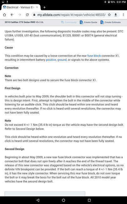

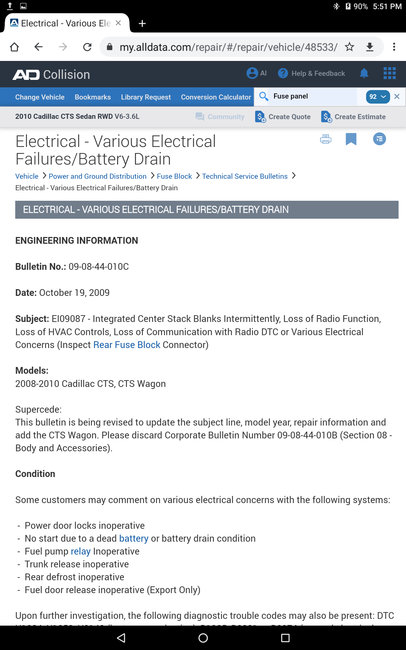

Here's the instructions for pulling the top off. They can be tricky.
Mar 17, 2021 at 7:46 AM

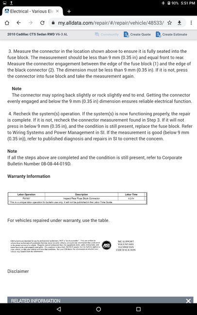

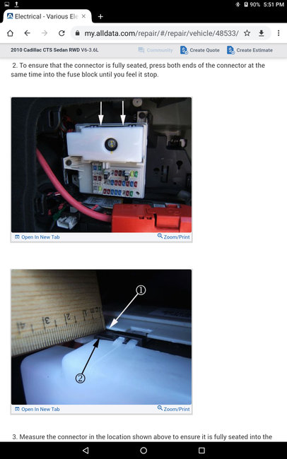

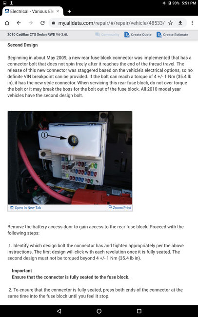

AL514
  • 5,654 POSTS
If you can pull the box up enough just to see underneath, maybe try a mirror. You just need to inspect the connections. Check any engine and body grounds as well. They need to be clean and tight. Here's a technical service bulletin that might help.
Mar 17, 2021 at 7:47 AM

My box has 5 tabs, when i pull up.. the rear of the box is saying no.
Also the connection underneath wants to come with the box, is that normal? The rear connection is staying down, loose from the box.
Mar 17, 2021 at 7:54 AM
AL514
  • 5,654 POSTS
Can you just unbolt the whole box? all you need is look underneath. You don't really need to pull the whole box apart. You should be able to see underneath by unbolting it from the body. In the picture also, there's your ECM.

Does this vehicle have a battery in the back as well?
Mar 17, 2021 at 8:05 AM
JOE WRIGHT2
  • 81 POSTS
Yes, battery in back. I got the box out, back hidden tabs total of 7 fyi.
Mar 17, 2021 at 8:14 AM

I like the service bulletin.
Mar 17, 2021 at 8:21 AM
AL514
  • 5,654 POSTS
There's a bulk connector in back near the battery too. It's behind the trunk inside panel incase you need to check back there too. And yes that's a good service bulletin for this issue.
