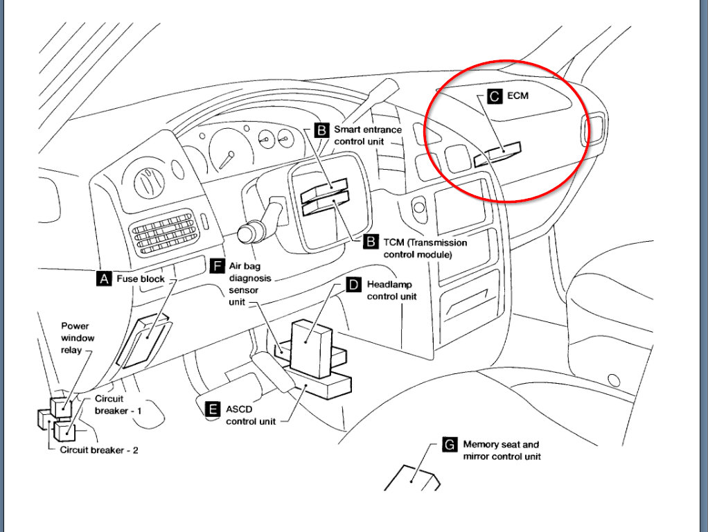

Where is the ECM/ECU located? I cannot find it.
Feb 5, 2017 at 5:46 AM

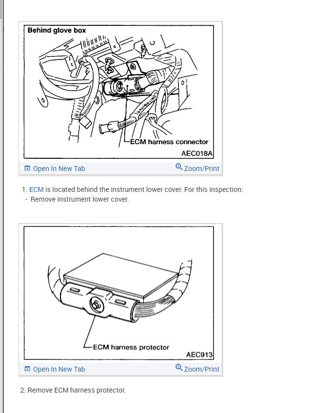

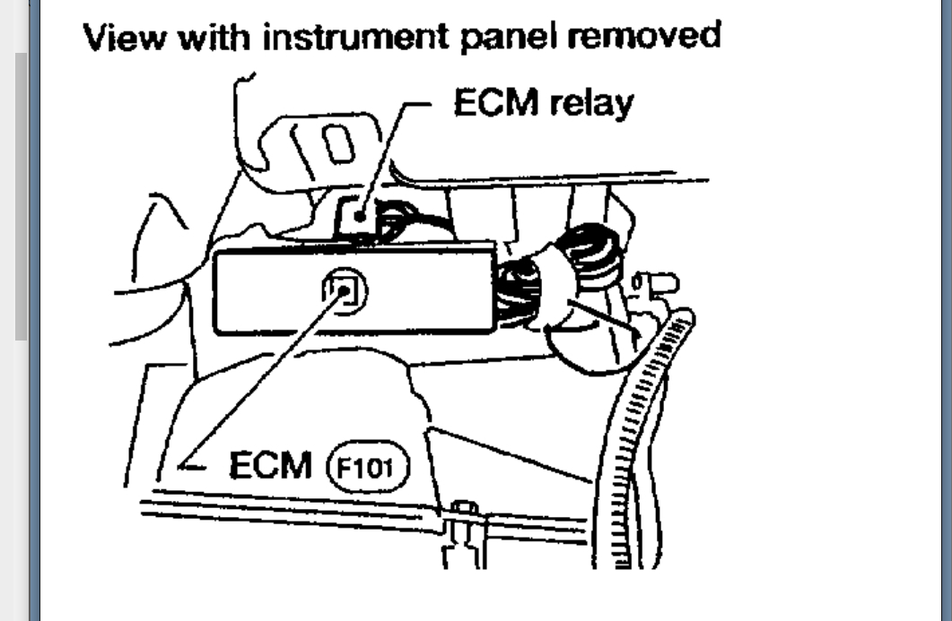

The ECM on this vehicle is located behind the glove box.
Please take a look at the info below on the location of it. Plus the location of the relay and view that you will see when you remove the glove box.

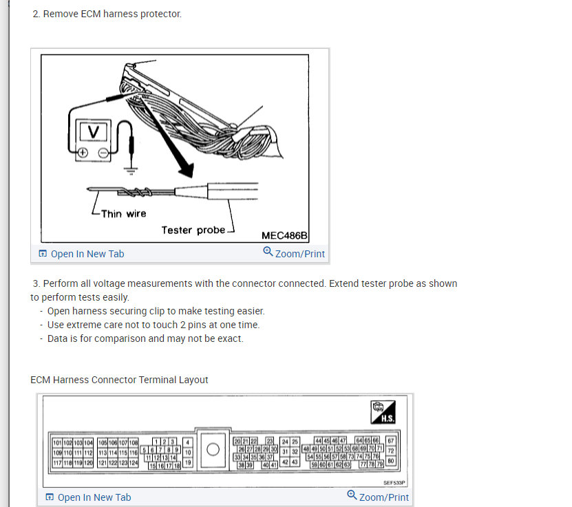

Lastly I included the process to remove and prepare to test the connections and circuits if this is what you need to do. Here is a guide that will help with testing the circuits if that is needed as well:
Please run through all this info and let us know if you have other questions.
