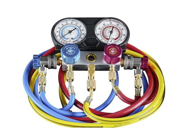

Unfortunately, the can hooked to the low side is not an accurate way to measure system pressure or to refill an Automotive A/C system.
You need either a machine or a set of gauges and a tank of refrigerant. Unfortunately, the refill cans you buy are a gimmick and that's all.

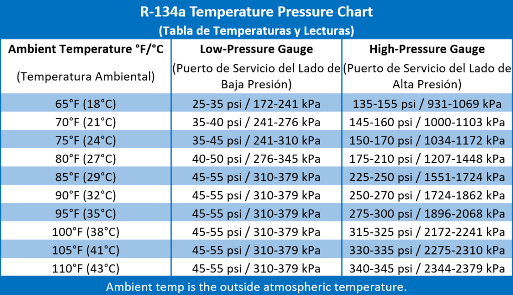

Pressure will drop on the low side as RPM increases and high side will go up in pressure. It also depends on the ambient temperature.
If pressure is too low the system's low pressure switch will turn the compressor off.
In Georgia especially if he is in traffic, the A/C won't work as well because there isn't air moving over the heat exchanger/condenser. The cooling fans should help but they can only do so much.

You can also get a gauge set and check the pressures yourself. I will add an image of them for you.
I am also adding a temperature chart for you. These ranges are approximate values. Keep in mind if you do use gauges to check it, some refrigerant will be lost.

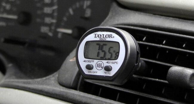

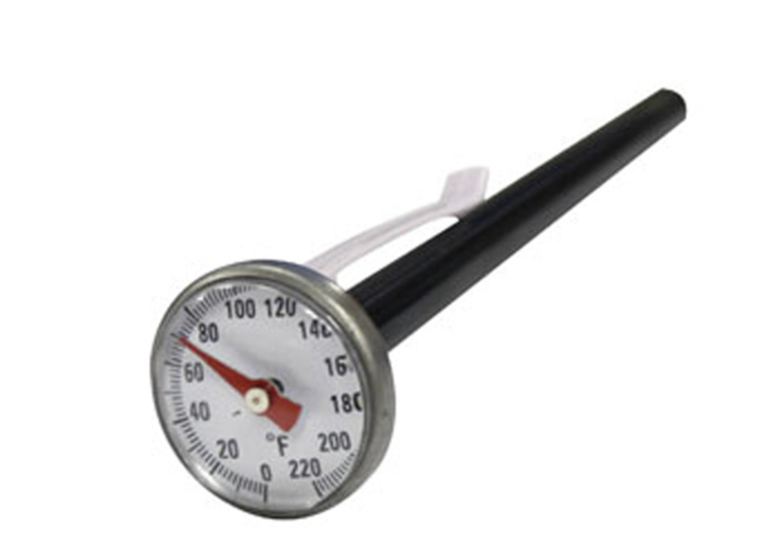

A good accurate way to measure the temp coming from the vents is with a food thermometer or something similar. He could use this to keep an eye on the temperature. They have ones that clip onto the vent as well.
