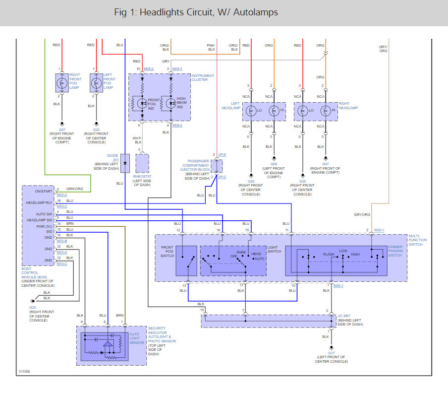

Drivers side high beam not working?
119,550 MILES
RANDOM1
I replaced the bulb. Tested the fuses. Still nothing.
What other trouble shooting steps can I take?
Jan 13, 2023 at 6:48 AM
  • 55,721 POSTS

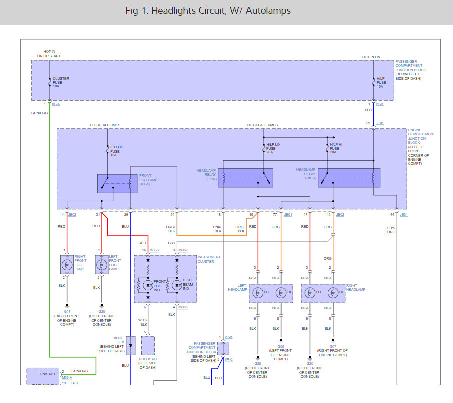

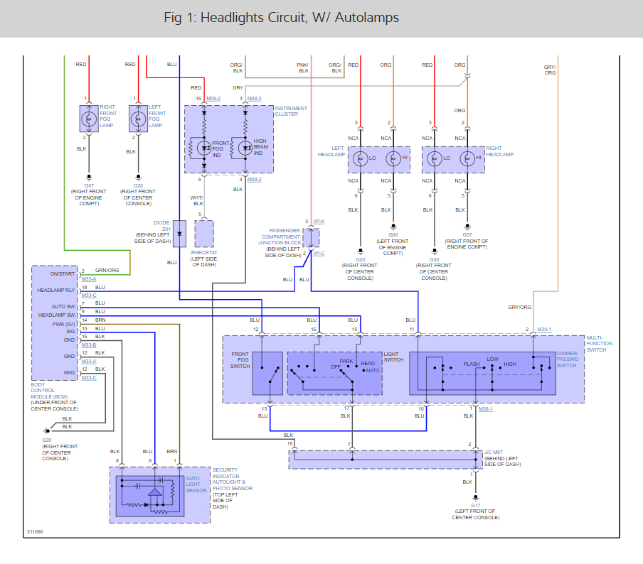

The high beams are connected so it must be a wiring issue or connection. here is guide to help you test the connections and the wiring diagrams so you can see how the system works and which wires to test, you could just run a wire (orange) from one headlight to the other is needed.
Check out the images (below). Let us know what happens and please upload pictures or videos of the problem.
