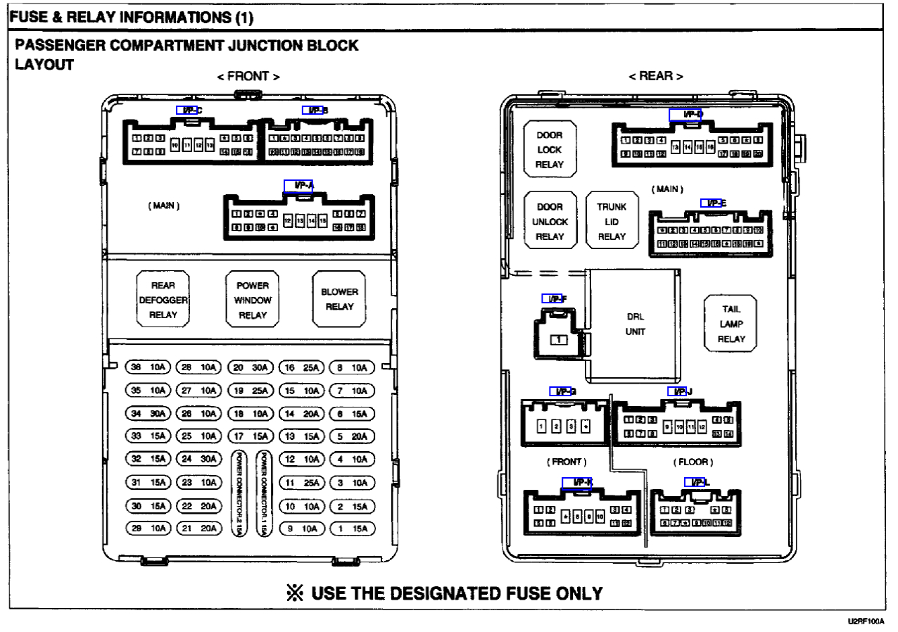

check/change the daylight running lamps relay switch(drl)

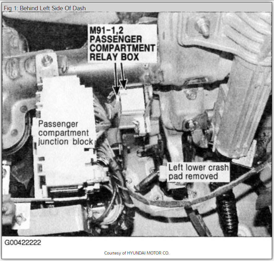

where can i locate the running lamps relay switch?

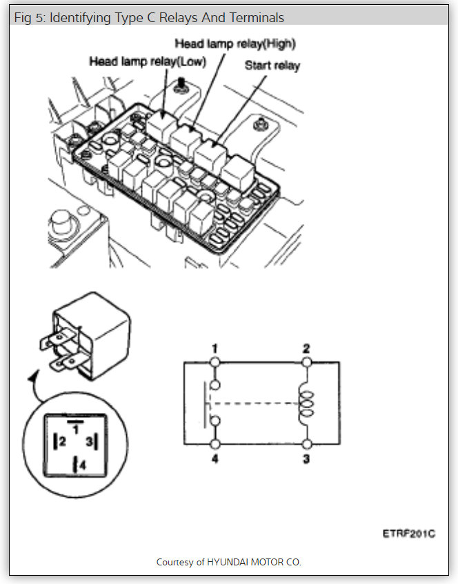

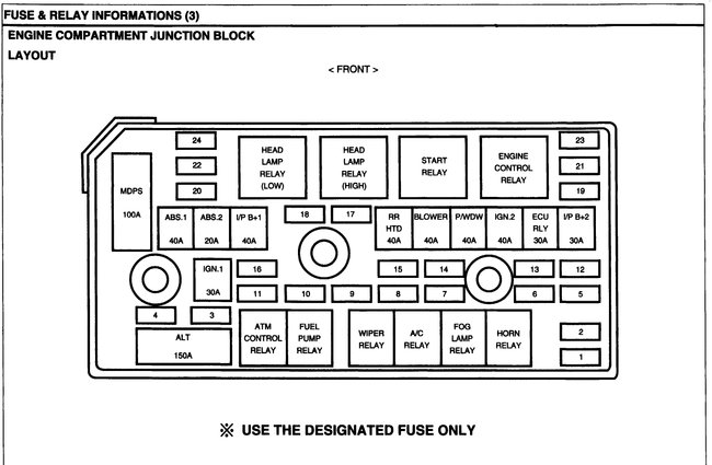

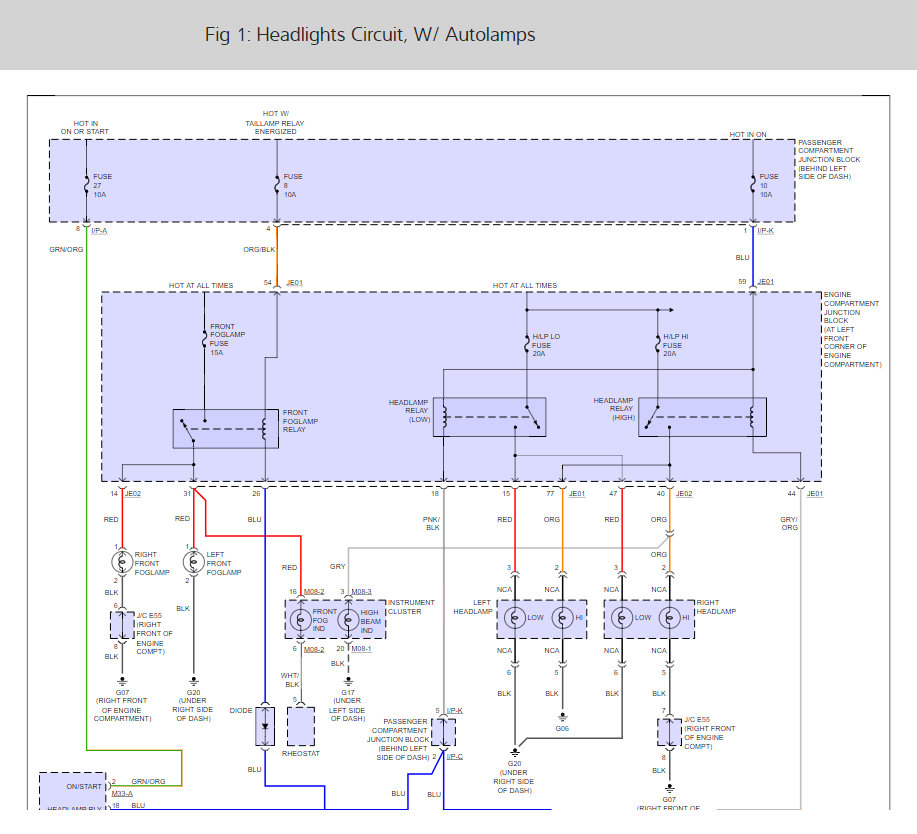

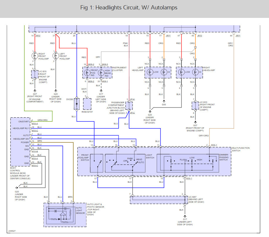

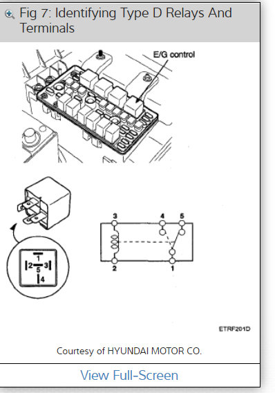

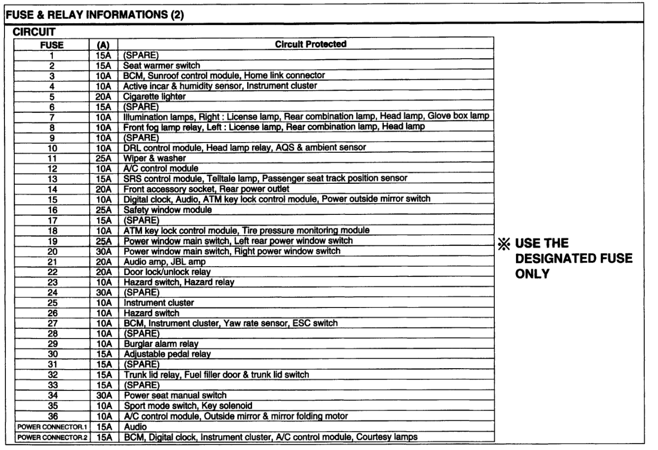

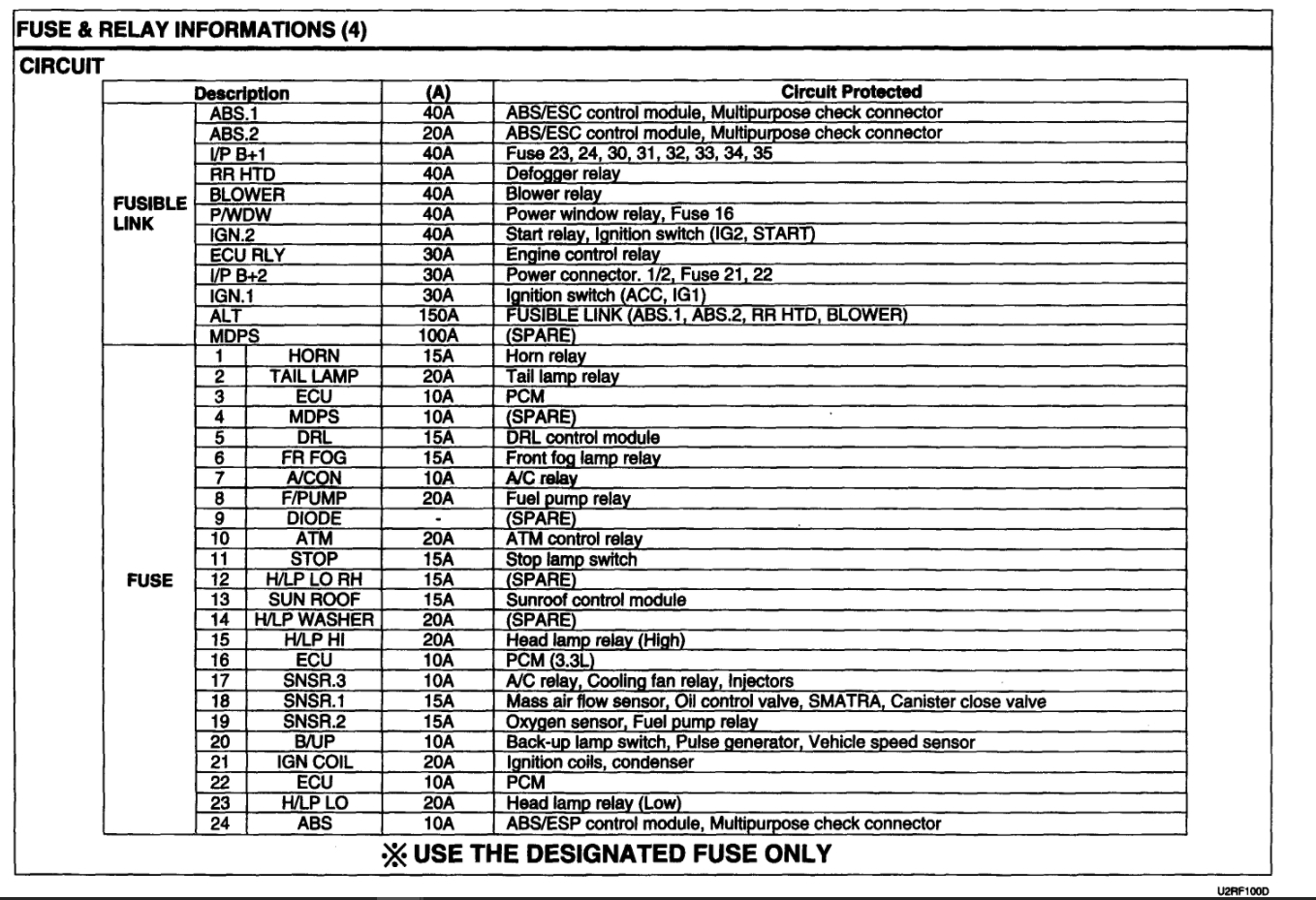

It does sounds like the low headlight relay is sticking on. Here is a guide to help test it.
Here are the headlight wiring and fuse and relay diagrams so you can see how the system works and where to find the fuses and relays. I would try to swap the high and low relays to see if that fixes the problem if it does replace the low headlight relay.
