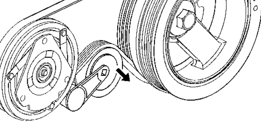

MRMGREENE
  • 14 POSTS
Roy, can you please tell me what the tool is for that comes with this ac compressor belt? https://www.carid.com/acdelco/gm-original-equipment-air-conditioning-compressor-belt.html?relationshipId=1283192578&childId=544539638&gclid=EAIaIQobChMIg6aA_Z-i2gIVy7rACh2KyQXfEAQYAiABEgLeofD_BwE#specifications
Thursday, September 24th, 2020 AT 10:32 AM (Merged)
  • 52,797 POSTS
OK, the tool is only available when you buy the kit. You do not need this.
Attached is a picture of the tensioner. You need a 3/8 ratchet to release the tension.
