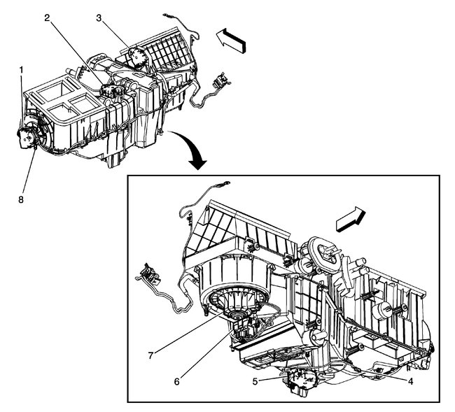

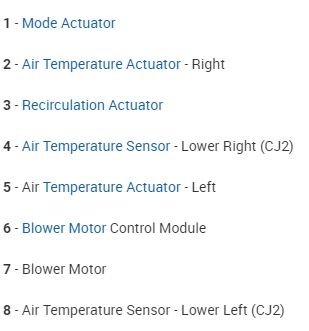

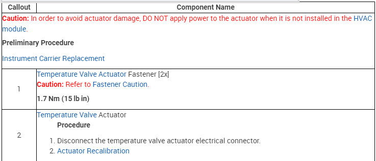

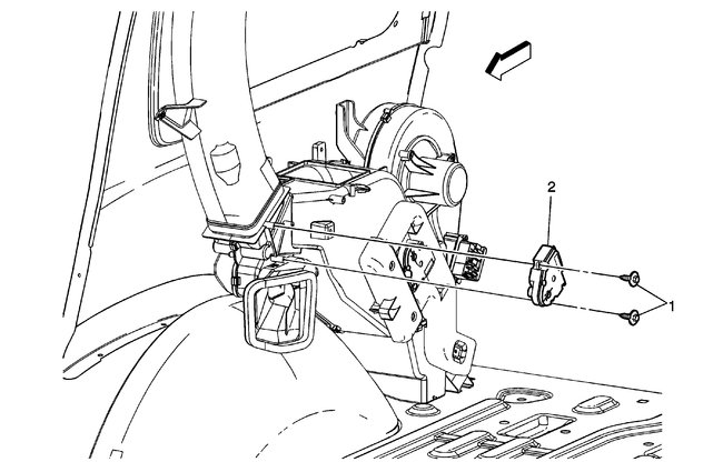

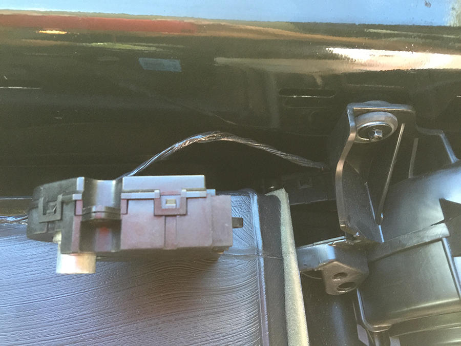

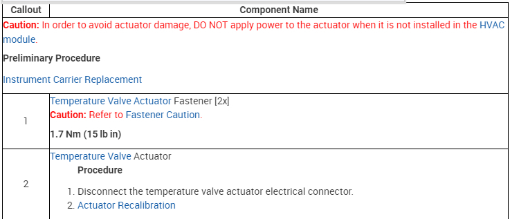

Pictures 1 and 2 show the heater box under the dash and the legend of what each component does. You are looking for component 2 in picture 1. Picture 3 shows the actuator being removed. Picture 4 are directions.

BRYANM4218
I understand this thread is over 6 months old, but I wanted to add my experience in case someone comes across this while in the same predicament.
I have a 2013 Chevrolet Tahoe and the Blend Door Actuator began making a knocking noise. (Once the key was inserted into the ignition and the A/C came on, there would be a loud click/knocking noise coming from the rear A/C located beneath the back side panel on the passengers side of the vehicle.) I was able to remove the plastic coverings and of course, I have the BEHR model, with the Actuators located behind the unit, against the body of the vehicle. I removed the two 7mm bolts that hold both the duct work and blower to the body. I then removed the duct and was able to apply a small amount of force and pull the blower mount slightly away from the body of the vehicle (I did not disconnect blower or clear any lines). At this point I disconnected the plug from the Actuator. To remove the Actuator, I used a Torx bit to remove the 3 screws mounting it to the blower housing. It was tight, but not at all impossible. The top 2 screws can be accessed from the top/left hand side of the unit, the 3rd screw (located on the bottom of the actuator), can be accessed much easier from the bottom near the wheel well where you can actually see the screw. Once I removed the actuator I was able to reconnect the plug and start the vehicle, testing the actuator further to ensure it was truly my problem. I also was able to visually inspect inside the blend door and verify that there was not a break causing the issue.
I hope this helps! I am by no means a "mechanic", simply a guy that doesn't want to pay $1,000.00 for a job that I can do at the house for free! This thread was essentially the only thing I found on the internet related to this model and situation, so thank you all for your help! I did take some photos/video and I will try and upload them as well.

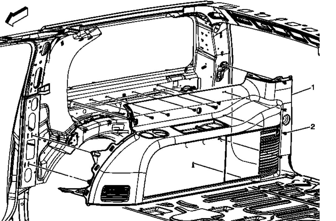

JEFF_WRENCHONIT
The rear HVAC is blowing hot when the AC is on. I had the dealership look at it and was told that the rear hvac temperature door actuator needed to be replaced. I ordered/received the new part and was able to remove the interior trim from the right/rear of the vehicle to access the rear hvac equipment. The actuator however is located BEHIND the hvac equipment. Pretty much between the blower/ductwork and the outside of the vehicle. My question is how do I pull the unit so I can access/replace the actuator??? Do I need to pull the heater lines, and if so, will I lose fluids, etc. and what add'l service will be needed.

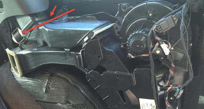

JEFF_WRENCHONIT

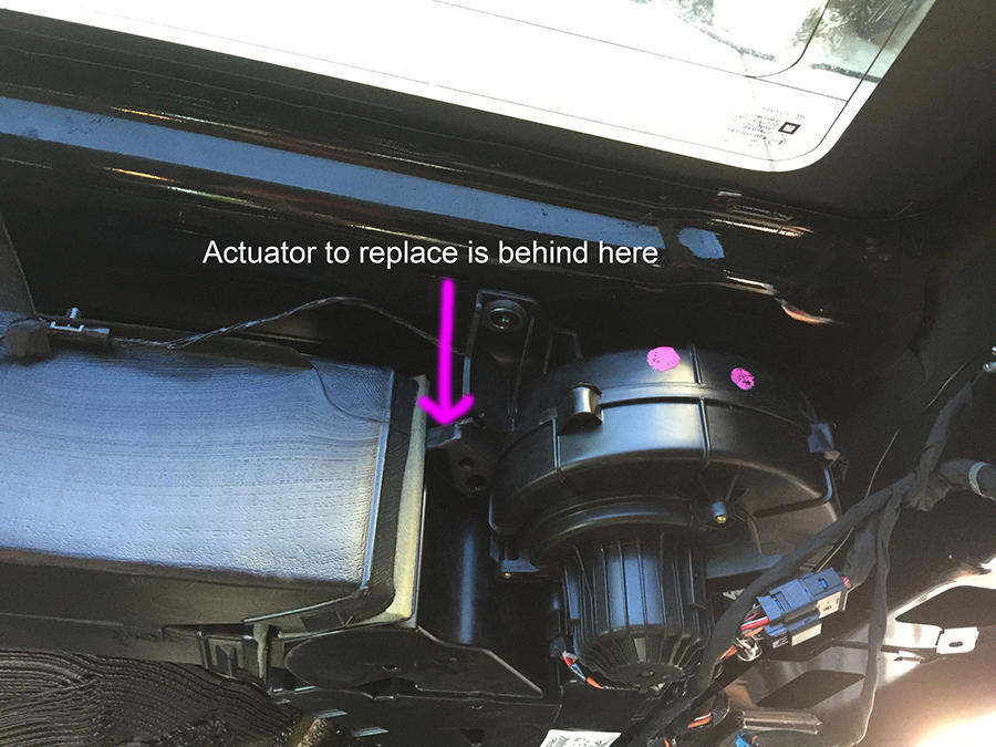

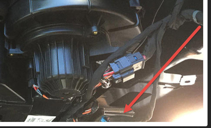

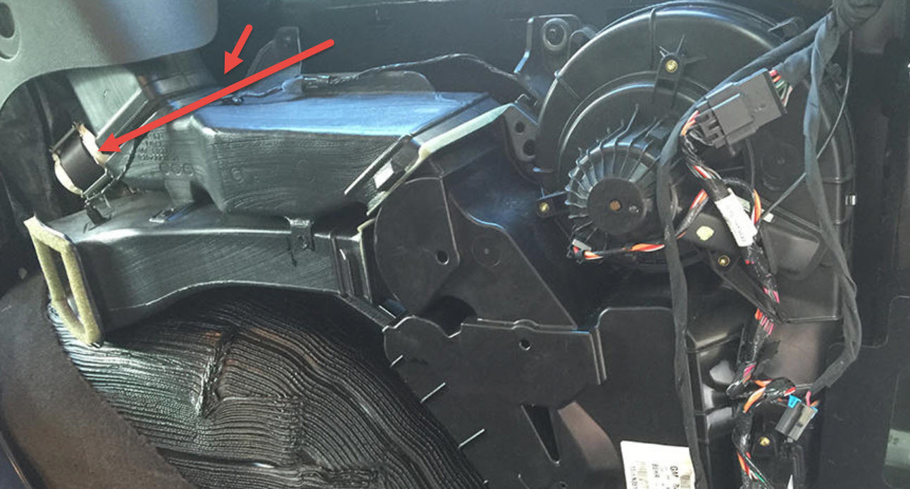

I'm going to try to attach the photo again in this reply. The first thing I did was pull the fuse and try to reset the actuator but no luck. The diagrams you provided show how to pull the interior trim...I already got that off with no problem. The sticking point is accessing the actual actuator which is behind the HVAC unit. Hopefully the attached photo will come through and you can see what I mean. Thanks.

HMAC300
  • 48,601 POSTS

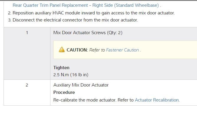

everything that I have in our manual is sowing the temp actuator in first pic and mode in 2nd pic, it says nothing about pulling the HVAC unit off the truck. i have checked 2010-2012 in both GMC and Chevrolet they both show the same setup. I have no further thing to tell you about this. Unless our manual is wrong. if you have to pull the HVAC unit you will have to blow the charge and evacuate and recharge entire system. it 's the same from 2009-2013.
Sep 24, 2020 at 3:32 AM (Merged)
HMAC300
  • 48,601 POSTS
Just rechecking your picture look at where the arrow is in this picture I put in. are you sure that is not the actuator?

Hi Guys, just wanted to let you know that i checked Alldata and got the exact same info that you did. It's on the outside.

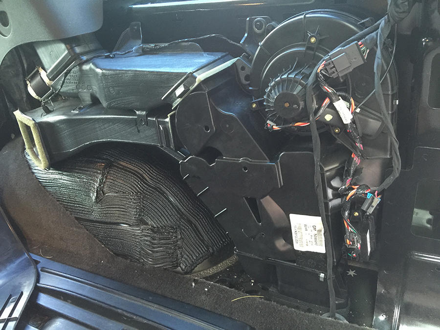

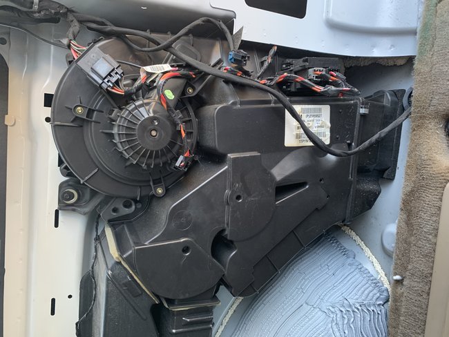

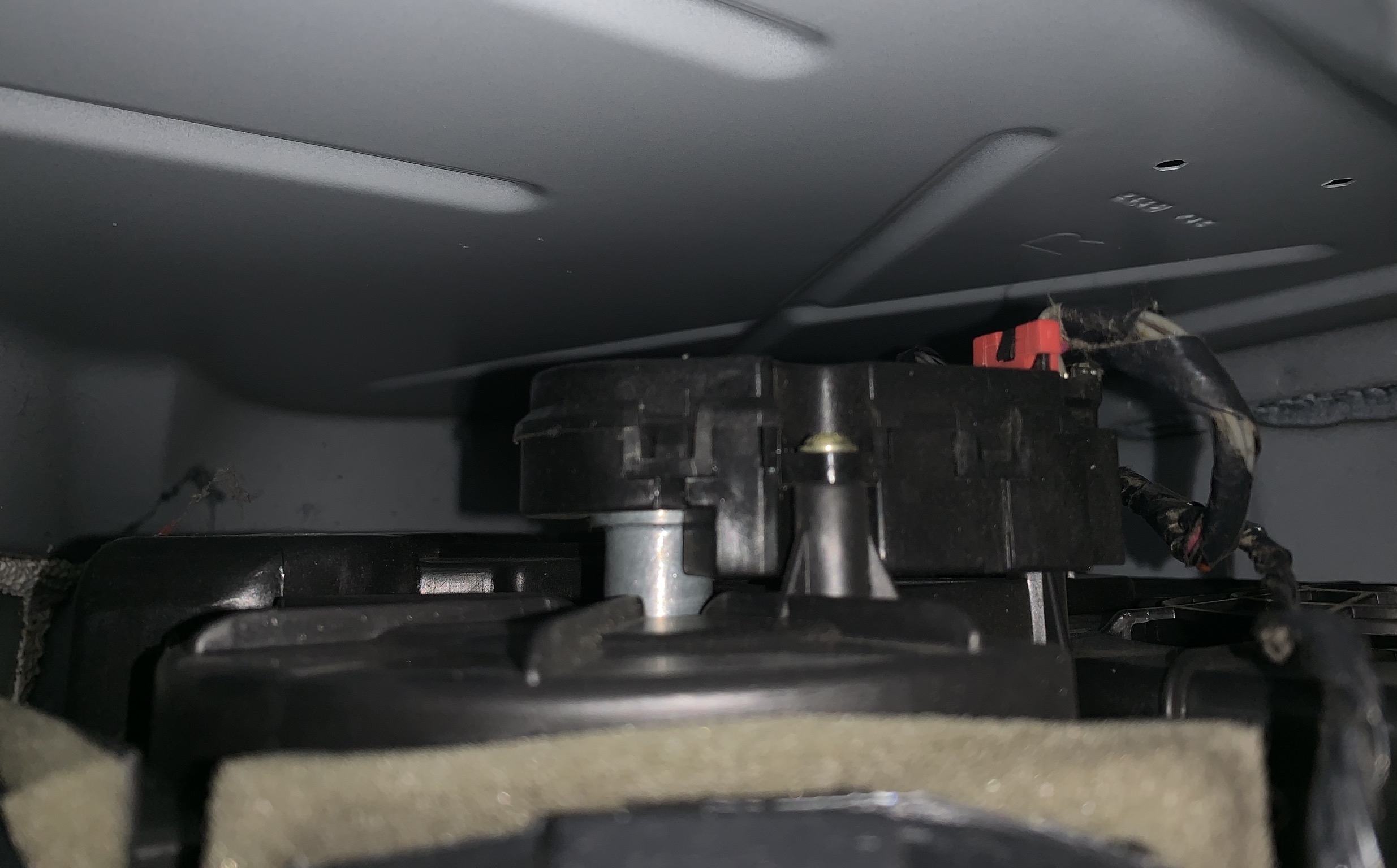

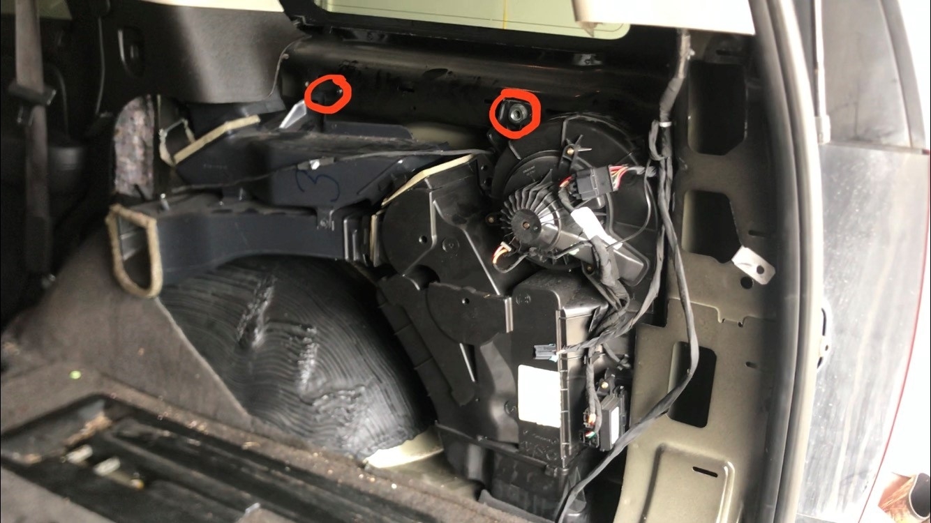

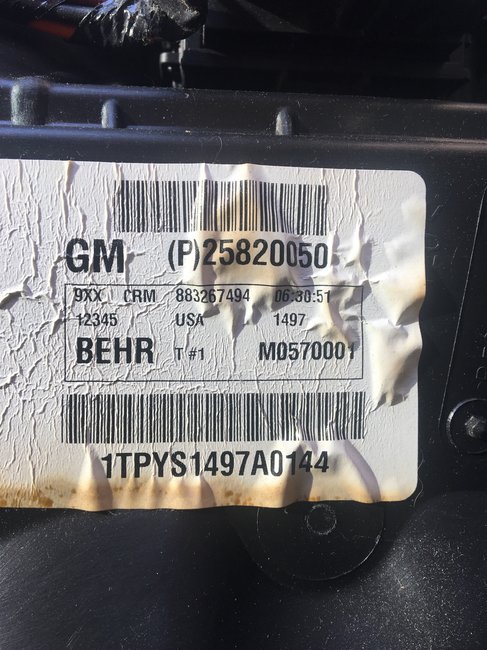

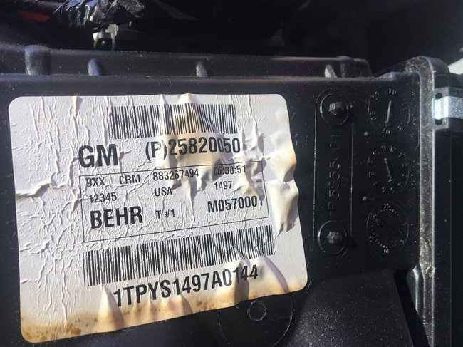

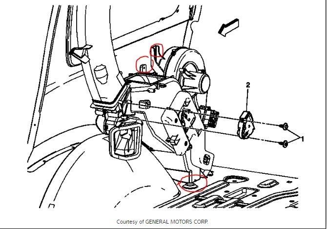

JEFF_WRENCHONIT
Thanks for the responses guys.

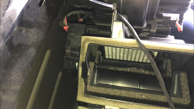

I'm now I'm really stumped! I took a picture of the full unit and you will see that there are no actuators on the face of the HVAC unit like illustrated in the diagrams posted.
I placed the new actuator on top of the HVAC unit and took a picture (see my next post) shooting down from the top, behind the unit. You can barely see the installed/defective actuator and you will see that the shape and tab are the same as the new actuator so I'm pretty confident I'm looking at the right thing!!
Like I said...I'm stumped!! Anyone have a suggestion on how to proceed? I would hate to have to recharge the system..that's well out of my wheel house and I have no idea where I'd even begin.
Thanks again.

JEFF_WRENCHONIT
other picture shooting down behind HVAC unit.

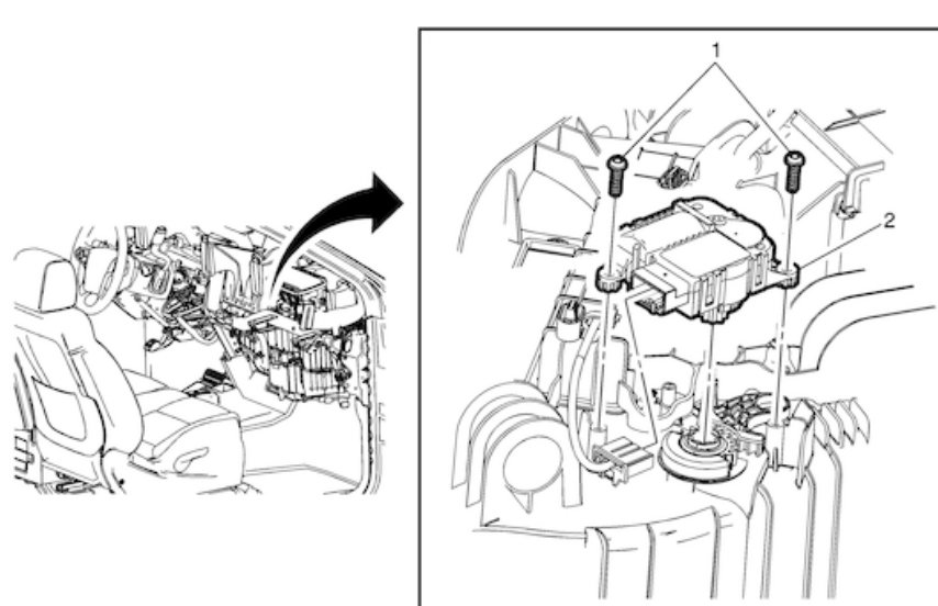

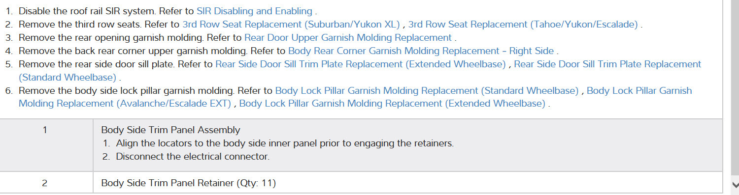

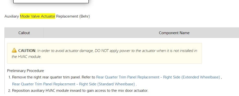

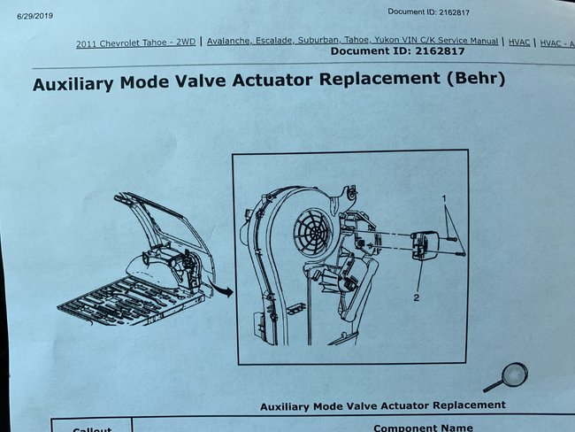

  • 110,244 POSTS
Welcome to 2CarPros.

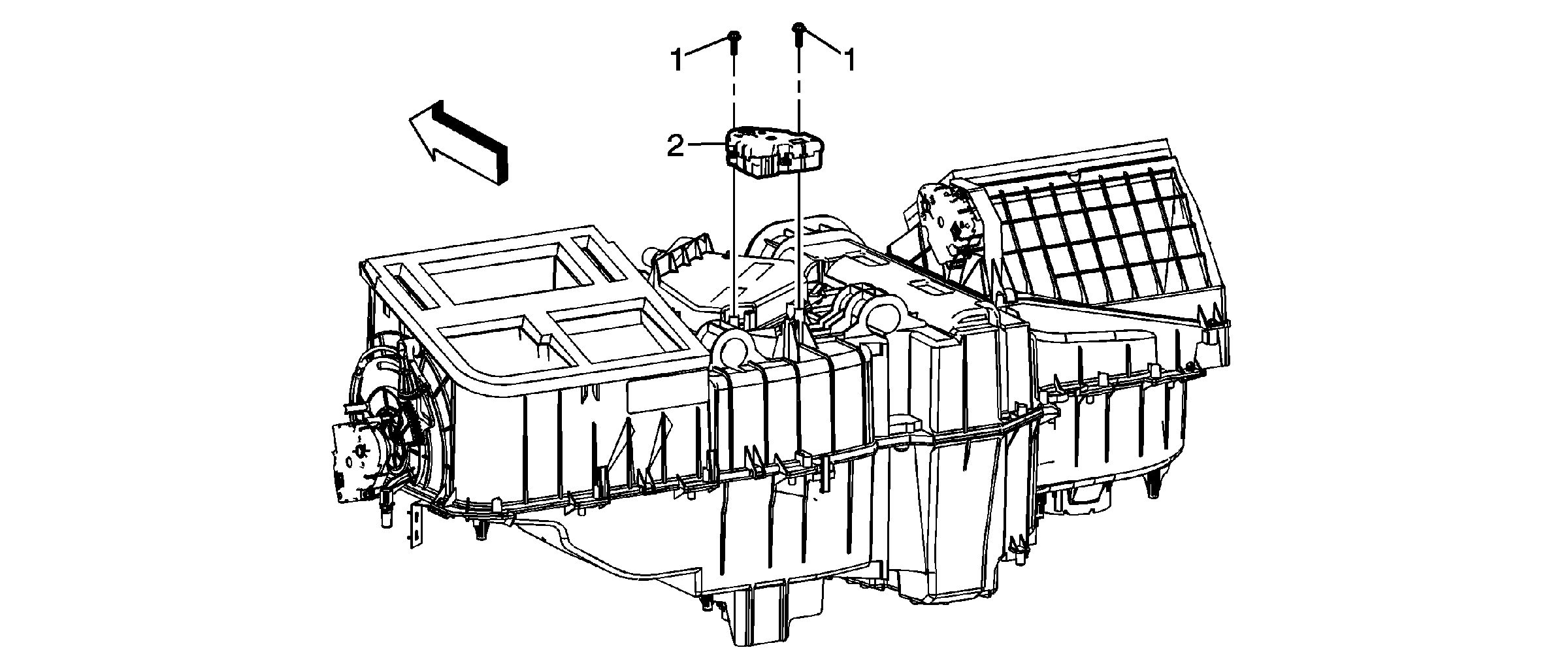

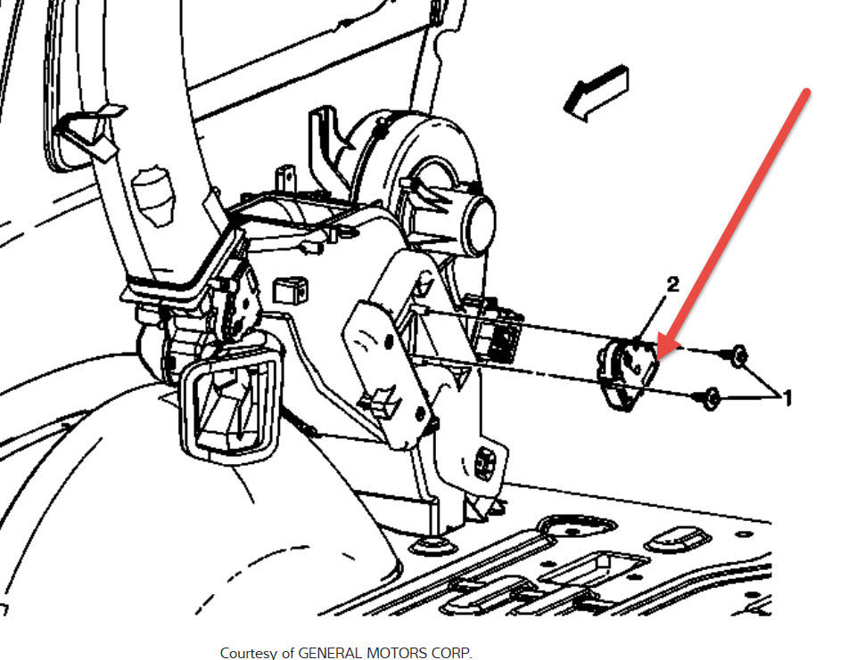

Actually, the blend actuator is to determine temperature which enters the vehicle. I believe you have a problem with what is called a mode door actuator. That is what determines where the air flow exits.
Now, I don't know if you have automatic climate control or manual, so I am going to include directions for the mode valve actuator replacement for both. All attached pictures correlate with the directions.
_____________________________

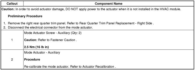

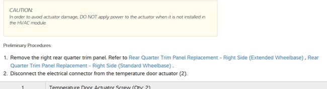

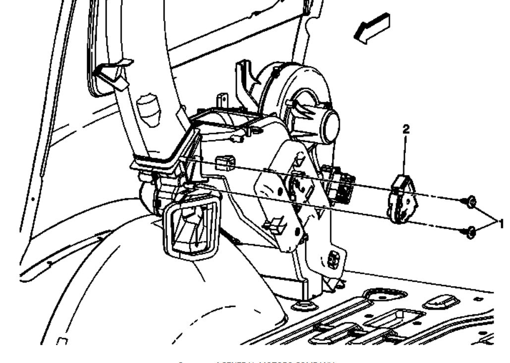

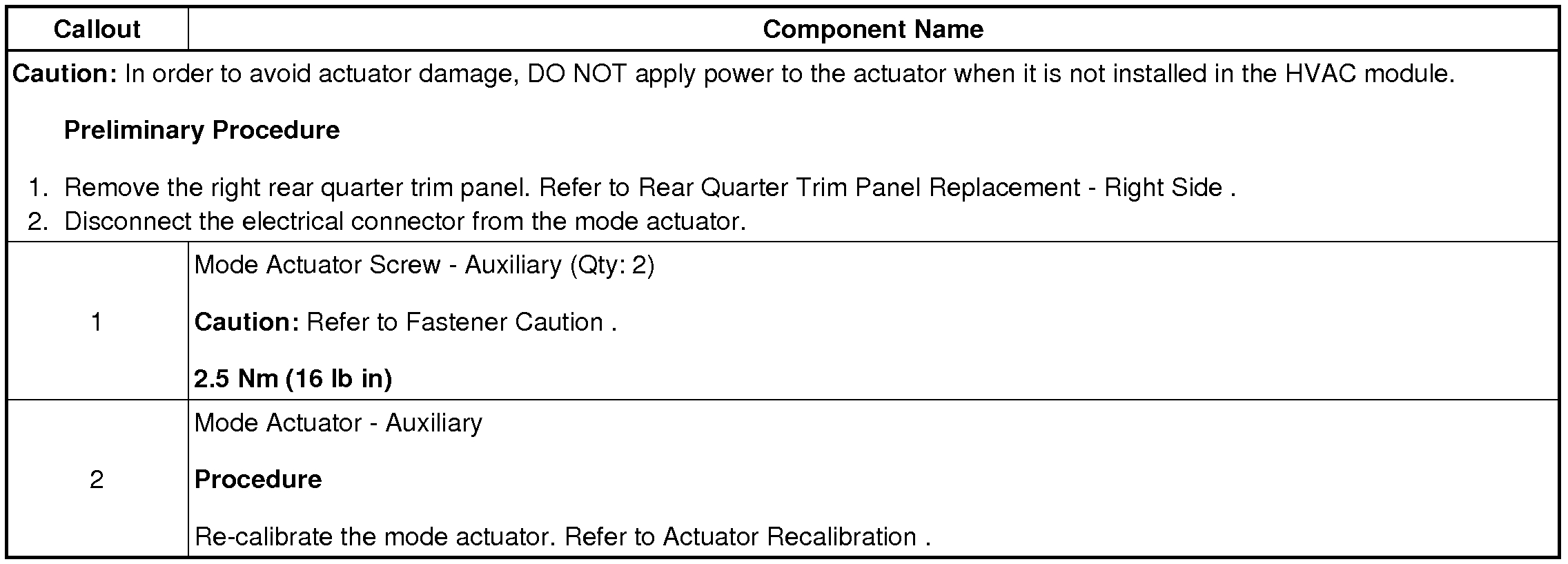

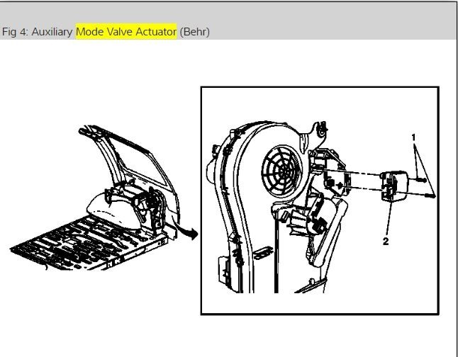

Manual HVAC
See pics 1 and 2 for location and directions.
Auto HVAC
See Pics 3 and 4 for location and directions.

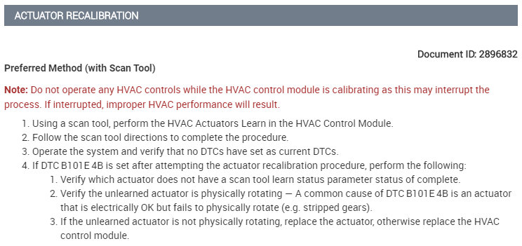

Here are the directions for recalibration of the automatic HVAC. You can do it with a scanner or without.
HVAC - AUTOMATIC
Actuator Recalibration
When replacing the HVAC control module it will be necessary to allow the HVAC control module to perform a calibration process. When installing the HVAC control module be sure to perform the following:
Important: Do not adjust any controls on the HVAC control module while the HVAC control module is self-calibrating. If interrupted, improper HVAC performance will result.
1. Place the ignition switch to the OFF position.
2. Disconnect the scan tool.
3. Install the HVAC control module.
4. Connect all previously disconnected components.
5. Start the vehicle.
6. Wait 40 seconds for the HVAC control module to self-calibrate.
7. Verify that no DTCs have set as current DTCs.
When replacing the HVAC actuator it will be necessary to allow the HVAC control module to perform a calibration process. When installing the HVAC actuator be sure to perform one of the following:
Preferred Method (w/Scan Tool)
1. Clear all DTCs.
2. Place the ignition switch in the OFF position.
3. Install the HVAC actuator.
6. With the scan tool, initiate the Motor Re-calibration feature of the Heating and Air Conditioning Special Functions menu.

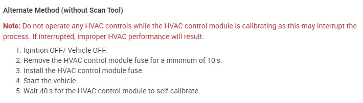

Alternate Method (w/o Scan Tool)
1. Clear all DTCs.
2. Place the ignition switch to the OFF position.
5. Remove the HVAC/ECAS fuse for a minimum of 10 seconds.
6. Install the HVAC/ECAS fuse.
7. Start the vehicle.
8. Wait 40 seconds for the HVAC control module to self-calibrate.
9. Verify that no DTCs have set as current DTCs.

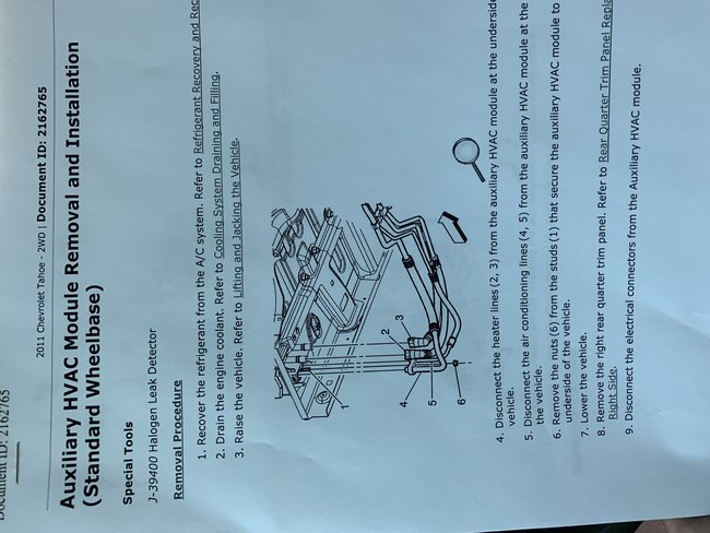

  • 110,244 POSTS
Welcome back:

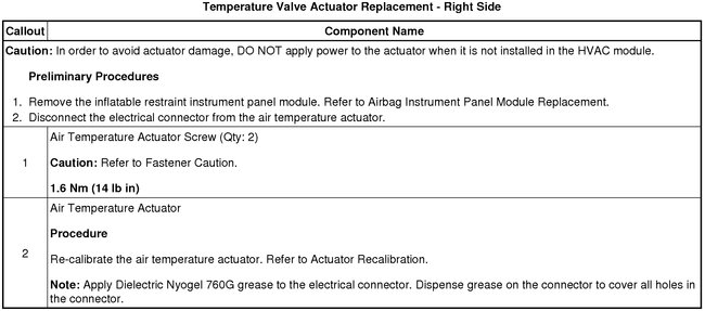

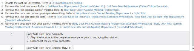

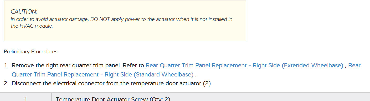

I have never had one like that. However, lets get through this together. I looked at the above link and identified the manufacturer. I had to use a different manual to even find it. Now, (and don't laugh) I had to put what they said are the directions in picture form. The first three is everything they provided. I have a feeling that you will laugh at them.
Next, I looked closely at the pic. I circled what I believe to be two screws at the top and at the bottom, I circled what I believe to be posts that are in rubber grommets. Once the screws are out, it looks like that would pull up.
Now to add insult to injury, this model also shows the mode actuator on the front. Since your's is different, make sure the pic looks like what you have. I noted that the vent to the ceiling is above the actuator in the pic.
Let me know if any of this helps. I wish I was there. It would be much easier. LOL

Good evening.
You need to align the motor with the blend door shaft. it will only go on one way. you may need to adjust the door to the motor shaft to get it in position.
After you get it bolted up, remove the fuse for the AC. wait about ten seconds. then install it and then turn the key to the on position. leave it there for about forty seconds that will calibrate the mode doors.

This guide shows which actuator does what:
