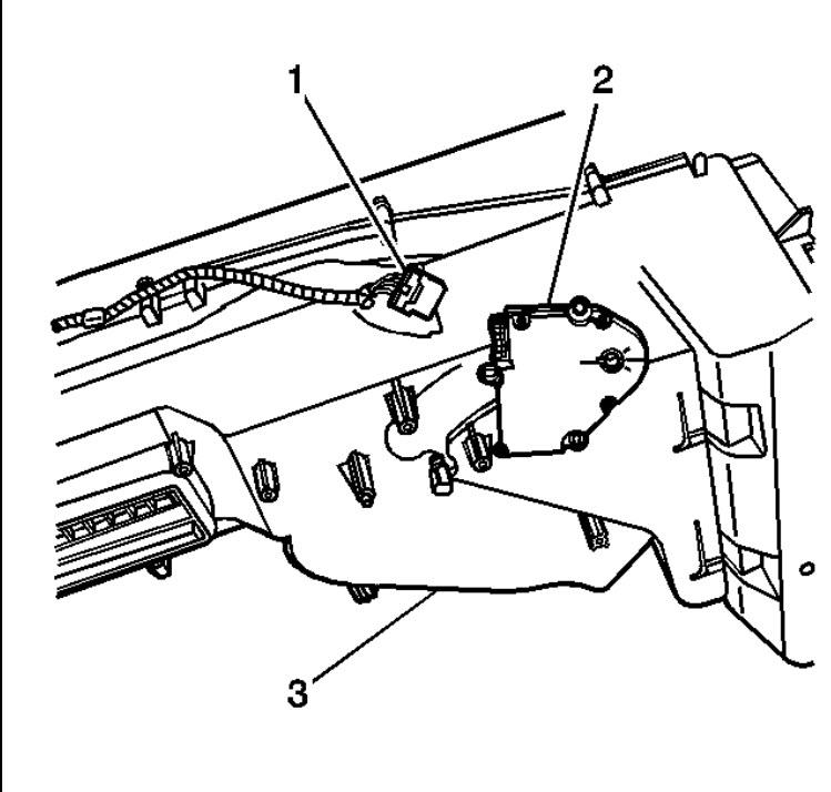

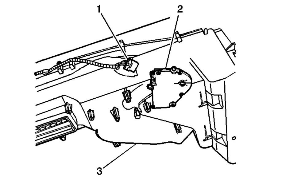

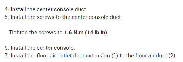

Good afternoon,
It sounds like the blend door motor for the heat has failed.
I attached the procedure with some pictures for you to view. The console has to be removed to access the actuator.
Temperature Valve Actuator Replacement - Left Side
Removal Procedure Notice:In order to avoid actuator damage, do not apply power to the actuator when it is not installed in the HVAC module.
1. Remove the center console, if equipped. See: Console > Removal and Replacement
2. Remove the instrument panel (I/P) insulator panel. See: Dashboard / Instrument Panel > Removal and Replacement
3. Disconnect the electrical connector (1) from the left air temperature actuator (2).
4. Remove the screws from the left air temperature actuator (2).
5. Remove the left air temperature actuator (2) from the HVAC module assembly (3).
Installation Procedure
1. Install the left air temperature actuator (2) to the HVAC module assembly (3).
Notice:Use the correct fastener in the correct location. Replacement fasteners must be the correct part number for that application. Fasteners requiring replacement or fasteners requiring the use of thread locking compound or sealant are identified in the service procedure. Do not use paints, lubricants, or corrosion inhibitors on fasteners or fastener joint surfaces unless specified. These coatings affect fastener torque and joint clamping force and may damage the fastener. Use the correct tightening sequence and specifications when installing fasteners in order to avoid damage to parts and systems.
2. Install the screws to the left air temperature actuator (2).
Tighten
- Tighten the screws to 2 Nm (18 lb in).
3. Install the electrical connector (1) to the left air temperature actuator (2).
4. Install the I/P insulator panel. See: Dashboard / Instrument Panel > Removal and Replacement
5. Install the center console if equipped See: Console > Removal and Replacement
6. Reprogram the left air temperature actuator. See: Heating and Air Conditioning > P

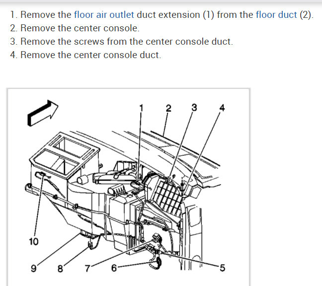

JON MICHAEL CARROLL
The temperatures for both sides are set to hot. However, the driver side is blowing cold. Is the blend door I need to replace under the quiet panel (really easy to replace) or buried in the dash (really hard to replace?
Thanks,
Jon
Feb 25, 2021 at 10:00 AM (Merged)
DANNY L
  • 5,648 POSTS

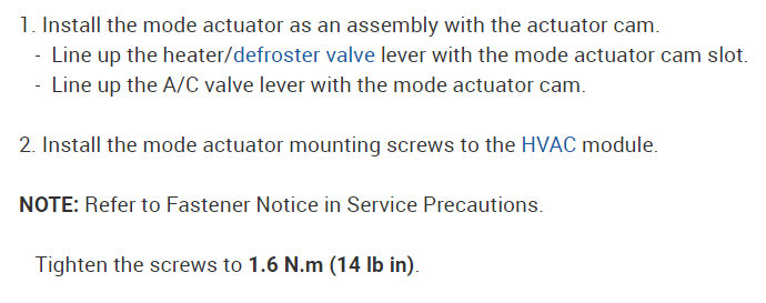

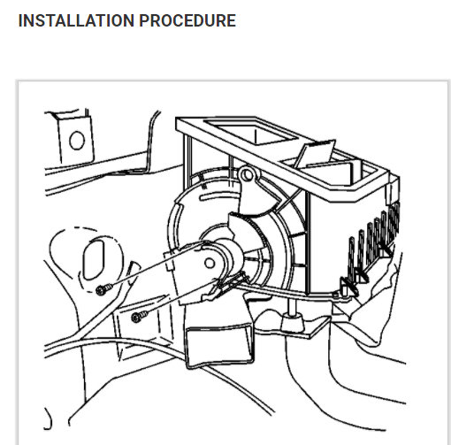

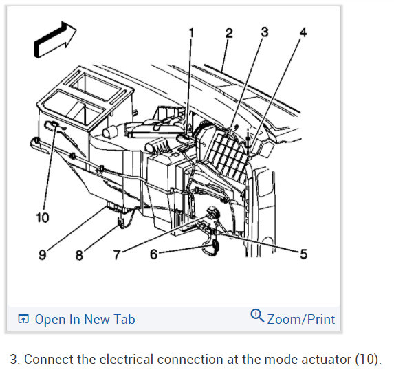

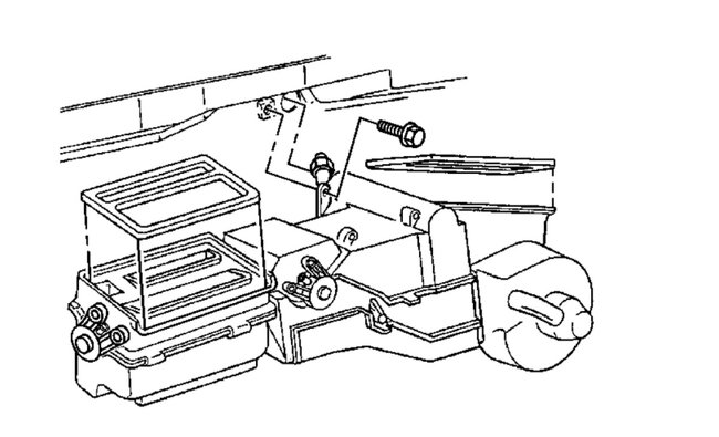

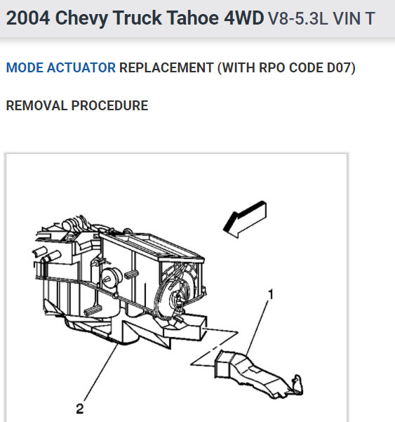

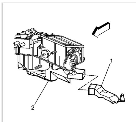

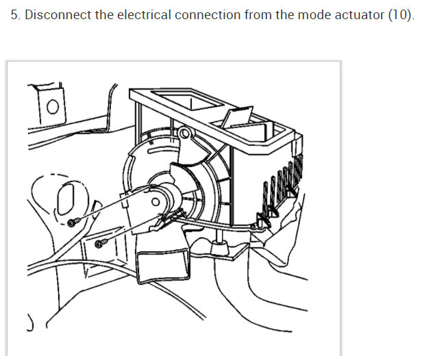

Hello, I'm Danny.
Yes, it sounds like you are having an issue with the blend-mode door actuator. It is a small electric motor that opens and closes a door flap to route airflow through specific ducts in the hvac box to specific vents depending on setting. Here is a tutorial showing how to replace a blend-mode actuator:
I've attached picture steps below showing removal and replacement of the actuator for your vehicle. Hope this helps and thanks for using 2CarPros.
JON MICHAEL CARROLL
Thank you for the quick response. I have found and removed the actuator that is easy to get to. However, when I turn the actuator by hand it only heats the right side. I see the diagrams you sent but truthfully they don't make much sense as I am not a mechanic. Where is the actuator that controls the heat for the left side? Thanks, Jon
  • 54,837 POSTS
DANNY L is one of our best! If you click on the guide it explains where the actuators are and what they do.

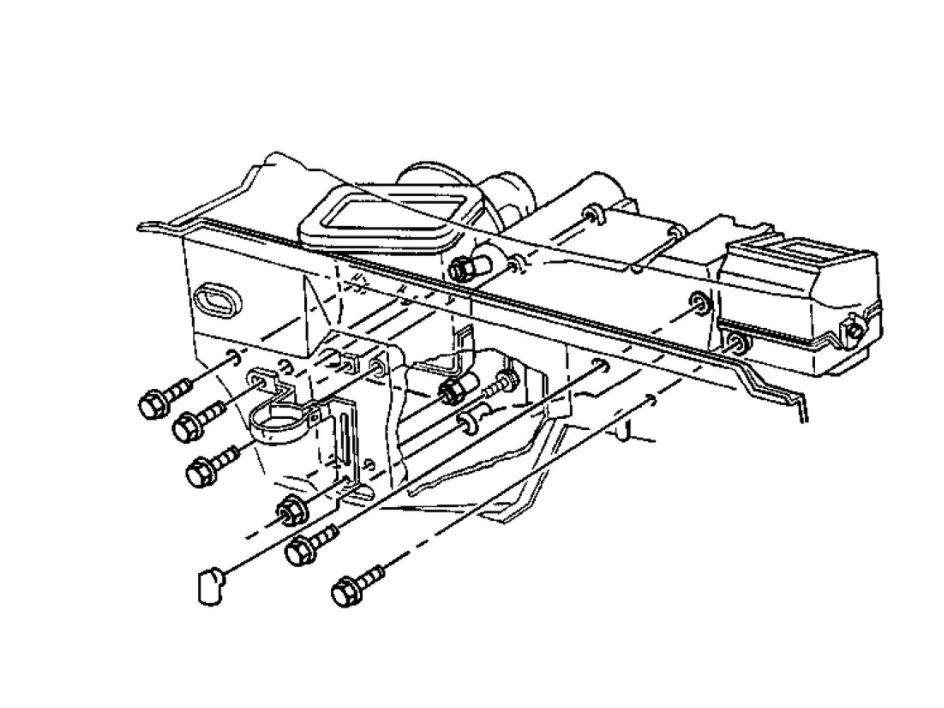

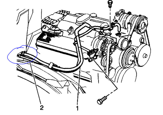

Good morning,
I would remove the heater hoses from the firewall and flush the heater core. Use a garden hose to flush the dirt and debris. Run it both ways until you get a good even flow.
Beyond that, you may need a heater core.
https://www.2carpros.com/articles/replace-heater-core
Heater Core Replacement
Removal Procedure
1. Drain the coolant. Refer to Cooling System Draining and Filling .
2. Remove the instrument panel storage compartment. Refer to Instrument Panel Carrier Replacement .
3. Disconnect the electrical connectors, as necessary.
4. Remove the center floor air distribution duct.
5. Remove the hinge pillar trim panels. Refer to Instrument Panel Carrier Replacement .
6. Remove the blower motor cover.
7. Remove the blower motor. Refer to Blower Motor and Fan Replacement See: Blower Motor > Procedures.
8. Remove the steering column. Refer to the applicable procedure:
- Steering Wheel Replacement in Steering Wheel and Column - Standard: See: Steering Wheel > Procedures
- Steering Column Replacement in Steering Wheel and Column - Tilt: See: Steering Column > Removal and Replacement
9. Roll back the instrument panel. Refer to Instrument Panel Carrier Replacement .
10. Remove the coolant recovery reservoir. Refer to Coolant Recovery Reservoir Replacement See: Coolant Reservoir > Procedures > Coolant Recovery Reservoir ReplacementSee: Heater Hose > Procedures > Heater Hoses Replacement.
11. Remove the heater hoses. Refer to Heater Hoses Replacement .
12. While holding the heater case to the cowl, remove the screw on the interior side of the cowl, near the evaporator pipe, if equipped.
13. On the engine side of the cowl, remove the 4 screws that hold the heater case to the cowl.
14. On the engine side of the cowl, remove the 2 nuts that hold the heater case to the cowl.
15. Remove the heater case.
Ask an assistant for help, if necessary.
16. Remove the 7 screws that hold the heater cover to the heater case.
17. Remove the heater cover.
18. Remove the heater core from the retainer.
1. Install the heater core into the retainer.
2. Install the 7 screws that hold the heater cover to the heater case. Replace the seals.
3. Install the heater cover.
Verify that the heater cover is properly sealed.
4. Install the heater case.
If necessary, ask an assistant for help.
