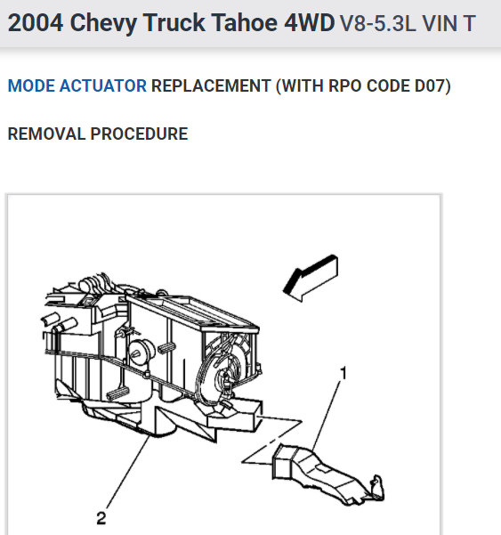

The temperatures for both sides are set to hot. However, the driver side is blowing cold. Is the blend door I need to replace under the quiet panel (really easy to replace) or buried in the dash (really hard to replace?
Thanks,
Jon
Thursday, February 25th, 2021 AT 10:00 AM (Merged)
DANNY L
  • 5,648 POSTS
Hello, I'm Danny.

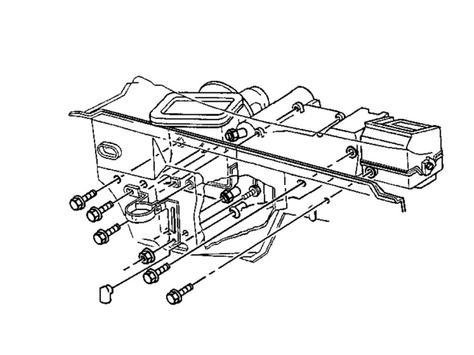

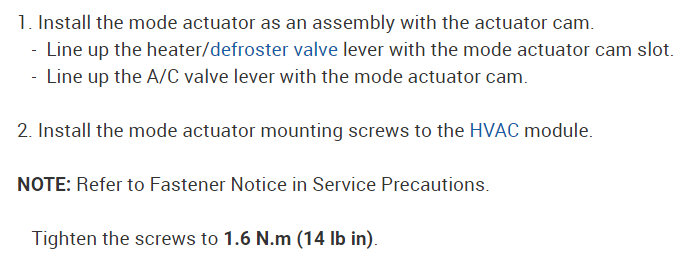

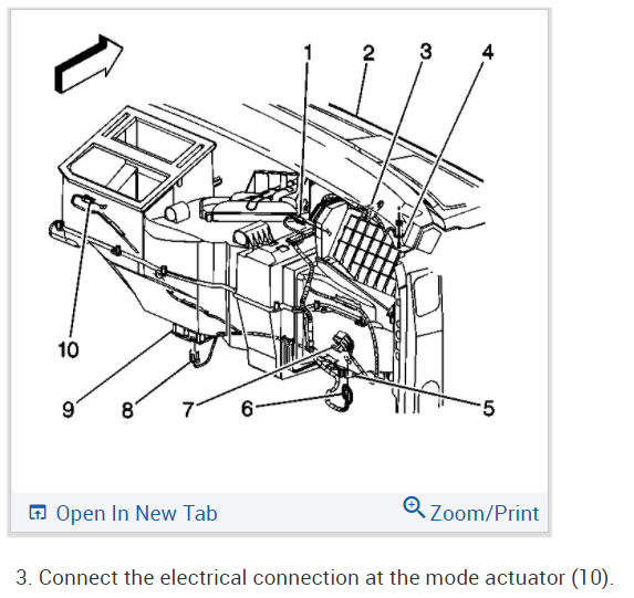

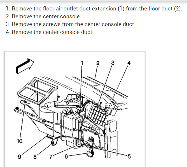

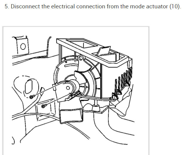

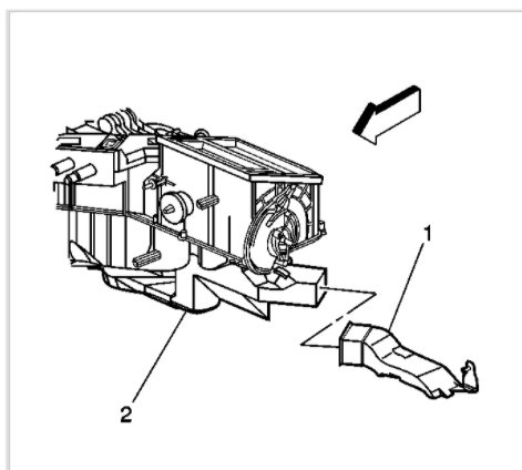

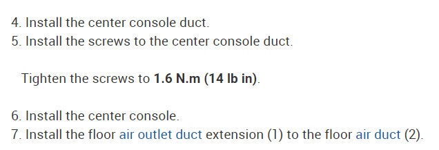

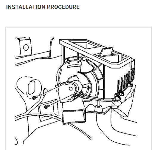

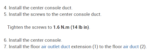

Yes, it sounds like you are having an issue with the blend-mode door actuator. It is a small electric motor that opens and closes a door flap to route airflow through specific ducts in the hvac box to specific vents depending on setting. Here is a tutorial showing how to replace a blend-mode actuator:
I've attached picture steps below showing removal and replacement of the actuator for your vehicle. Hope this helps and thanks for using 2CarPros.
JON MICHAEL CARROLL
Thank you for the quick response. I have found and removed the actuator that is easy to get to. However, when I turn the actuator by hand it only heats the right side. I see the diagrams you sent but truthfully they don't make much sense as I am not a mechanic. Where is the actuator that controls the heat for the left side? Thanks, Jon

DANNY L is one of our best! If you click on the guide it explains where the actuators are and what they do.

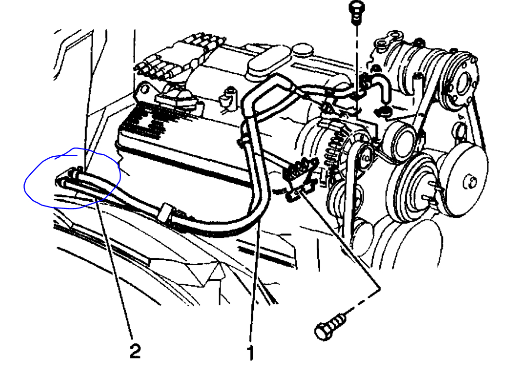

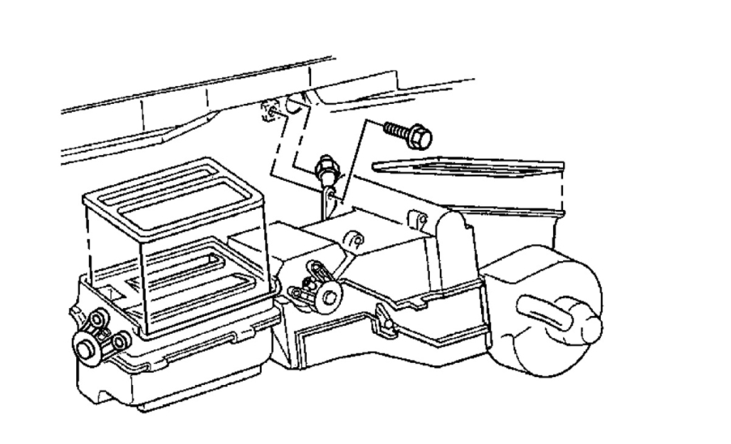

I replaced the main head control of the HVAC system because my fan only had 2 speeds. High and off, when the fan was set to off it was on high, and vice versa. Replaced the head and the fan speeds are working correctly. But now, the only warm air comes from the middle and passenger vents. The drivers side is cold air. I replaced the actuator under the driver side dash and the issue remains.
  • 52,797 POSTS
Good morning,
I would remove the heater hoses from the firewall and flush the heater core. Use a garden hose to flush the dirt and debris. Run it both ways until you get a good even flow.
Beyond that, you may need a heater core.
https://www.2carpros.com/articles/replace-heater-core

12. While holding the heater case to the cowl, remove the screw on the interior side of the cowl, near the evaporator pipe, if equipped.
13. On the engine side of the cowl, remove the 4 screws that hold the heater case to the cowl.
14. On the engine side of the cowl, remove the 2 nuts that hold the heater case to the cowl.
15. Remove the heater case.
