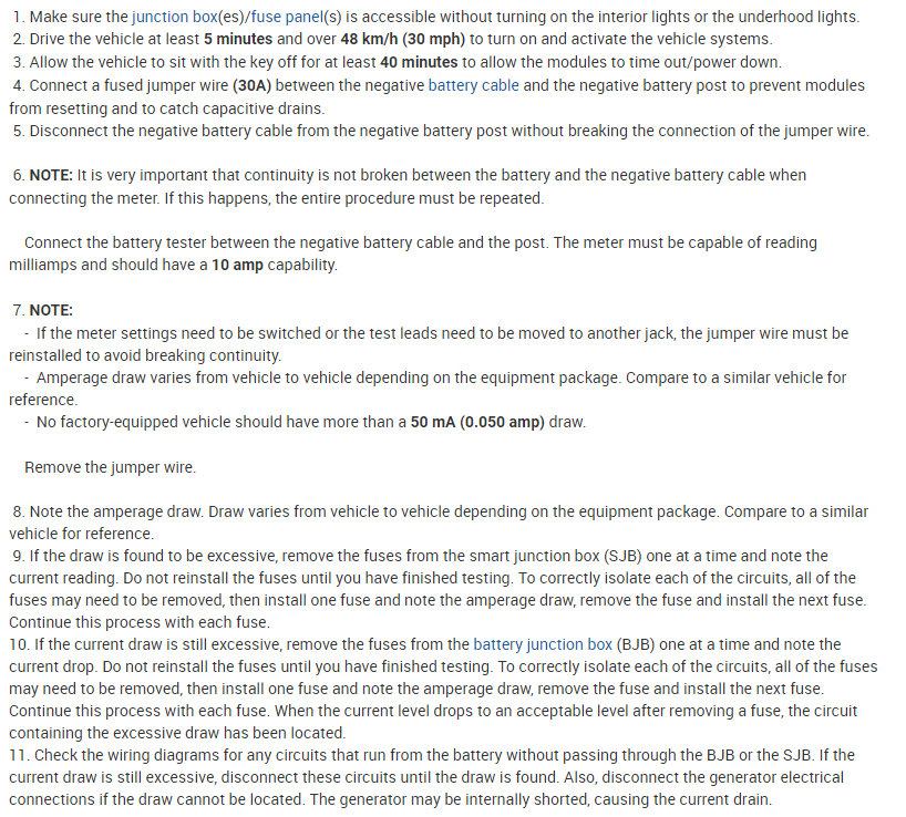

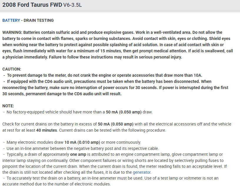

My car will stop and then doesn't want to start. the battery is completely drained in the morning or even after a couple hours. I have put in a new battery, a new motor, a new fuel pump modulator and the battery still completely drains and wont start.
Mar 19, 2019 at 1:52 PM
Good afternoon,
You have a parasitic drain on the battery. You need to check for the circuit that is causing the drain.
You need to remove the negative battery cable and put a voltmeter in line. Red lead on the battery post and the black lead on the cable. Set the meter to DC amps and wait for thirty minutes. Then see what reading is on the meter. It should be 50-75 milliamps.
If it is more, then remove fuses one by one until the draw drops to the specs. when it does then you know the circuit that is causing the drain.

It sounds like your vehicle has a parasitic draw, which making the battery drain slowly.
When the battery loses its charge over a short period of time due to a voltage drain in the electrical system which is called a parasitic draw.
It could happen form the dome light, trunk link or glove box light staying on overnight. Could be for a faulty window switch or power seat switch. It could happen from just about any electrical equipment in the car.
Take a look at this article, you might find it helpful:
https://www.2carpros.com/articles/car-battery-dead-overnight
Also this is a very good video on how to check for parasitic draw:
https://youtu.be/z5F7WpgjaRs
I have also attached instructions (look below) on how to do the testing.
Please follow those steps and let me know if you have any questions.

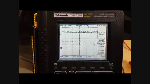

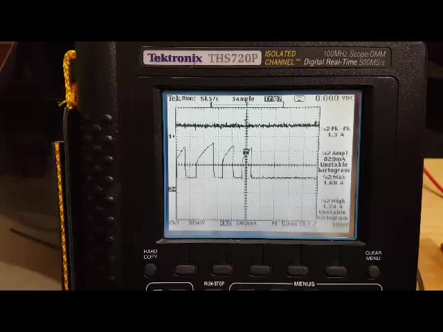

JEFF WINTER
My car has an intermittent parasitic current draw that drains my battery within 8 hours. I have replaced the alternator and a new battery. I placed an oscilloscope with a current clamp on the negative of the battery. The scope shows intermittent triangular wave forms with a peak current draw of 1- 2 amps. I have measured the voltage drops across all the fuses and there is no indication of a voltage drop.
What could be the cause of this intermittent triangular current draw?
Thanks for your assistance.
Jeff
Jul 28, 2021 at 1:49 PM (Merged)
Good evening,
I attached a guide for you to view for the parasitic draw.
Put your amp meter in line with the negative cable and check the draw. Pull each fuse one at a time until the draw goes down to 50-75 milliamps. Then you will know the circuit that is causing the draw.

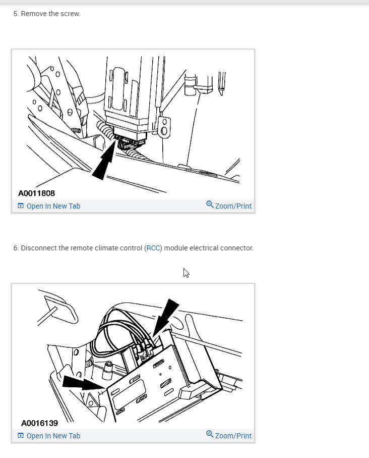

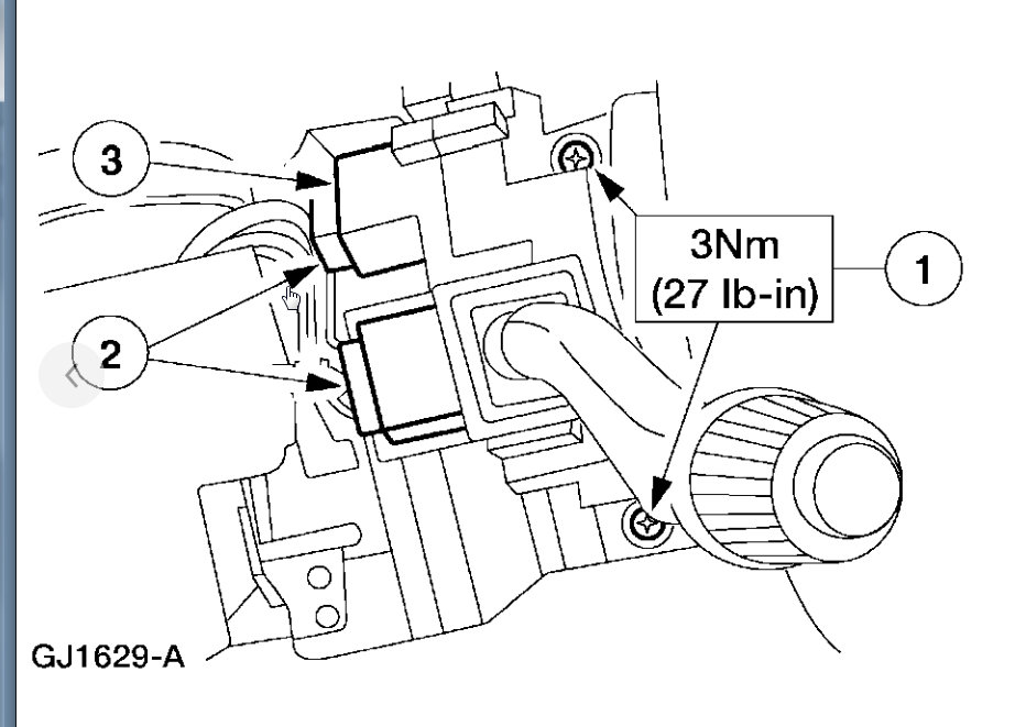

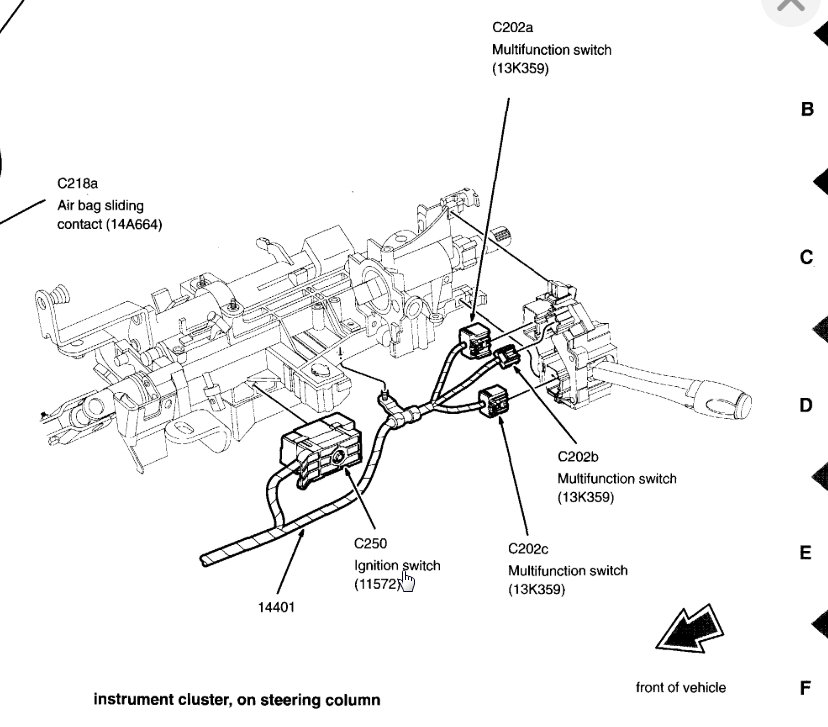

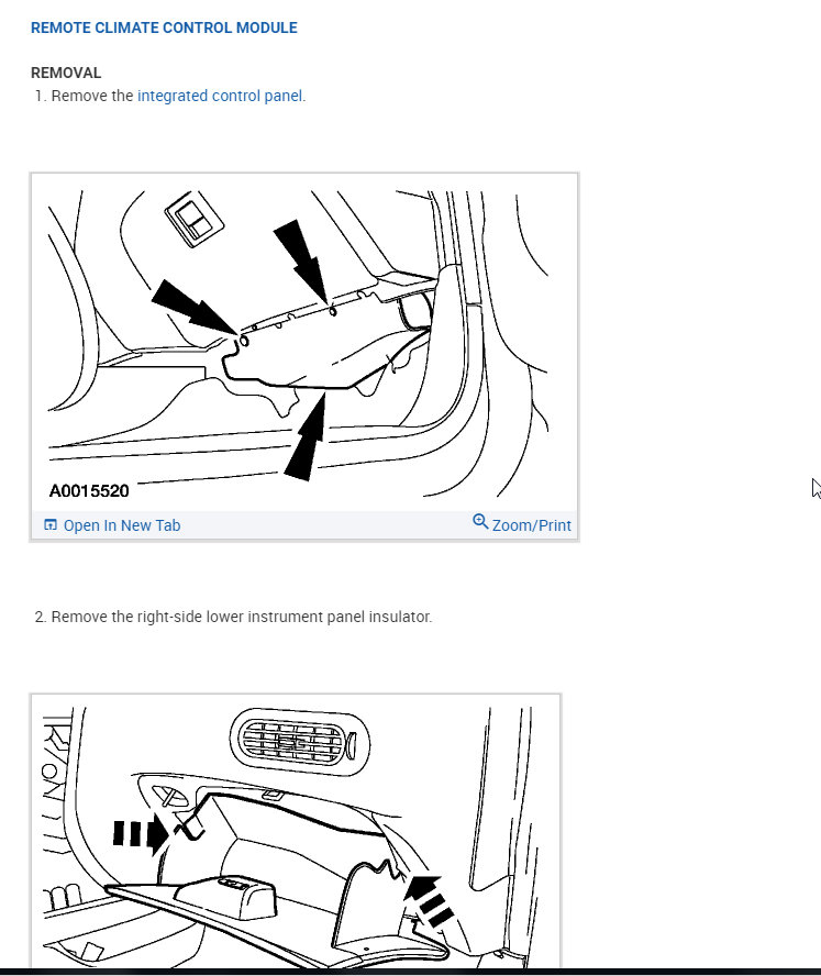

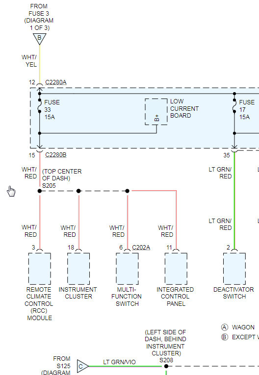

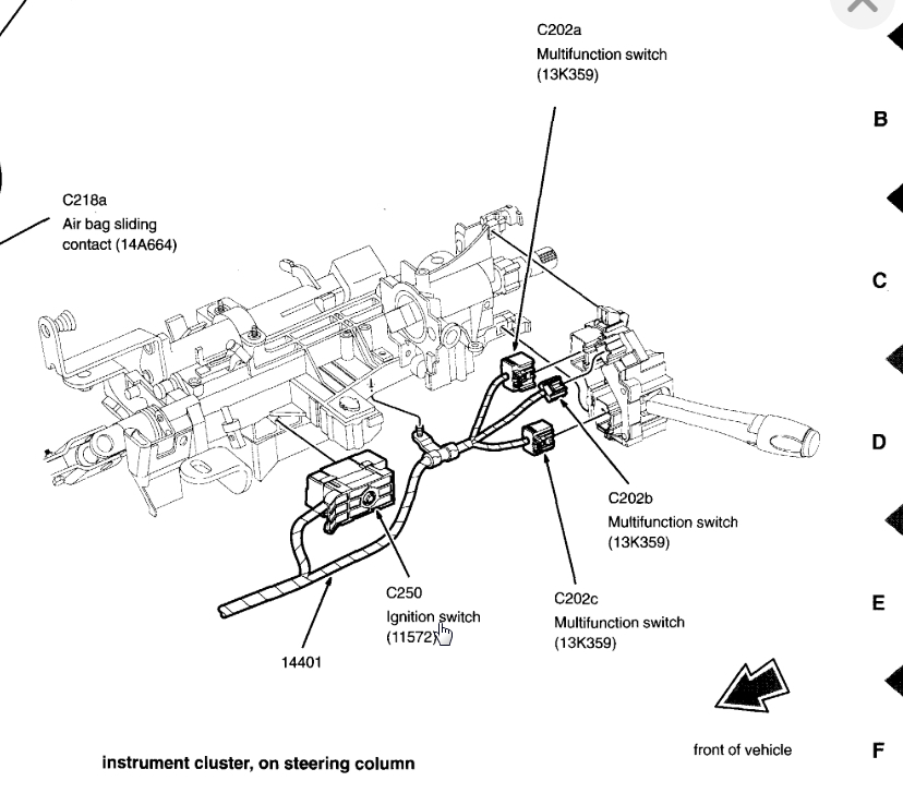

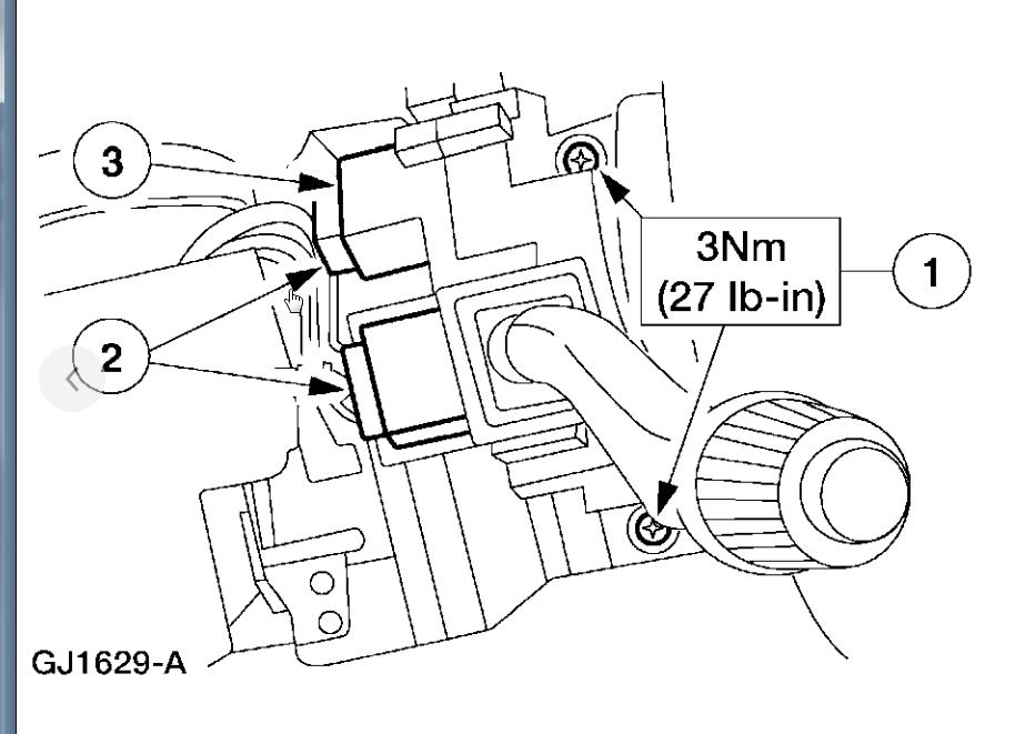

MERANN
Using a test light I narrowed down the drain to fuse F2.33. The problem is that I don't have a clue where to go from here to isolate the drain. The fuse covers five circuits: Remote Climate Control module, Instrument cluster, Multi-function switch, Integrated Control Panel, and Smart Junction Box. Other than the instrument cluster, I don't even know where to look for the other four. Can you help me?
Jul 28, 2021 at 1:50 PM (Merged)
So the way to find the draw at this point is to monitor the off draw amps by hooking the meter inline with the negative battery terminal. Then you will want to go and unhook each of the components on this circuit. You are correct with each one of them.
The multifunction switch is the turn signal switch on the left hand side of the steering wheel.
The cluster is all the gauges which I think you are aware of.
The integrated control module is part of the cluster. It is its' own component but is not serviceable separate.
The junction block is where the fuse is located.
I suspect you have an issue in the cluster so I would unplug it and see if the draw goes awy. If not then you need to move on back again I would start with the cluster.
Let me now if there are questions. Thanks
