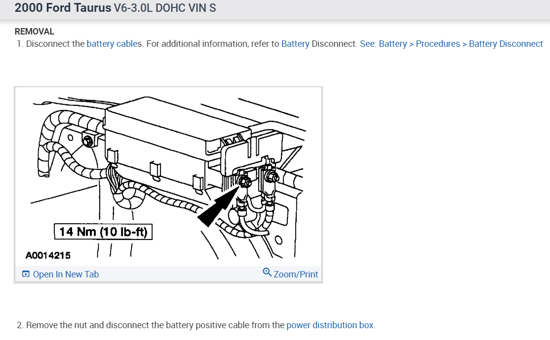

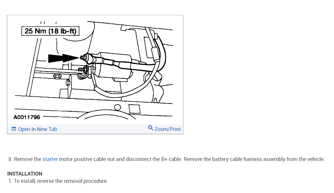

Occasionally when I turn the ignition the car will completely die, no lights, chimes, clock, no starter click. It's as if I disconnected the battery. Shaking the ground cable to the battery brings everything back however, I've replaced both the ground and positive battery cables and polished the connection points and although this helped initially the problem is recurring more often with the cold weather. This began about 2 years ago but it is happening more frequently now. I've also cleaned the connections to the fuse box in front of the battery. Any ideas before I pass it on?

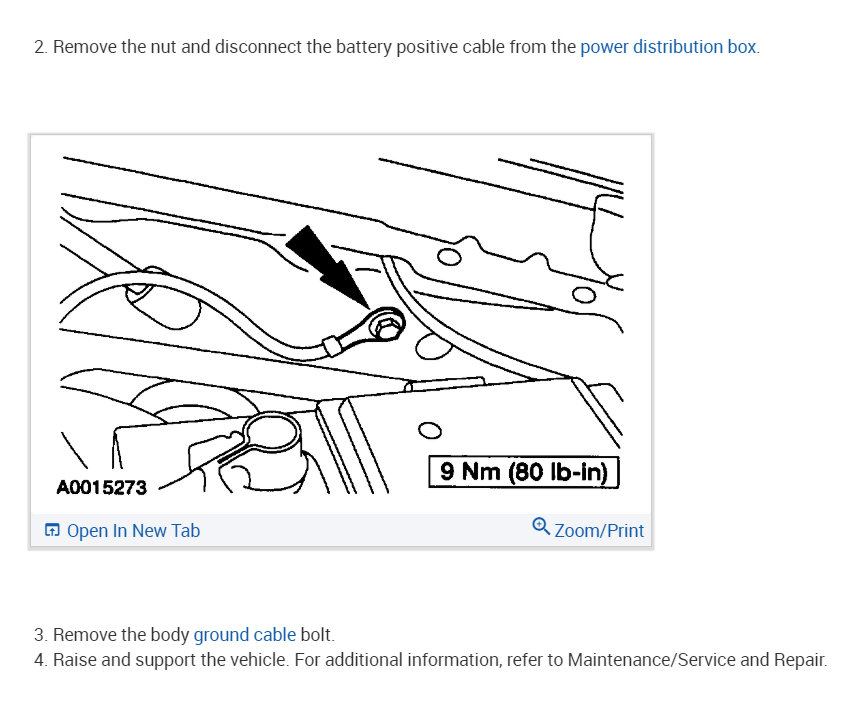

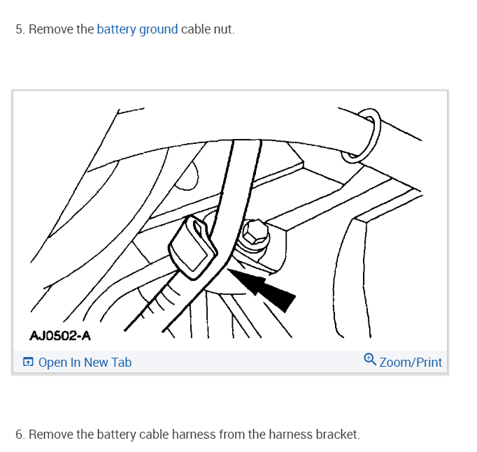

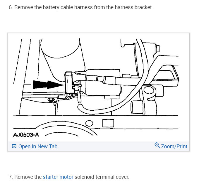

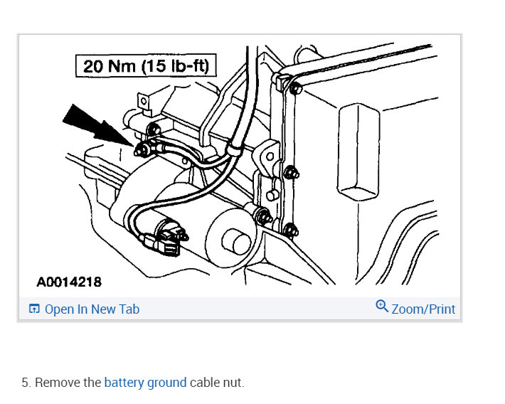

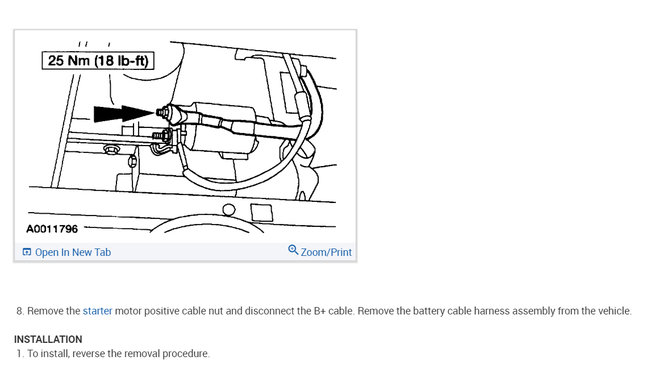

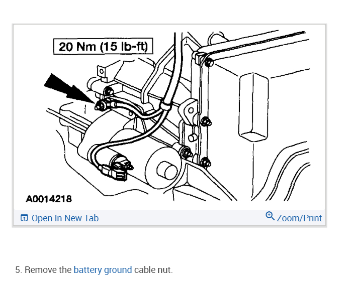

When you shake the cable does it spin back and forth on the post? Here is instructions on how to change both positive and negative battery cables. Check out the diagrams (Below). Please let us know if you need anything else to get the problem fixed.

No, everything is tight. That's why it doesn't make sense. Originally I thought it was the positive cable so I replaced that. When the problem showed up again, that's when I realized, (actually my wife discovered) that shaking on the ground cable brought it back so I replaced that. This was about 2 years ago and it's happening with more frequency now. Yesterday she came out of an appointment and it went dead then after getting it going, drove for 50 minutes, pulled in to get gas, stopped the engine and it happened again though this time I was there and saw what was happening.
