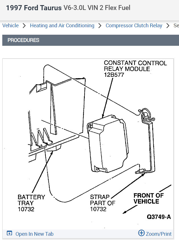

I have seen the compressor relay stick and drain the battery down, here is a guide to help as well and I have included the compressor relay location so you can remove it to see if it fixes it.
https://www.2carpros.com/articles/car-battery-dead-overnight
It is part of the constant control relay which ford had problems with. Check out the images (below). Please let us know what happens.
