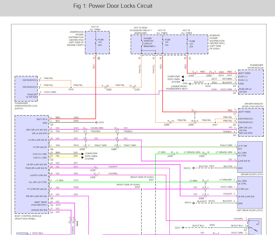

There is a single wire that controls the locking for all the doors, it is the light green wire. If that wire has a bad connection your locks will not get the signal properly. What do you have for a scan tool?

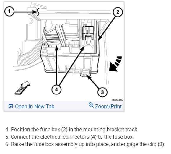

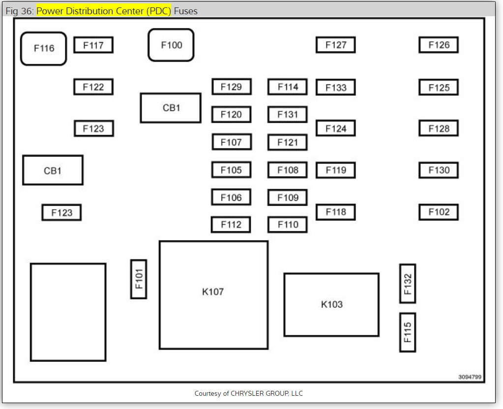

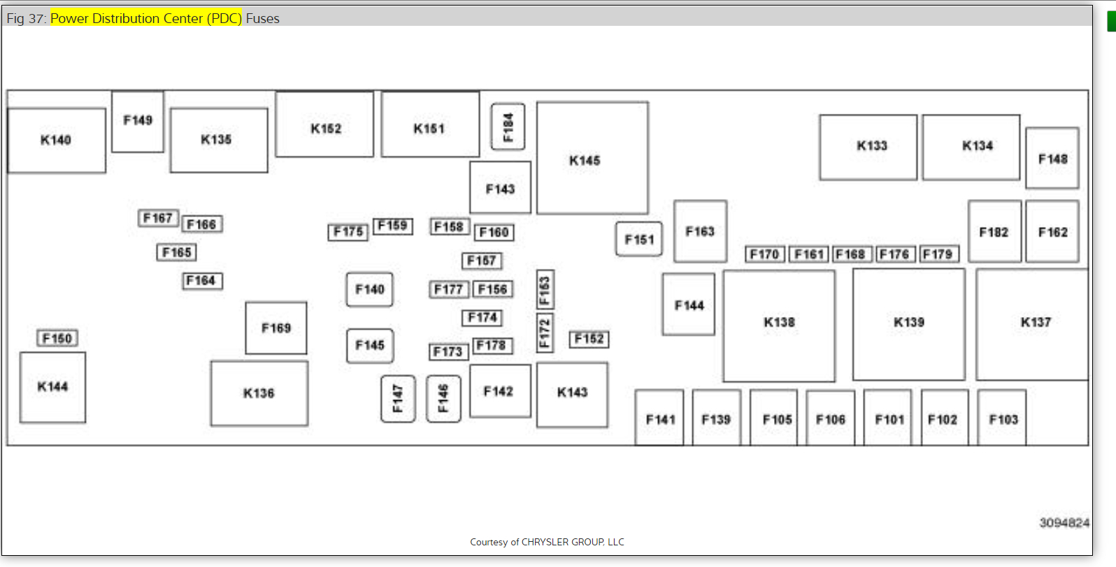

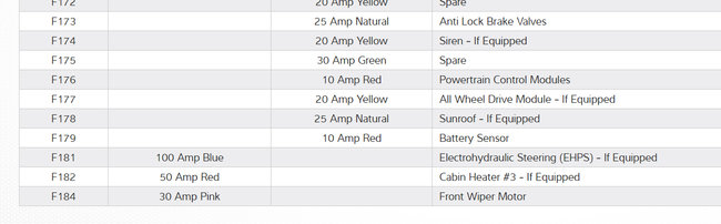

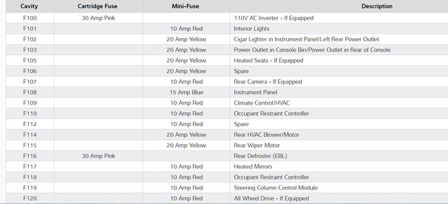

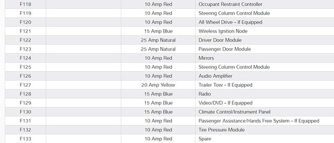

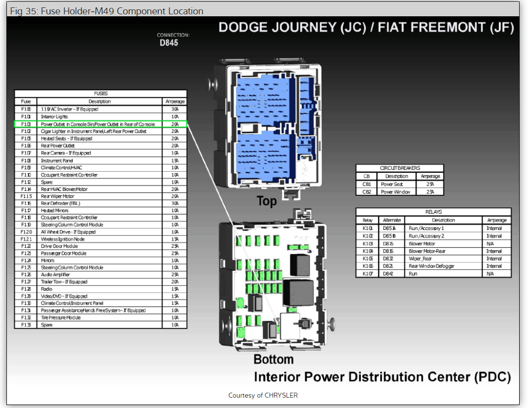

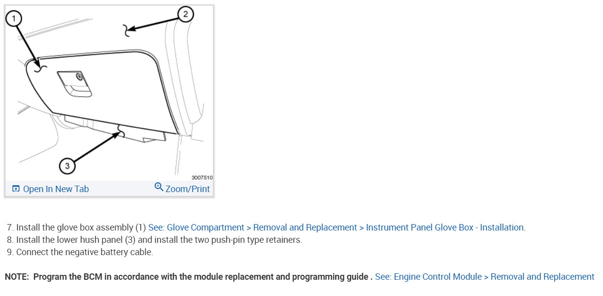

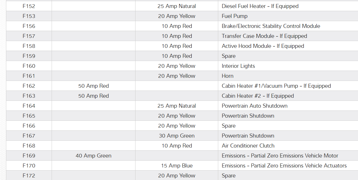

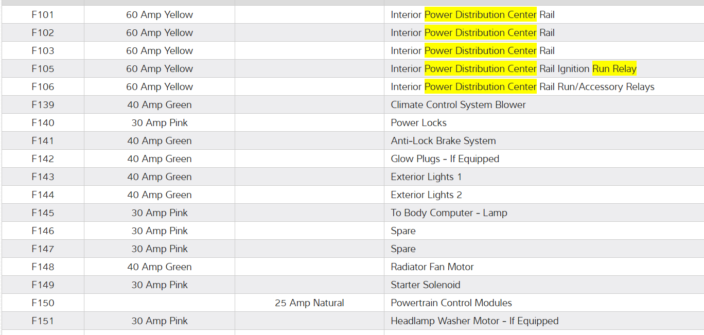

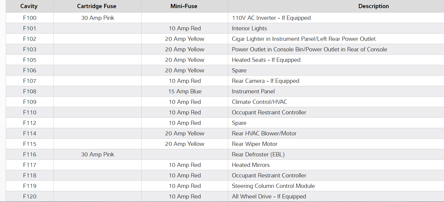

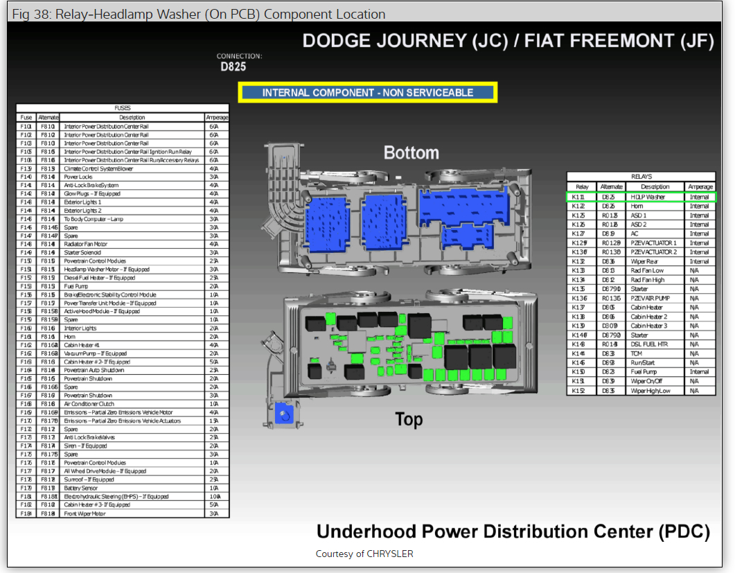

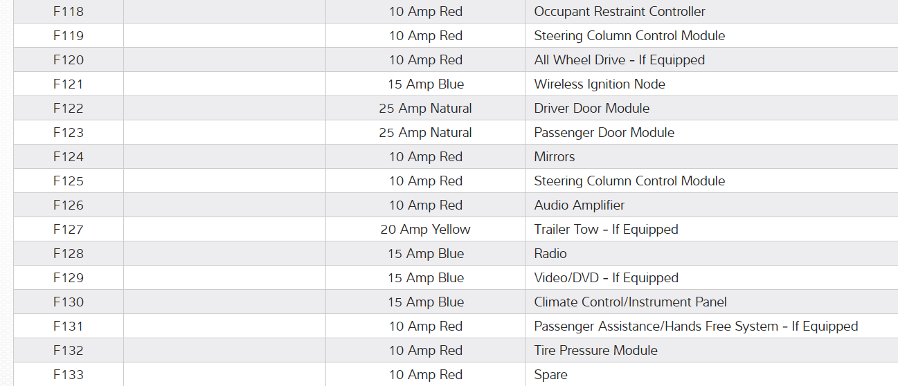

It sounds like you have a weak door module or a bad ground. Here is a guide to help us check the grounds and 12 volts at fuses #144, 124, 123:

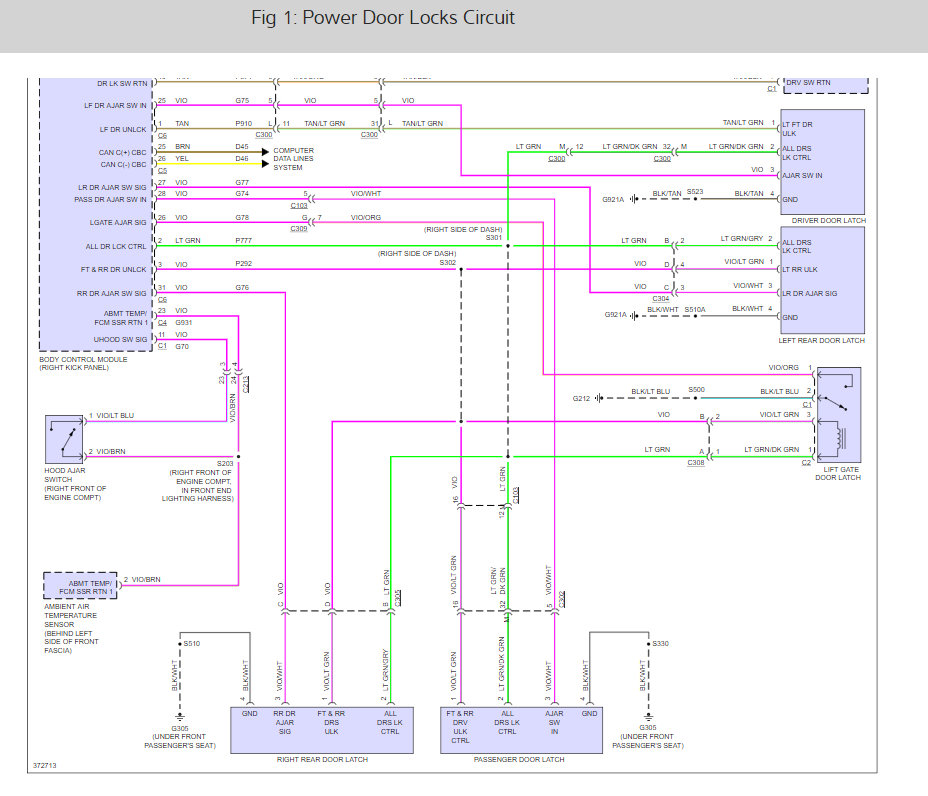

Here are the door lock wiring diagrams and the fuse locations as well.

Hey Ken. Fuses 122 and 123 both have good power and ground. 133 says it is a spare fuse and I could find power but not a ground on it. It also did not have a fuse in it.
Dec 7, 2018 at 1:04 AM
  • 55,834 POSTS
Sorry 144 was the fuse I made a mistake. Can you check it?
Dec 7, 2018 at 1:13 AM
BEAUGRANBOIS
  • 12 POSTS
Checked all fuses in the vehicle and all are good.
Dec 7, 2018 at 1:25 AM
BEAUGRANBOIS
  • 12 POSTS
144 has power and ground but the ground flickers off sometimes when I lock the doors.
Dec 7, 2018 at 1:32 AM
STEVE W.
  • 15,423 POSTS
No ground at fuse 144, it feeds power to the BCM, but if you are seeing it flicker it could be a bad fuse socket or the BCM ground it corroded.

Hey Steve W. Do you happen to know where the light green wire is that controls all of the locks? I swapped out the TIPM with another unit and the problem remained. Also if anyone can tell me if they know where the grounds are for the door lock system and the BCM ground. Right before Christmas all of the locks started working and did everything like they was suppose to. I was happy but didn’t think it would last long. It lasted for two days and went back to the way it was before. Next I’m going to start pulling lock actuators and checking for frayed wires, damage or anything that looks like it might be causing it. I would like to check the grounds if anyone has any info on locations that would be very helpful. Thank you again.

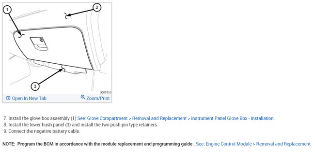

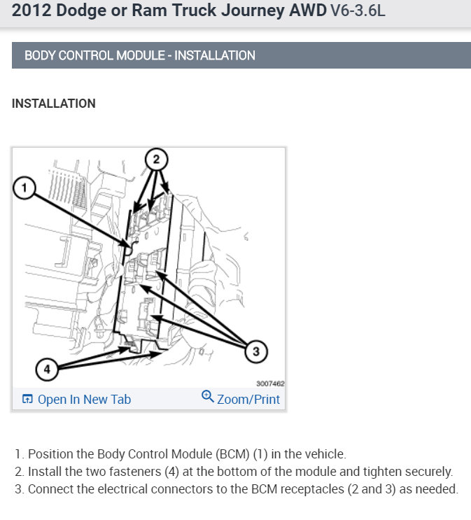

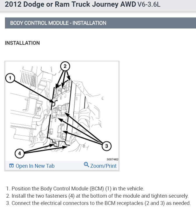

It sounds like the BCM is bad and the guys looking at it are missing it. To be sure lets scan the CAN. This video shows how. If the BCM comes up bad you will need to have it programmed unless you get a used/rebuilt unit. Should cost about $130.00 for the programming.
https://youtu.be/InIlnsjOVFA
Check out the diagrams (below) for the BCM locations. Please let us know what you find.
