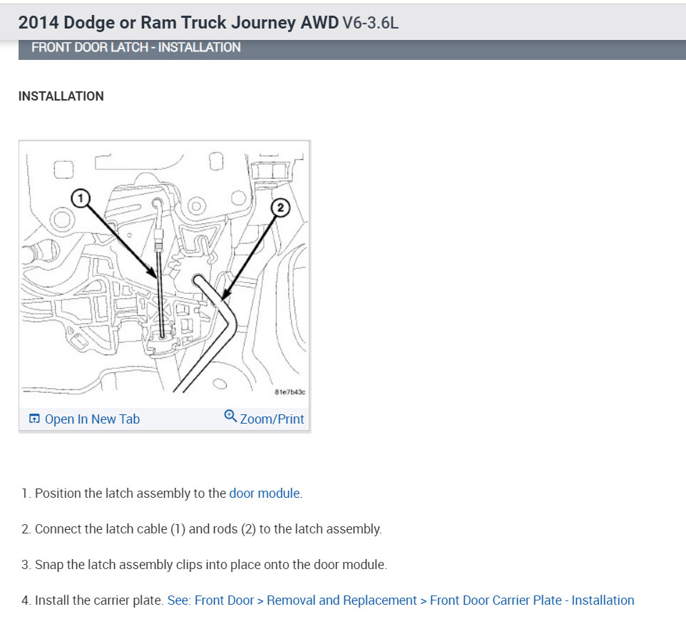

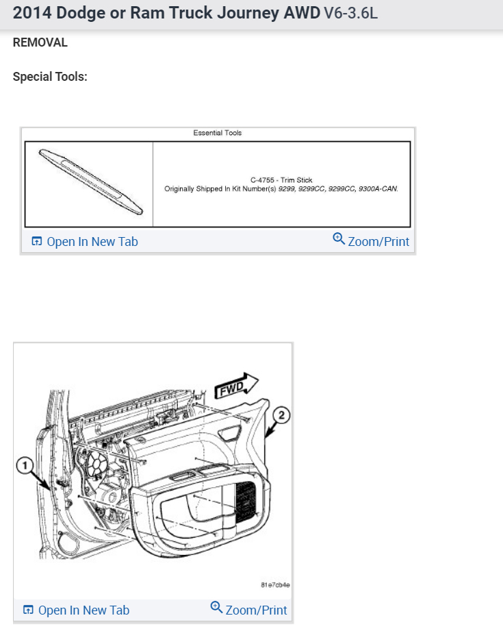

door latch stuck in open position on rear passenger door drivers side.
2014 DODGE JOURNEY
12,000 MILES • 4 CYL • FWD • AUTOMATIC
BKSMILEY8300
Won't latch. How can I fix this myself?

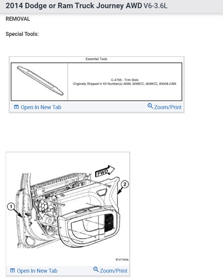

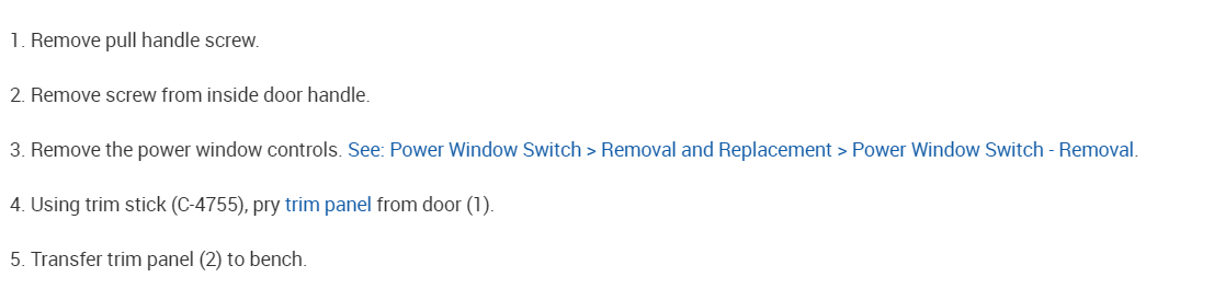

If none of this works, then we need to remove the door panel.
Here is a guide that will show you how to do it. Please run through all this info and let us know what you find. Thanks

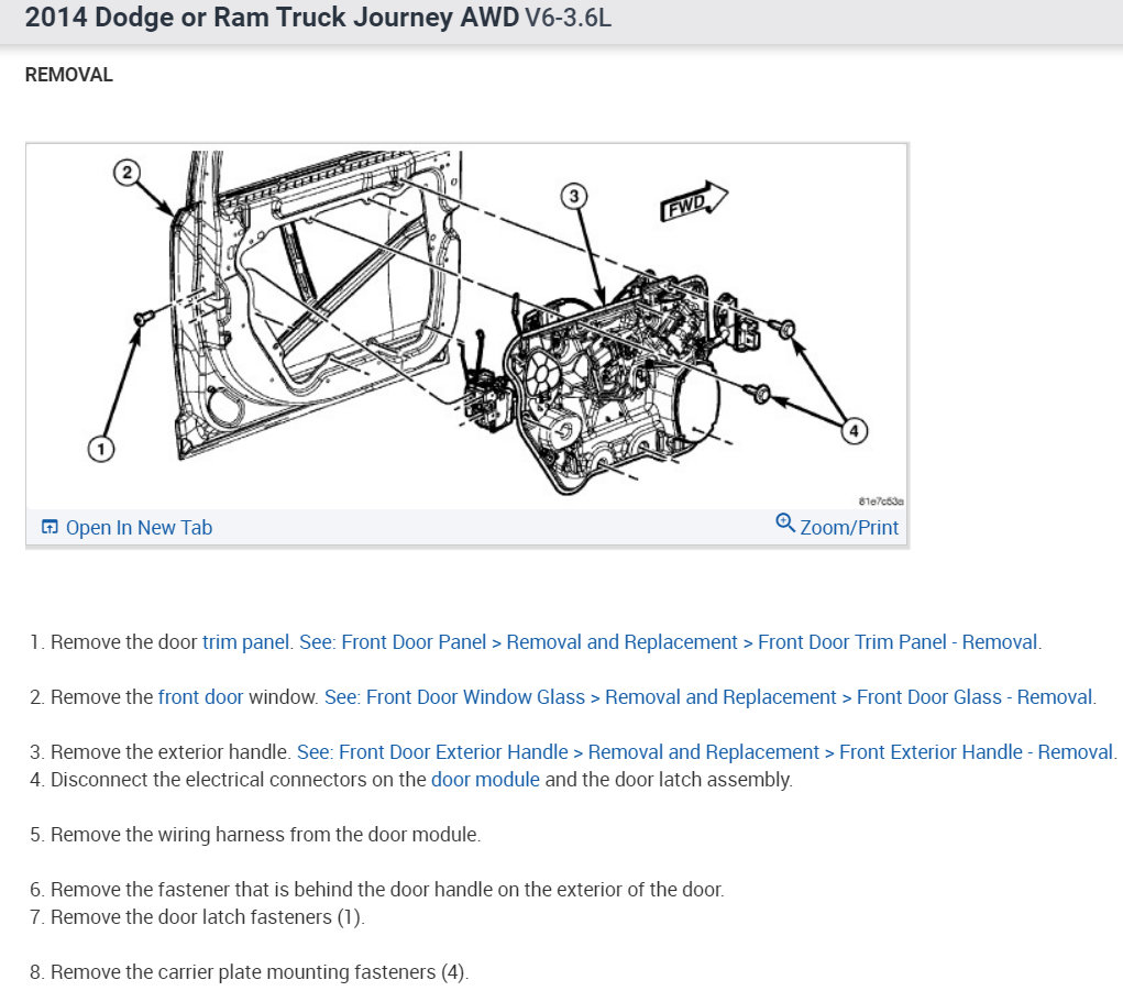

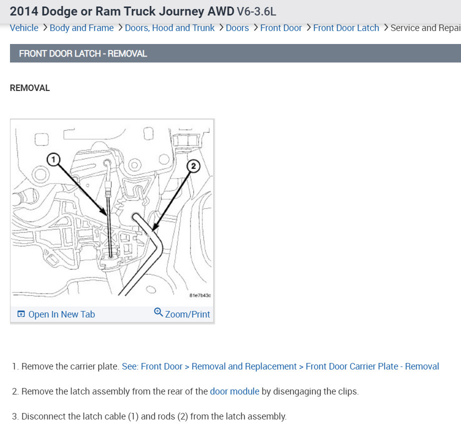

The latch is in the open position. And will not close. This is the answer for the closed position. Unhelpful.
Jul 15, 2022 at 11:34 AM
  • 54,840 POSTS

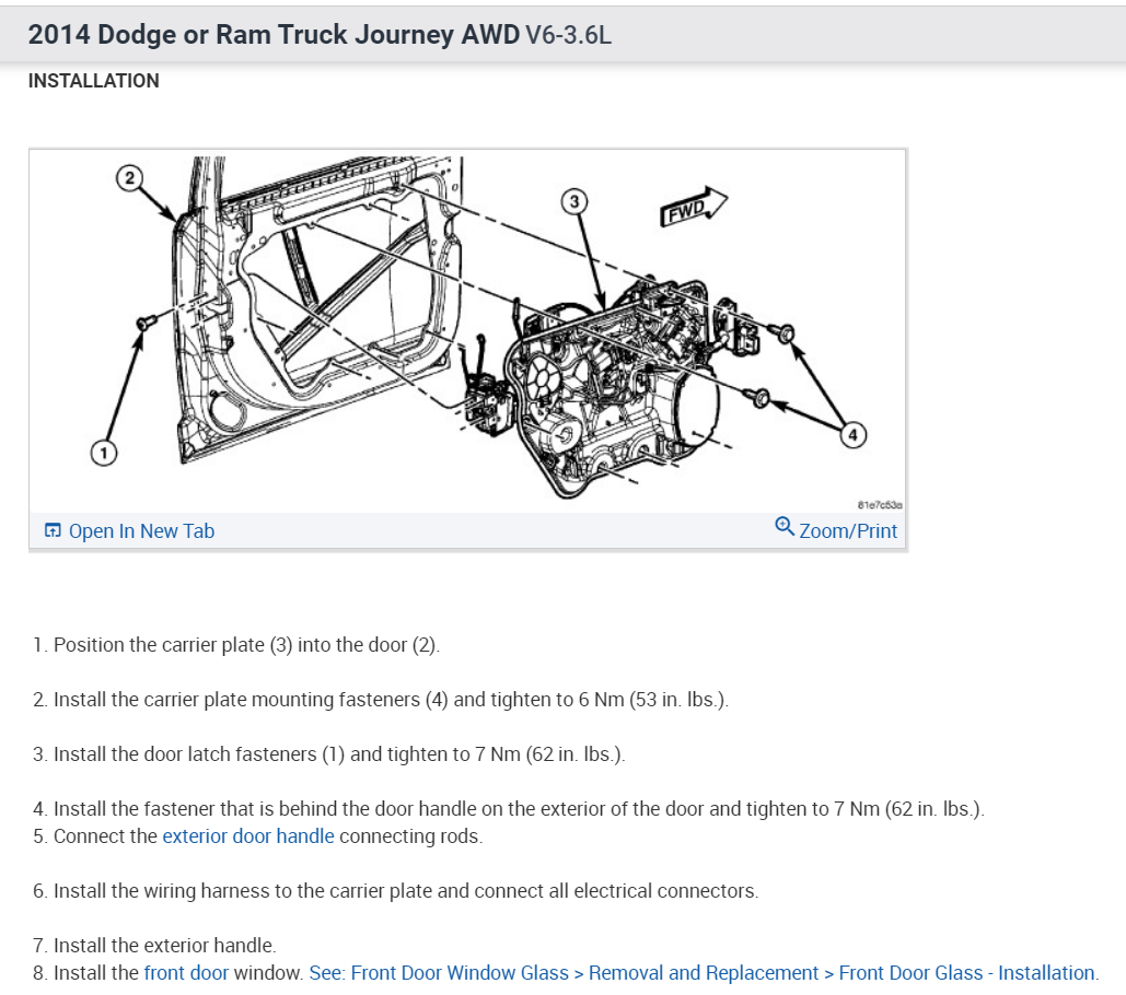

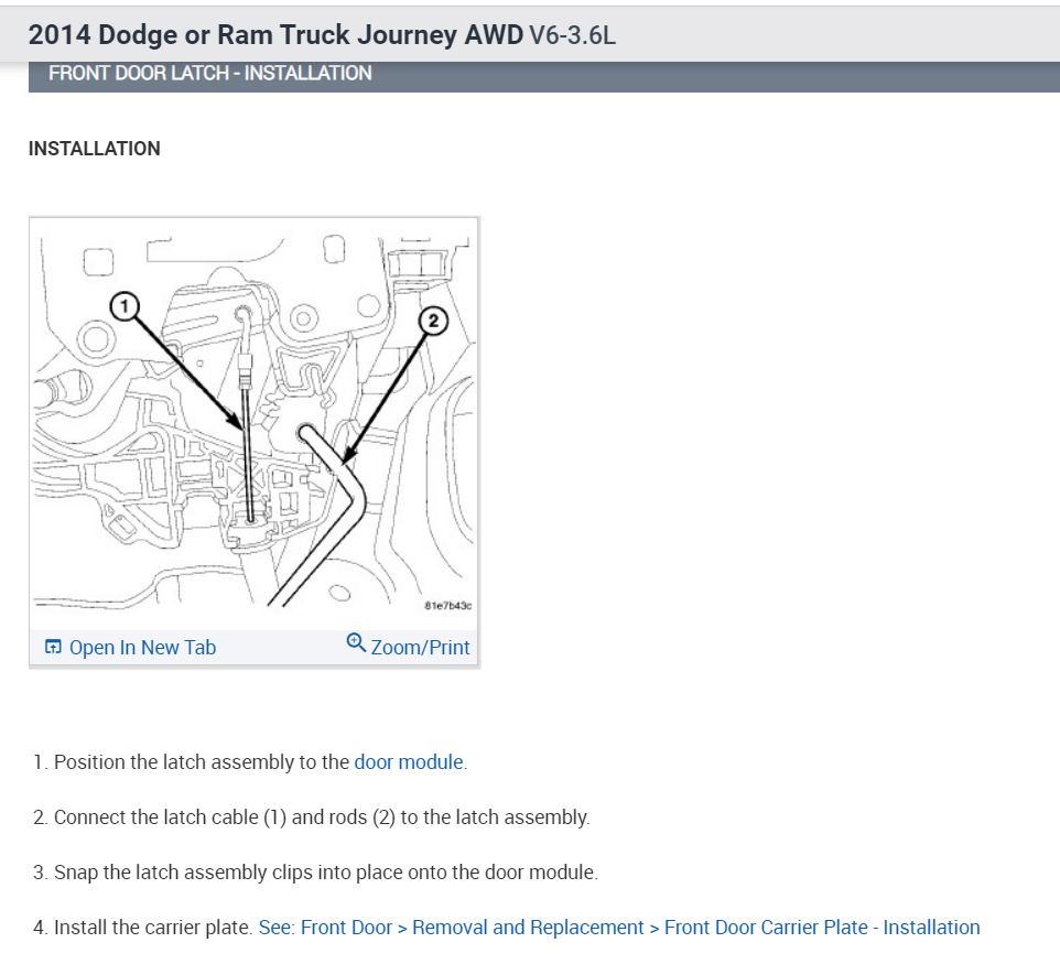

Yep, sorry about that. When the latch is stuck open the latch is bad and needs to be replaced. I have included the instructions on how to do so in the diagrams below. Check out the diagrams (below). Please let us know if you need anything else to get the problem fixed.
