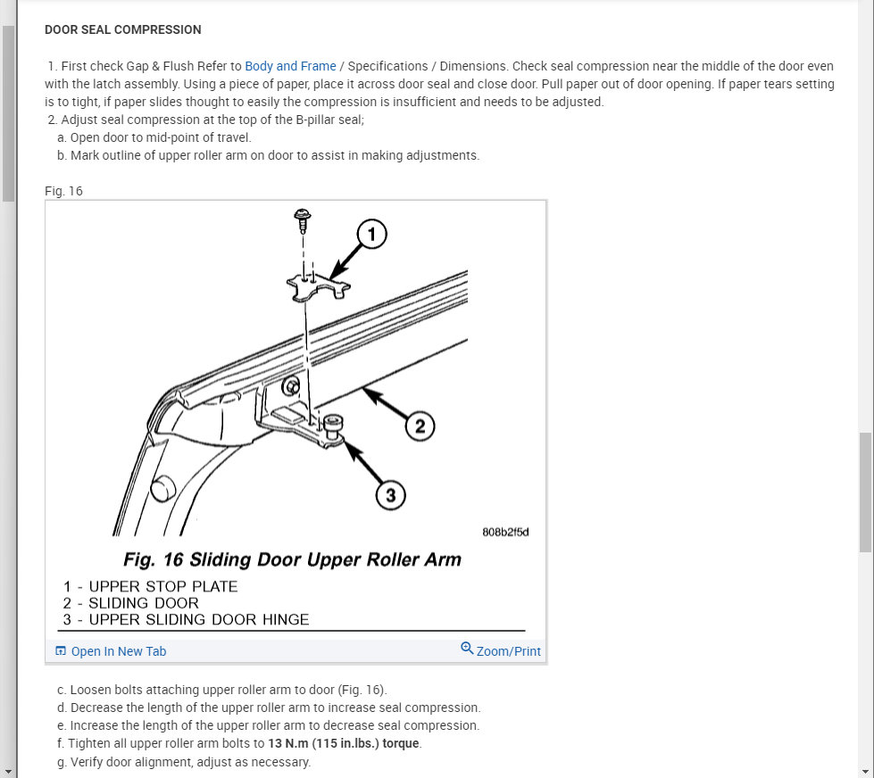

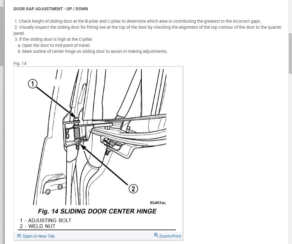

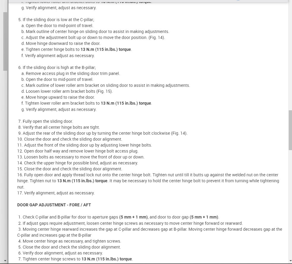

I assume what is happening is the power sliding portion of the door is not operating.
If that is the case, what does it do? Does it not open or does it reverse track when closing?
There are a number of things that can cause these things so maybe get a video of what it is doing and that will help us take the proper next steps.

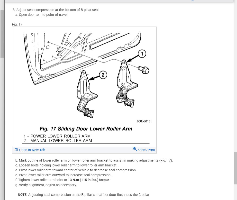

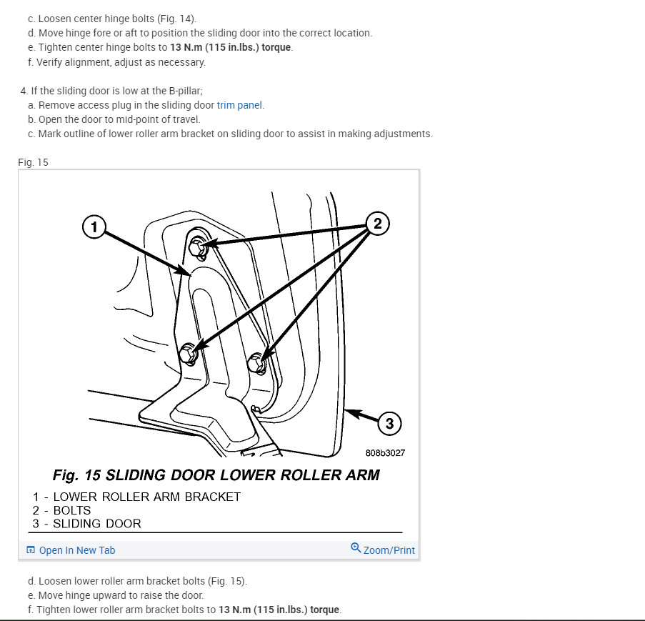

Below you will find all the info on this system including the door adjustment process because that is by far the most likely issue.
If the door is reaching a certain point, then we could have binding and the module is reversing track because it thinks there is an obstruction.
Please run through this material and let us know what happens.
Thanks

Okay. I would suggest going through the alignment procedure above and if that all checks out then you will have to replace the motor and track because the clicking you are hearing is most like the track slipping.
The other likely cause of that is the motor is trying to move the door, but it is jammed but this would also be felt when doing it manually. So, if the door moves freely by hand, then the door is out of alignment, or the track/motor is the issue.

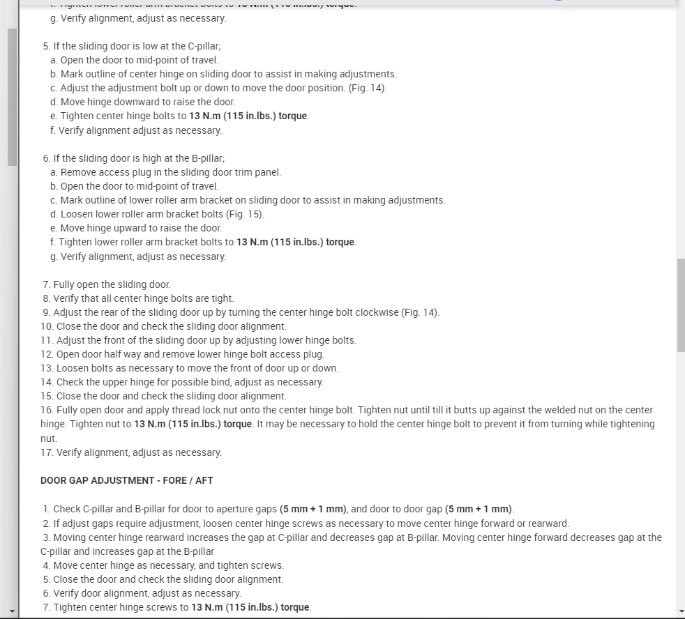

Okay. Is it possible to get a recording of the operation? I think I understand what is happening and if I do then I think you have an alignment issue.
Basically, what happens is the door tries to open but the motor is not strong enough to overcome the drag caused by it being out of alignment.
If you can get a video of this, then we can confirm it, but I would suggest running through the alignment process attached above.

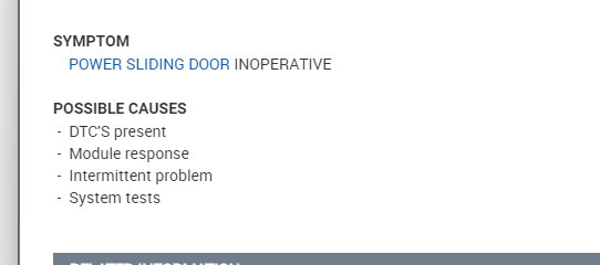

Perfect. So, before we condemn the motor/track we need to make sure there are no codes.
There is a chance that the motor thinks there is something there so it will not open the door, but it will set codes telling us that there is high resistance.
If there are no codes, then we need to suspect the motor is just not capable of moving the door any longer.
Basically, the latch is releasing the door, but the motor is not moving it. It doesn't sound like there is a stripped track as you would hear repeated clicking while the motor is trying to open the door.

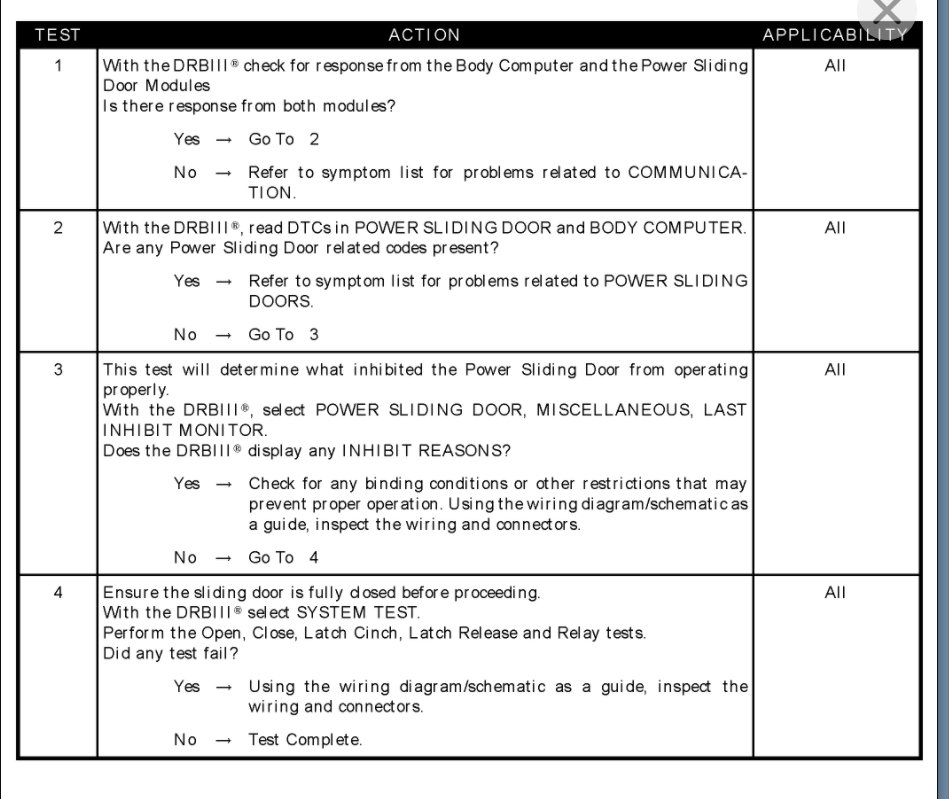

That's what a YouTube said, and he said you got to have a drb3 to check it but there's no one around here that carries that tool.
Dec 25, 2021 at 5:26 PM
DRBIII is the OEM tool. However, most aftermarket tools will pick up these codes as well.
They are called body codes so they will be B codes, but I would just call around and see if any shops have a scan tool that can read body codes out of Chrysler products, and I am sure they can pull the codes.
I am pretty confident that this is the motor, but it would be nice to confirm any codes just in case.

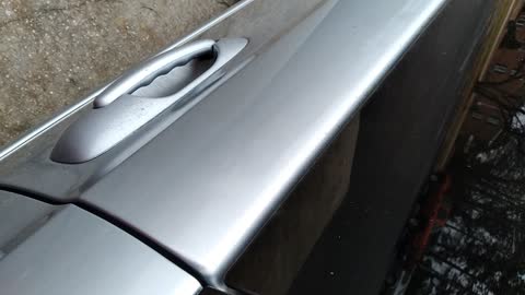

It acts like it's not releasing as it's closed but if I hit the button and pull the outside handle at the same time fast it'll open same as if it's fully open and I hit the button and soon as it's trying, I pull the handle it'll work fine.

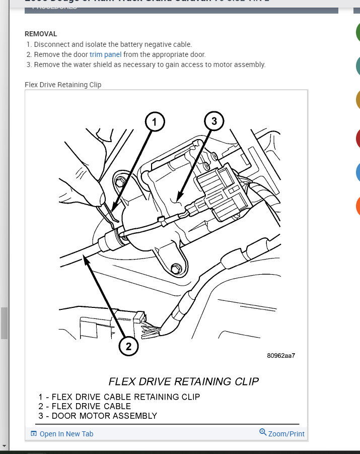

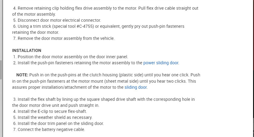

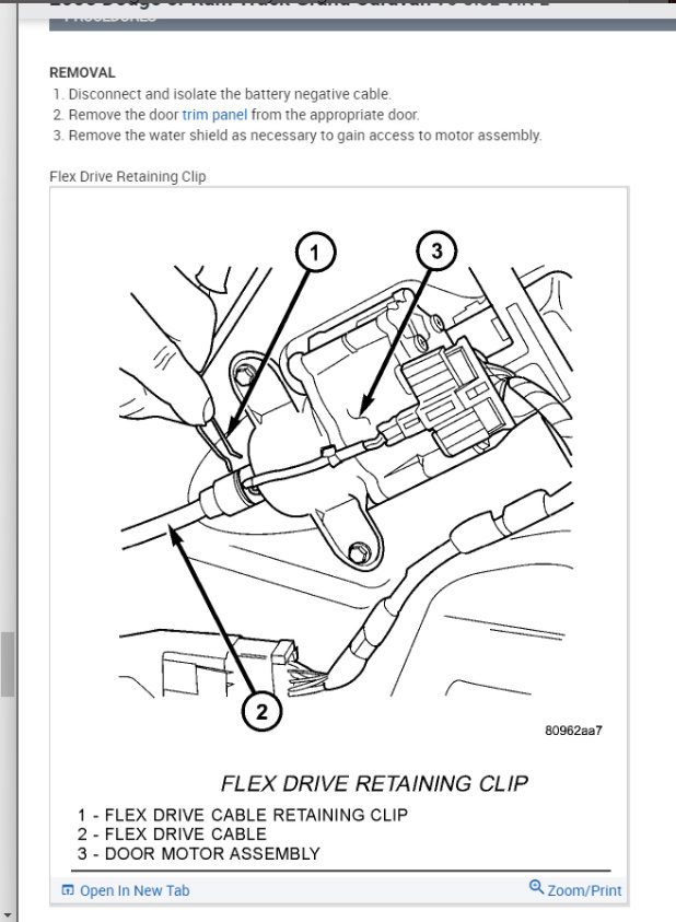

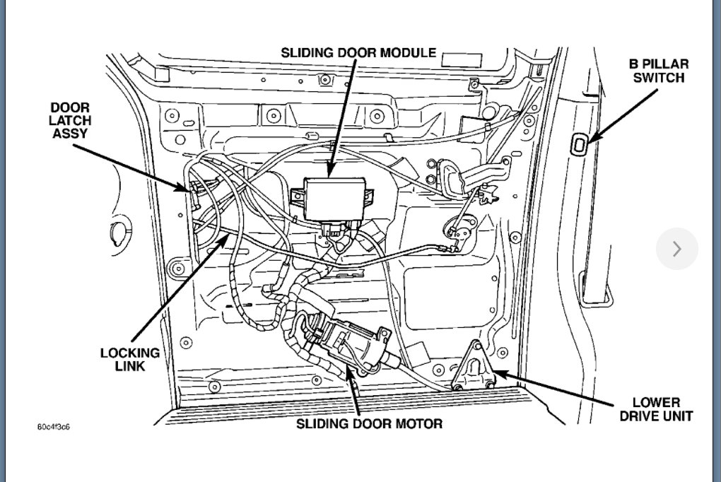

Which motor again? I forgot.
Dec 29, 2021 at 3:59 PM

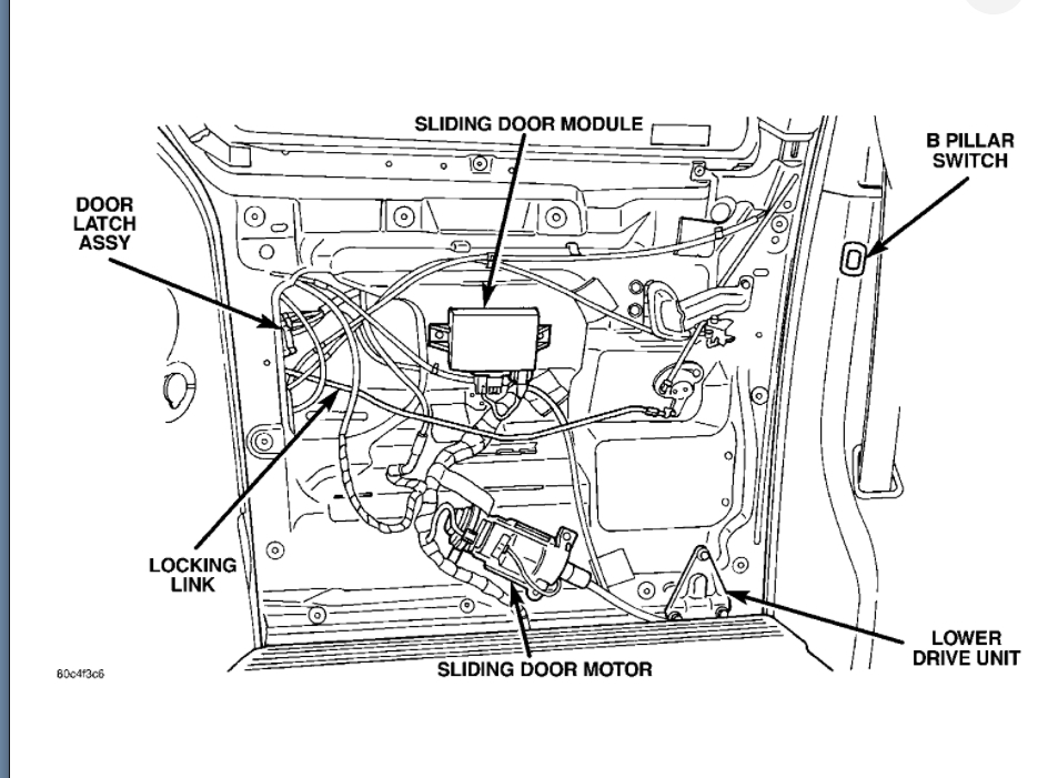

I posted it earlier in the thread, but I will attach it again here to save you from searching for it.
This is the sliding door motor. Basically, it is responsible for moving the door open and closed. It is the common cause of these types of failures. The only times I have seen it not be the issue is when you press the button, and you hear the motor working the entire time like normal, but the door just doesn't move. At that point it is a track issue, but I normally replace the motor at the same time just because you are there.

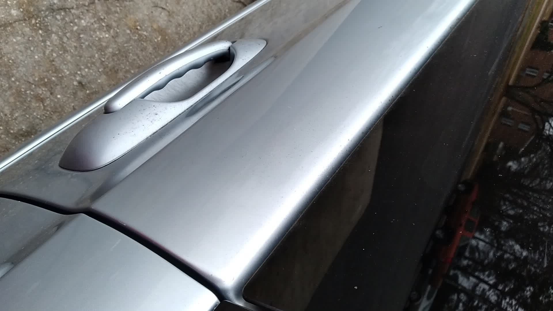

That's what it does when it's closed, I press the button and it acts like it's opening all the way then it moves back and locks itself without door moving.

This is a better video of it. I got closer to it to see if that's what you were talking about.

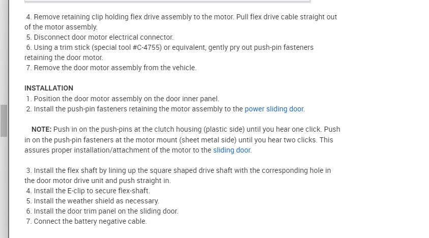

I understand you would like me to be able to tell you exactly what to replace but unfortunately, I am not looking at it to be able to diagnose it.
So, all I can really do is help you make the best decision with the info that you can gather.
If there are no codes and the door does not operate, then the most likely and common cause is the motor.
However, in this video you can hear the motor run for a short time. So clearly it can work which means you need to monitor the control module and see if the motor is just doing what it is told.
Normally this would mean the control module is the issue but with no codes I find that hard to believe.
All this to say that what I suspect is happening is the motor is beginning to fail and will eventually not operate at all. When it does turn on it is not able to move the door, so you get the result that you are getting.
If it were me, I would replace the motor and retest the operation.

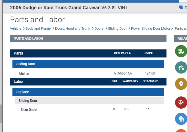

How much is the motor?

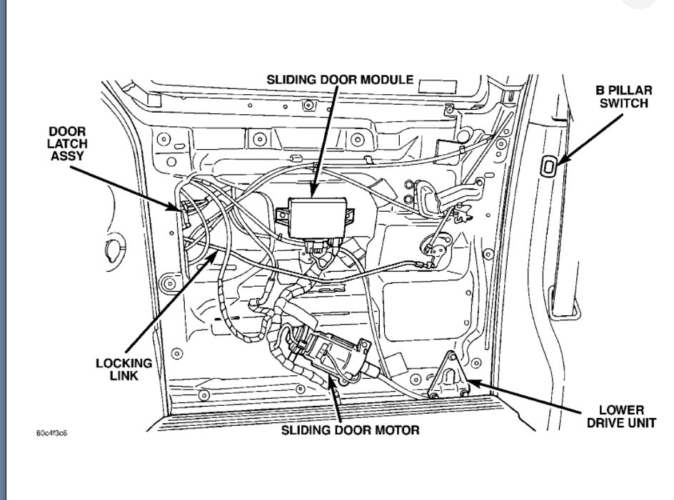

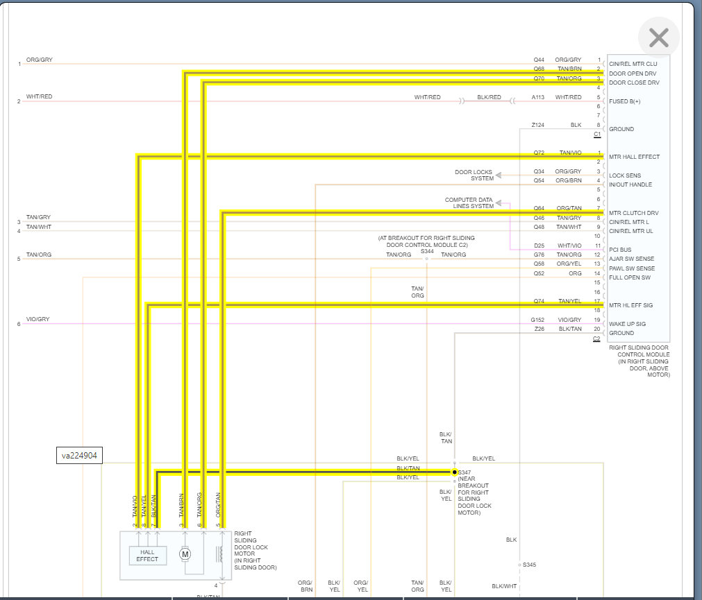

How does the control module get the motor to go?
Dec 31, 2021 at 3:13 PM

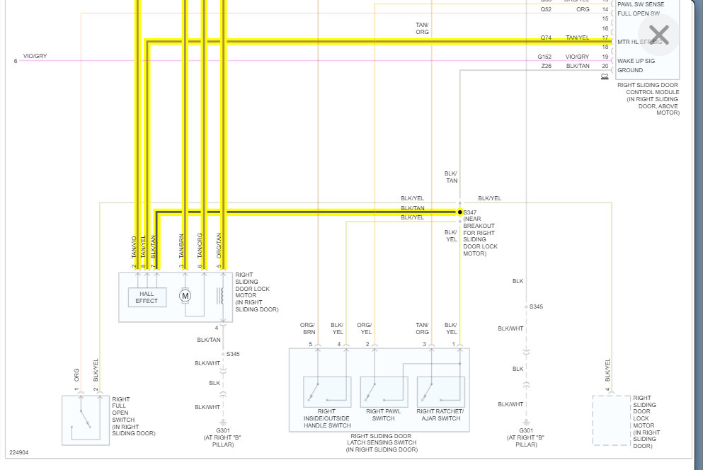

The motor is controlled by the module by different electrical signals. Basically, when the module sends voltage on each different circuit it powers the motor to do what that circuit is meant for.
I am attaching the wiring diagram below if you would like to monitor the voltage signal to the door. What I would suggest is you monitor it on the other door that is operating correctly and if it matches on both doors then the module is fine, and the motor is the issue.
I am also attaching the part number for the sliding door module so you can source a part. The price listed may not be accurate any longer.
Dec 31, 2021 at 3:29 PM
SKOOTER24
  • 275 POSTS
How would I hook a meter up to check? Could I use a volt tester?

  • 275 POSTS
I think I may have found the problem when you open the door all the way until you hear the click that locks the door as soon as you hit the button. I looked to see if that piece was unlocking to let the door unlock to move its clicking but it's not moving to unlock door.

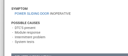

Okay. At this point, I don't think we are going to definitively determine what the issue is if we don't have a scan tool. Basically, the module is responsible for controlling the whole system. It releases the latches and turns the motor on. So, we need to use a scan tool to monitor each portion of the system to see what the module is telling these components to do. If the module shows that it is commanding each to operate, then we can check the voltage to confirm it is actually doing it.
Yes, you would use a meter to back probe each of the wires in the diagram above and then operate the door. We need to see if there is voltage coming from each to confirm if this is a module issue.
So, at this point if the latch is not releasing then you can back probe those wires and find out if there is voltage or not. If there is voltage when you press the button, then the latch could be the issue. However, based on the videos that you showed, I still think this is either the module or the motor.

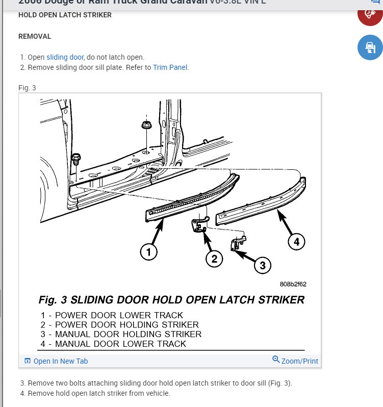

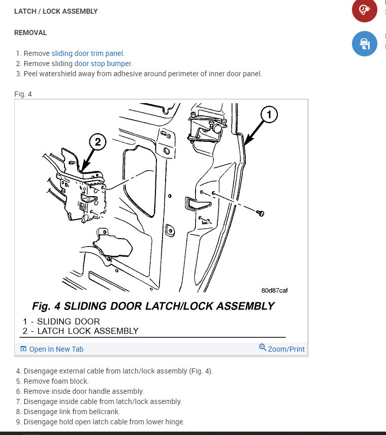

What's that piece called I tried looking it up?
Jan 1, 2022 at 8:04 PM
I would check both the latch and the hold open striker. I attached the info on this below.
Jan 2, 2022 at 10:49 AM
SKOOTER24
  • 275 POSTS
What's the peace that locks into the hold down striker?
Jan 2, 2022 at 11:20 AM
SKOOTER24
  • 275 POSTS
That's where my problem is the part that releases the door and the part when the door is fully open into the lock part. both of them are going bad, I can't find the part though.
