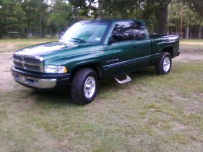

Yes the truck runs great. The TPS was most of the problem. Thank you for all your help

Nice truck. I'm glad it helped. Let us know if you have questions in the future.
