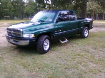

SHANNONE21
  • 7 POSTS
Yes the truck runs great. The TPS was most of the problem. Thank you for all your help

  • 110,241 POSTS
Nice truck. I'm glad it helped. Let us know if you have questions in the future.
