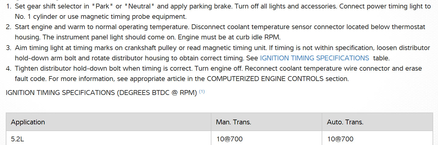

My truck has a 318 engine. I put new cam chain gears in engine, it runs good, but when I put in gear it stalls out.
Wednesday, June 9th, 2021 AT 12:41 PM (Merged)
HMAC300
  • 48,601 POSTS
Check ignition timing and scan for codes and check fuel pressure with a gauge. See picture and see link.
