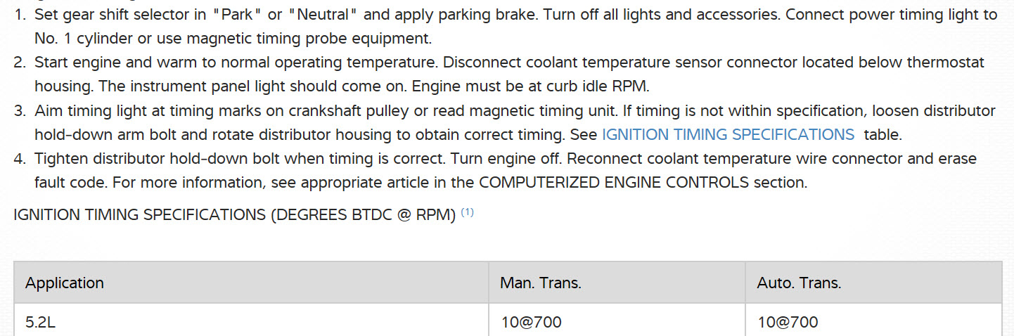

HMAC300
  • 48,601 POSTS
check ignition timing and scan for codes and check fuel pressure with a gauge. See picture and see link.
