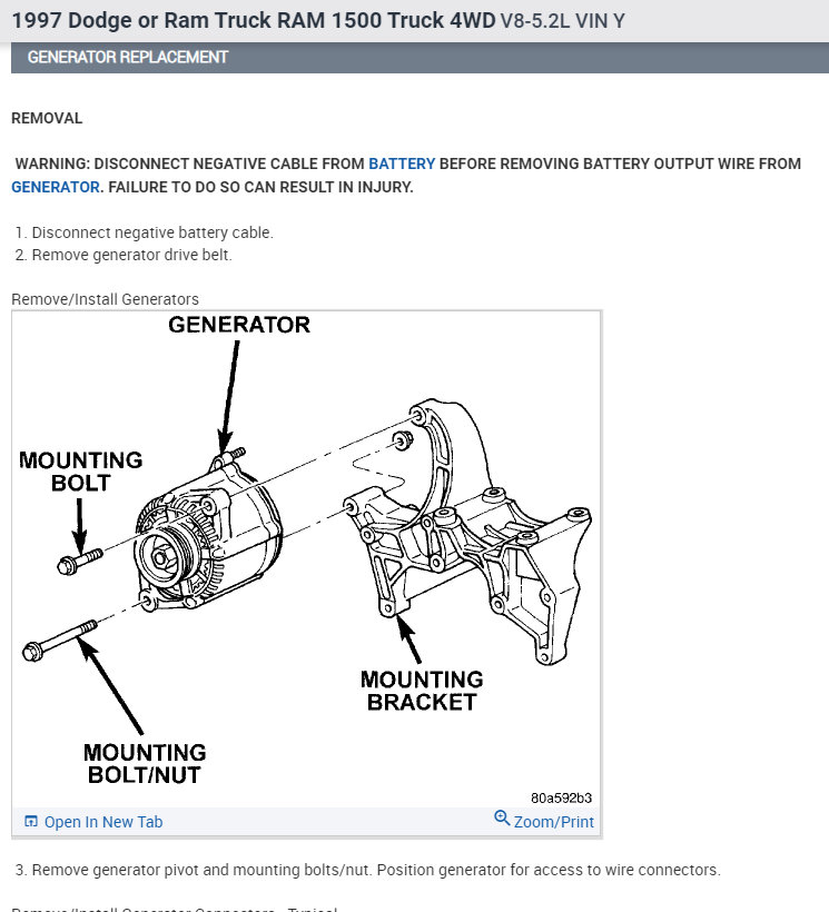

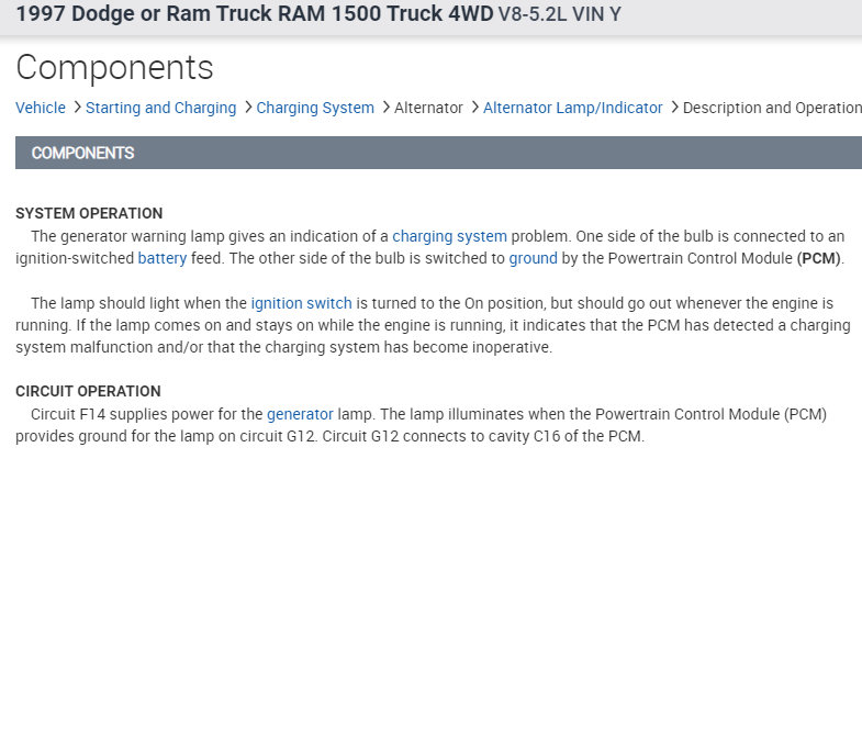

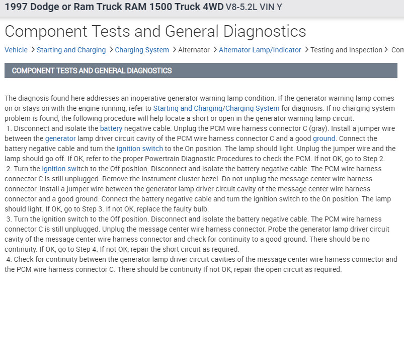

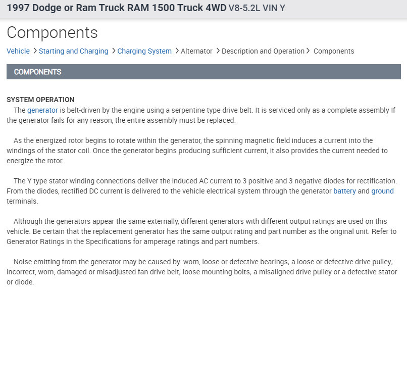

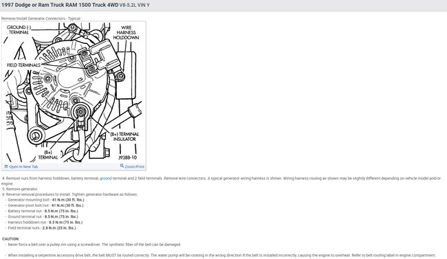

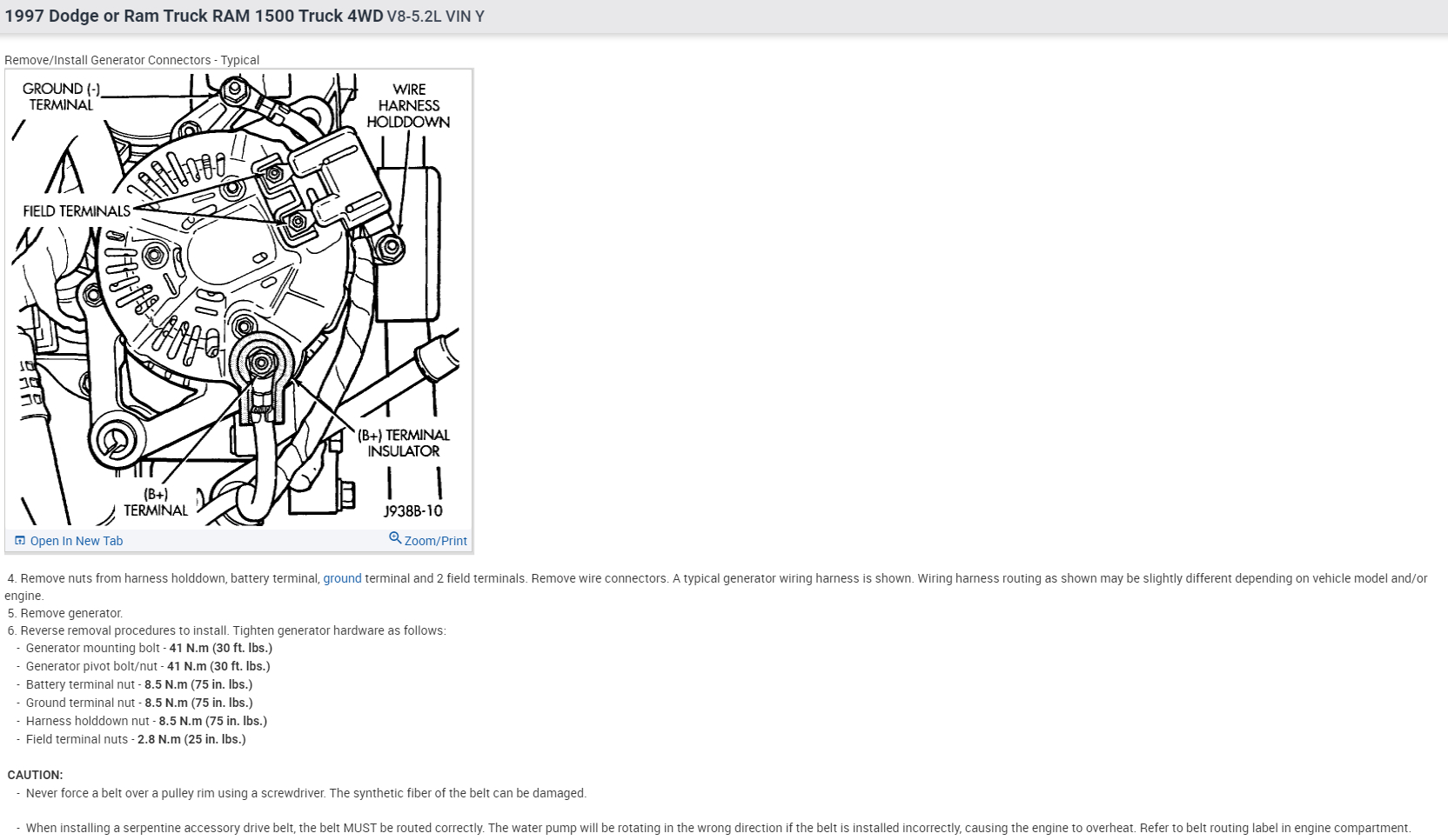

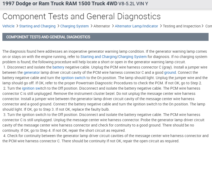

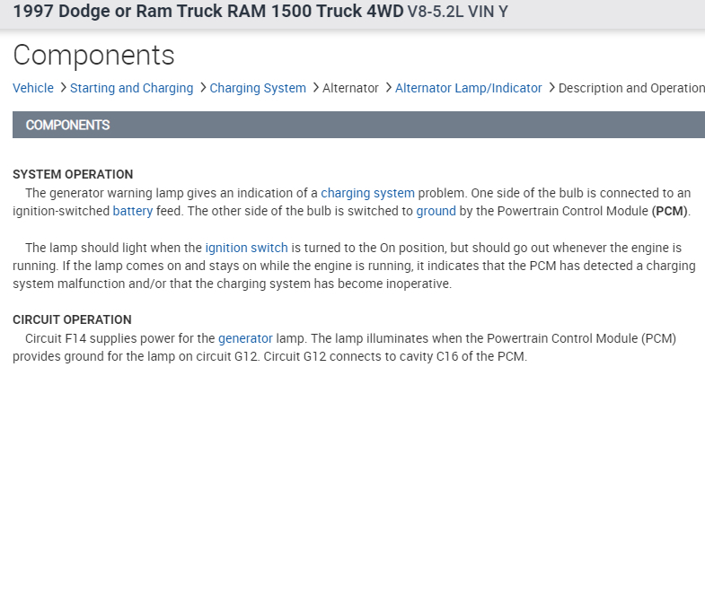

The 'GEN' light refers to the generator/alternator. This light gets triggered when the battery is not getting adequate charge from the alternator.
It could be due to a bad alternator as well as faulty wiring.
First check to see the alternator output to the battery.
Here is a helpful video that shows how to test the alternator:
https://youtu.be/Z-p4dMJUpUw

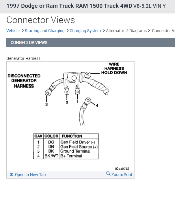

Check for any corrosion on the alternator cable. Look for any water damage or mud being on the connectors of the cable.
Clean if necessary.
