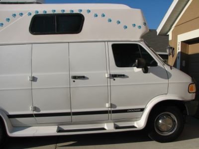

I drive a converted dodge van(converted for grooming), and while out today, the check engine light came on, all monitors read normal, and didn't see or smell any burning, is this something to worry about?
