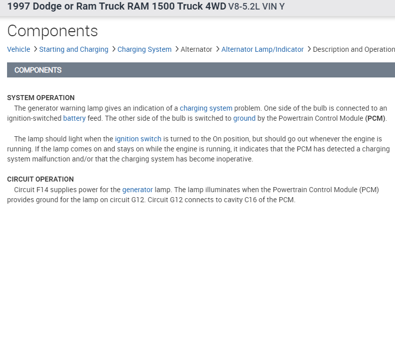

with lights and heater on, it turns the battery light on?
1996 DODGE RAM
17,600 MILES • V8 • 2WD • AUTOMATIC
TRAVIS RAYMO

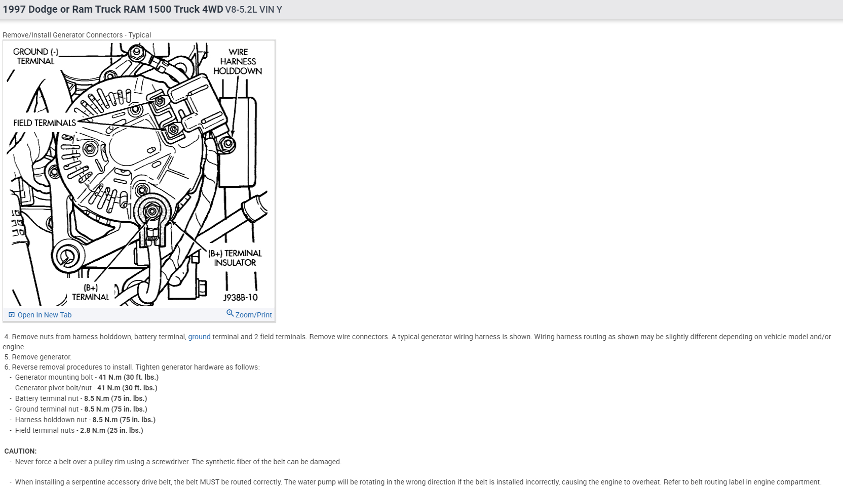

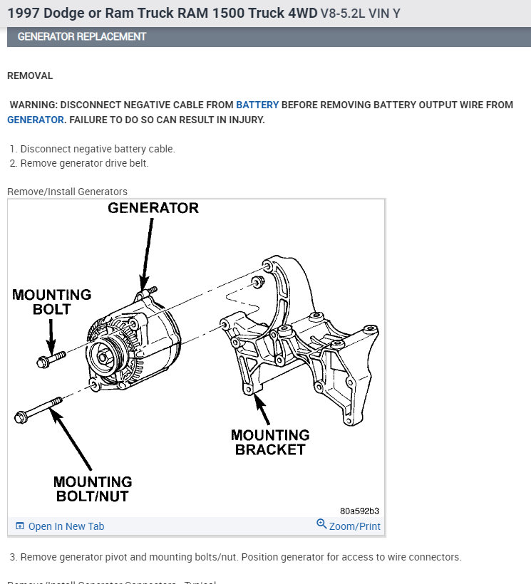

replaced alternator and battery, my gauge in the truck used to go to 14. with both parts replaced, it only goes to 12 now. Why is this? with lights and heater on, it kicks the gen. light on and slowly starts losing its charge?

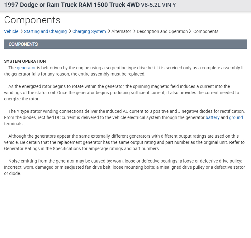

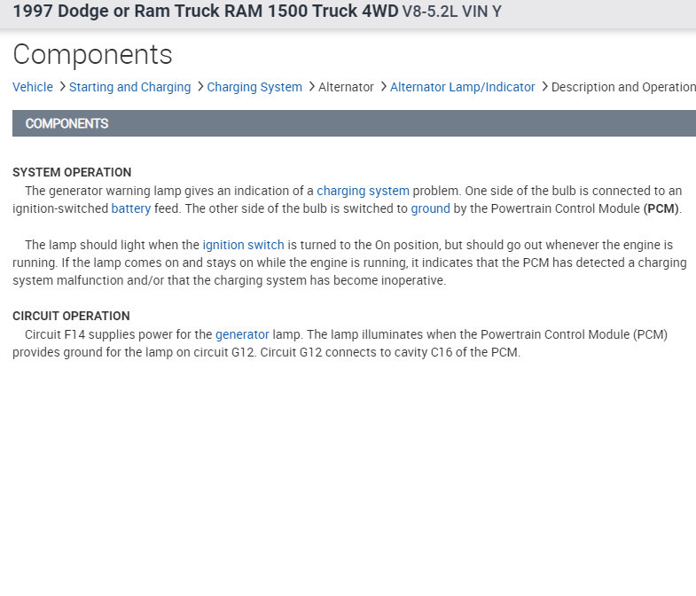

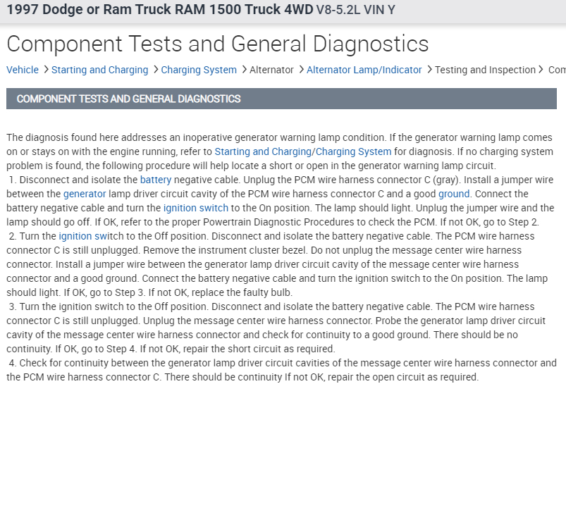

The battery light turns on when the battery is not getting adequate charge from the alternator.
It could be due to a bad alternator as well as faulty wiring.
First check to see the alternator output to the battery.
Here is a helpful video that shows how to test the alternator:
https://youtu.be/Z-p4dMJUpUw

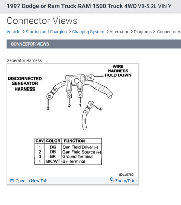

Check for any corrosion on the alternator cable. Clean if necessary.
It is possible to have a defective alternator that is not performing as it is designed to underload.
