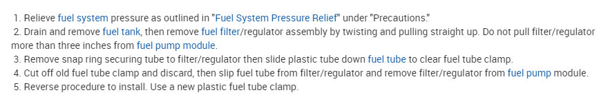

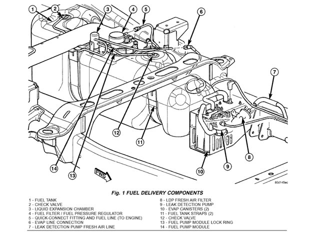

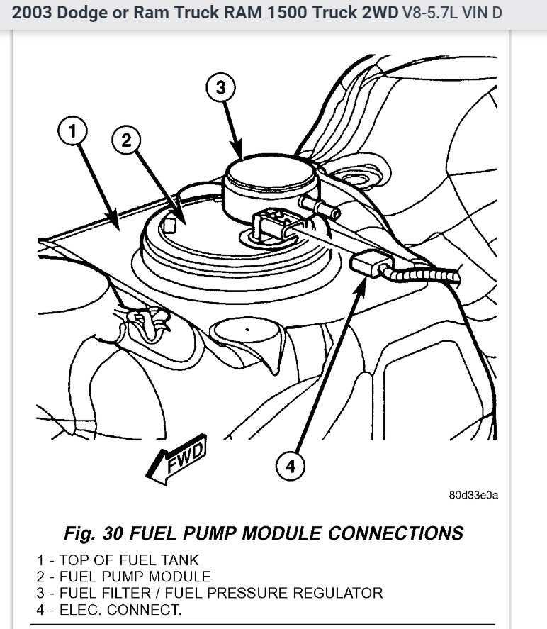

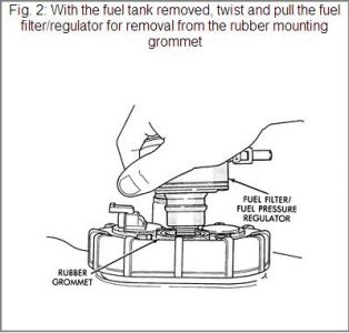

OK, seeing that my truck does not have a fuel filter, what is the black canister that is on the frame rail that seems to have a line-in and line-out from the gas tank. I am getting a fuel smell coming from this.
Feb 18, 2010 at 9:26 PM
  • 110,245 POSTS

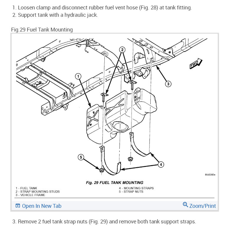

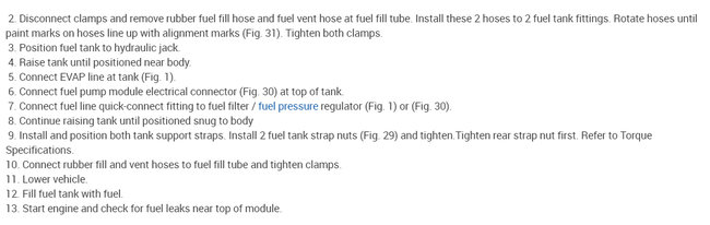

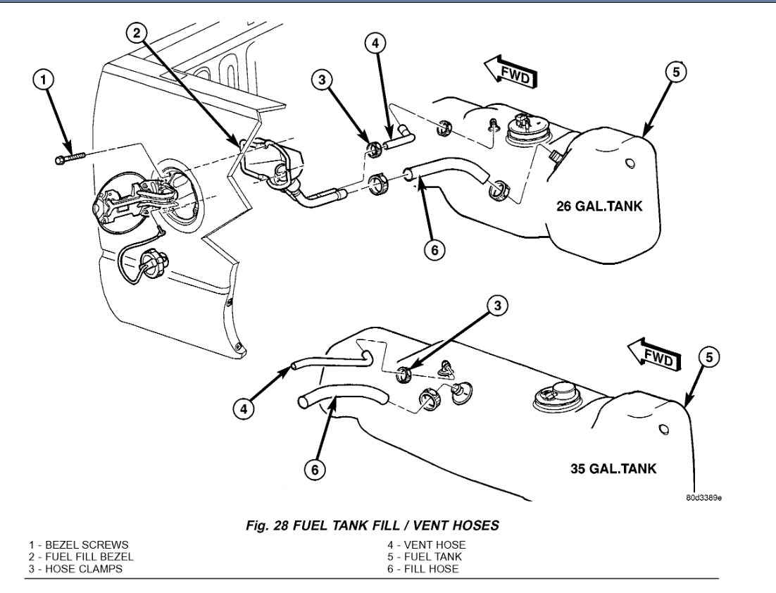

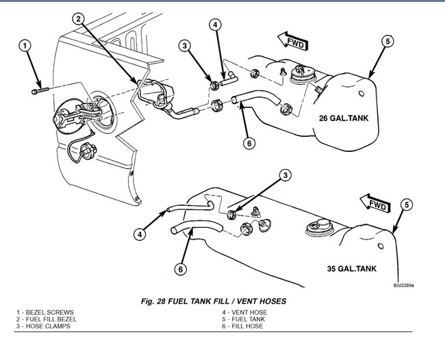

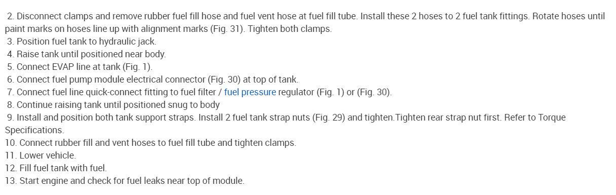

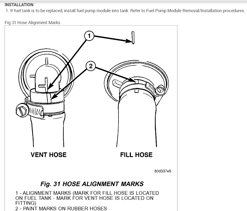

You do have a filter, but you need to remove the fuel tank to replace it. Here are the instruction to do so in the diagrams below with a guide to help walk you through the repair.
https://www.2carpros.com/articles/how-to-change-a-fuel-filter
Feb 19, 2010 at 1:43 AM

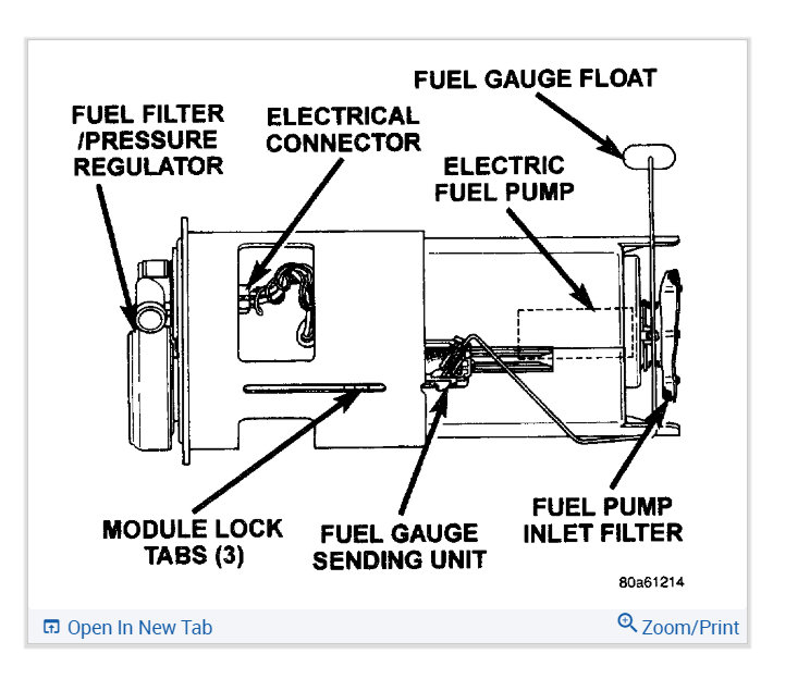

It is on top of the fuel tank. It is part of the regulator. Here is a picture of it.
https://images.2carpros.com/forum/automotive_pictures/249084_fuel_filter_1.jpg
Let me know if this helps. Joe

Welcome, my info says it is mounted on top of fuel pump module, the module in the gas tank.

I believe the pressure regulator and filter are on top of the pump assembly. The regulator and filter may be one assemble, the parts book shows it is replaceable.
I'd check fuel pressure before I did anything.

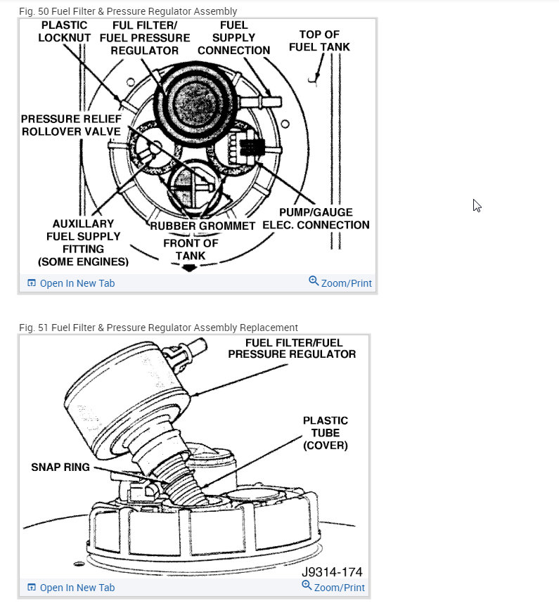

The filter is part of the fuel pump module. I included the process to replace it. Unfortunatley you need to drop the tank.
This does sounds like a fuel issue and I suspect the fuel you put in at some point was "dirty" or the container it was in had some contamination. If this is the case, you will need to drain the tank and replace the pump but I would make sure you clean out the tank as well.

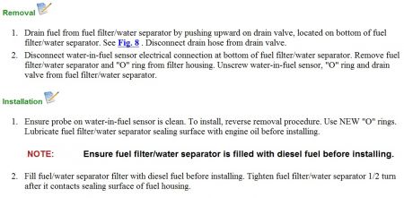

Is it difficult to change the fuel filter on 1996 Dodge 3500...cummins diesel
Aug 27, 2020 at 5:10 AM (Merged)
INTERNETMECHANIC
  • 700 POSTS
The procedure looks straight forward to me.
https://images.2carpros.com/forum/automotive_pictures/512072_ram_diesel_fuel_filter_1.jpg

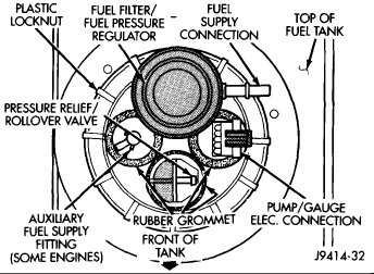

JDL
  • 16,098 POSTS
Welcome, the filter is part of regulator assembly, sits on top of fuel pump module.
https://images.2carpros.com/forum/automotive_pictures/170934_dodge_fuel_filter_1.jpg

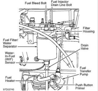

Where is the fuel filter on my Dodge 3500 Ram diesel engine?
JDL
  • 16,098 POSTS
Welcome to the forum, underhood driver side of engine.
https://images.2carpros.com/forum/automotive_pictures/170934_diesel_fuel_filter_1.jpg

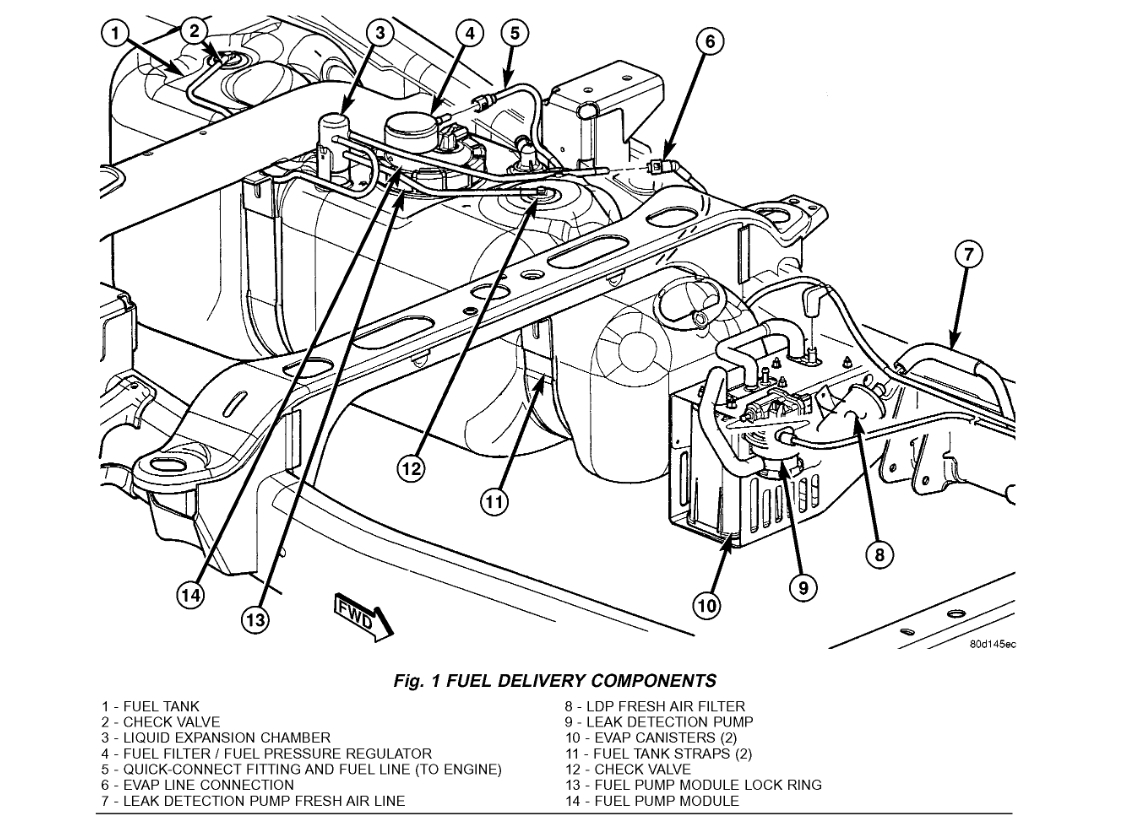

  • 75,988 POSTS
1996 Dodge Truck RAM 1500 Van V8-318 5.2L Magnum Fig. 1 Top View Fuel Pump Module - Gas Powered Engines - Typical
https://images.2carpros.com/forum/automotive_pictures/12900_fuelfit_1.gif
A combination fuel filter and fuel pressure regulator is pressed into a rubber grommet located on the top of the fuel pump module. A separate frame mounted fuel filter is not used.
