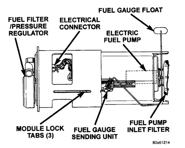

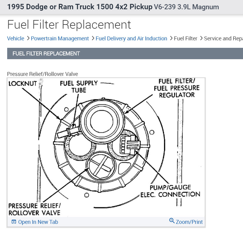

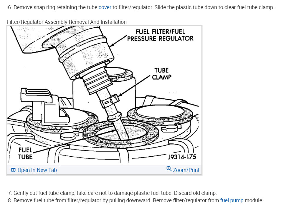

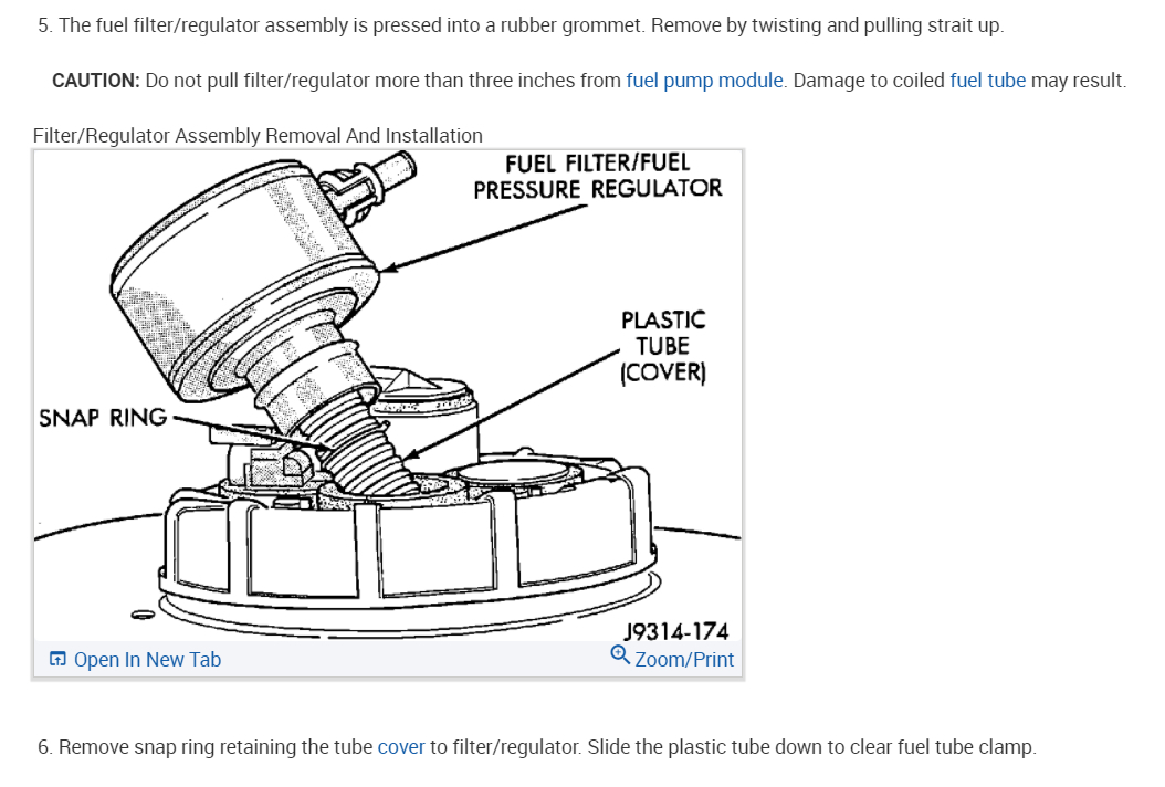

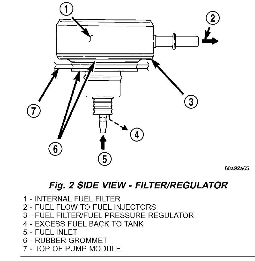

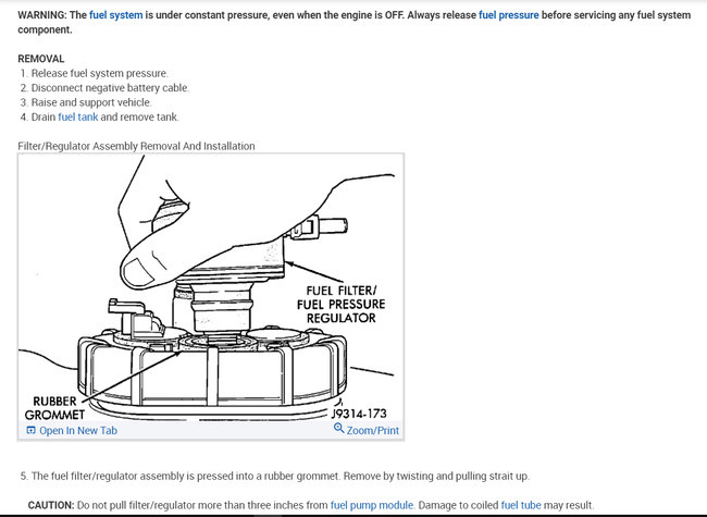

Fuel filter is part of the tank unit in these, not really a serviceable item like ones in the past. Would have to drop the fuel tank out to get to it.
I would start with a fuel pressure test and a scan to see if the computer has any codes
See the guides below, they will help you figure this out
https://www.2carpros.com/articles/engine-hesitates
Attached below is a couple pictures of the fuel tank unit, so you can see the filter
