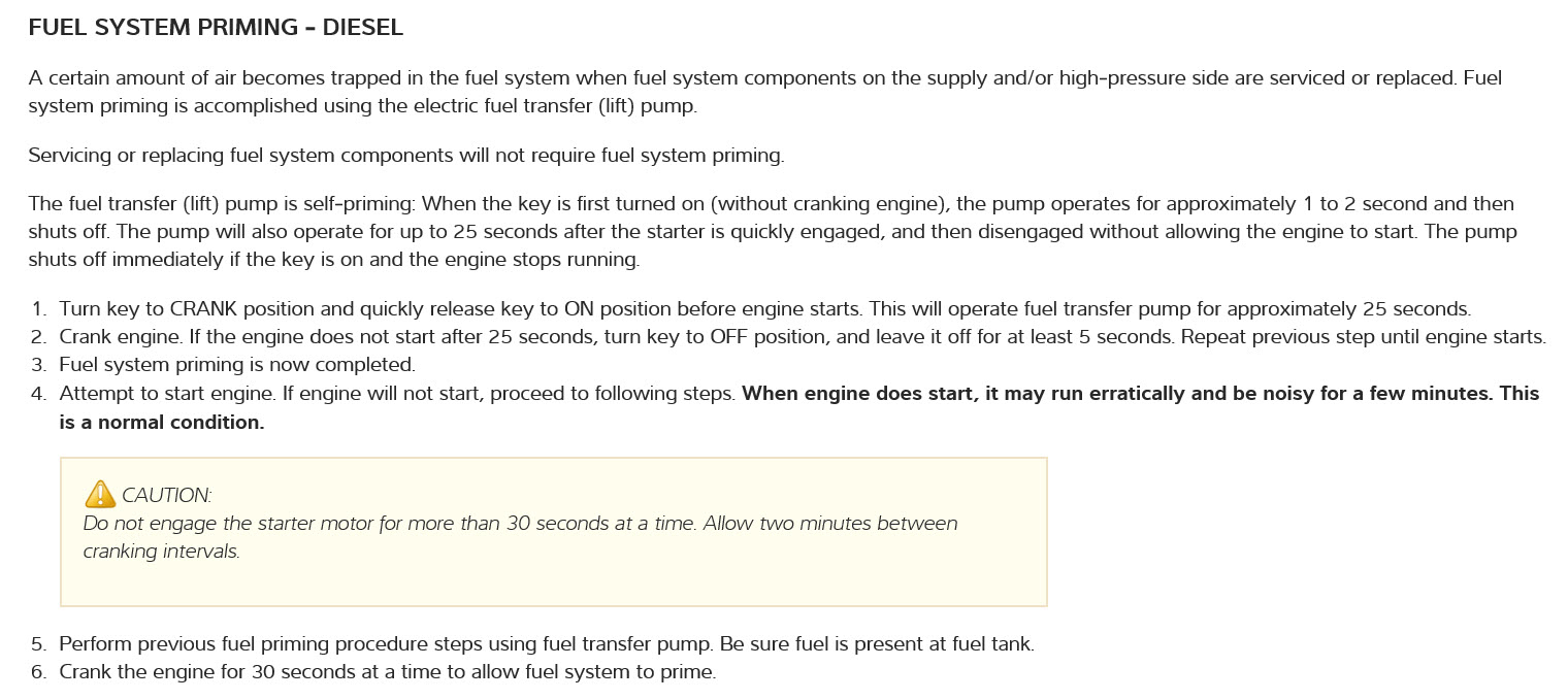

I watched your video on how to change the fuel filters on a 2015 2500 Ram with a Cummins diesel. One of the last things you did was turn the key to engage the fuel pumps in order to take the air out of the system. My truck has a push button start so my question is do I take it to the "Accessory" or "Run" indicator in order to make this happen?
Thanks.

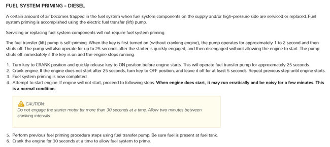

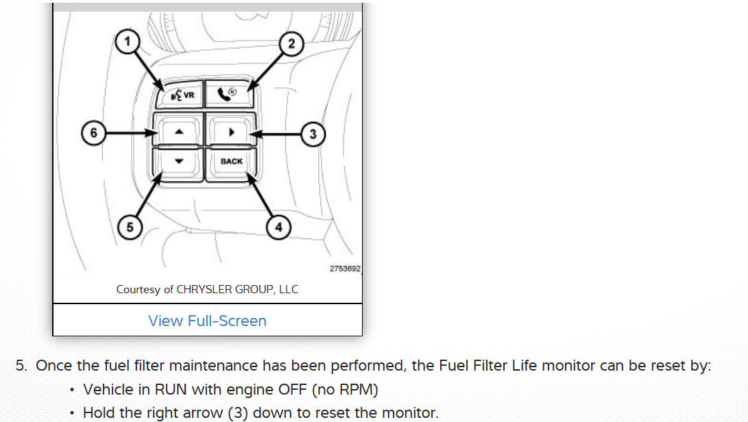

see pictures on how to prime system. I am assuming it is filter one you are replacing.
