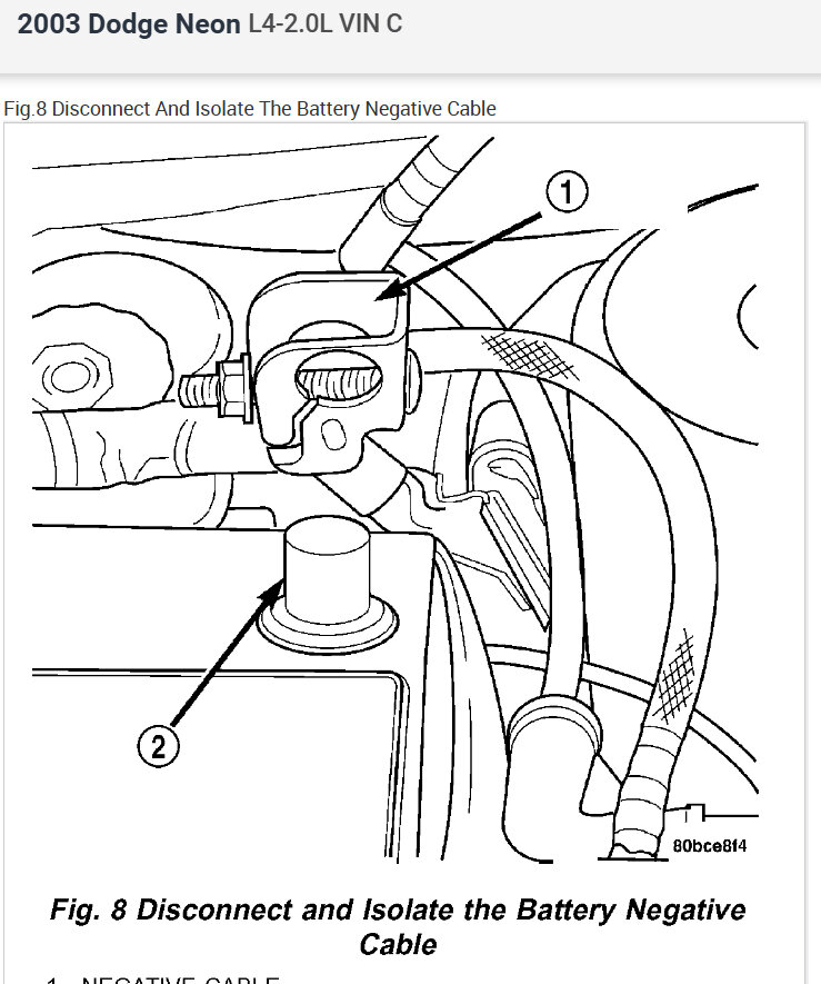

Yep, it sounds like the battery is weak and needs to be replaced, but this video can help confirm the issue as well
https://www.youtube.com/watch?v=6YRW8fyNudY&t=35s

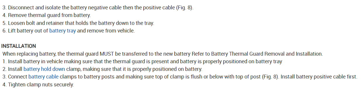

Here is how to change the battery out in case you need it. Check out the images (below). Please let us know what happens.
