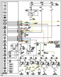

the fisrt problem I got was the seatbelt light flashing, then the speedodometer started working erratically then stopped working . then the temp guage stopped working followed by the rest of the cluster
every one them just flashes including the overhead light. so I have to remove # 11 fuse.

Sounds like the inst. cluster driver has gone bad. Most often the repair is to replace the cluster. You should be able to find a used one if you search around.
https://images.2carpros.com/forum/automotive_pictures/248092_neon_inst_cluster_1.jpg
A diagram with this much detail usually doesn't post well. If it will help any, with your email address, I can send you a PDH.
