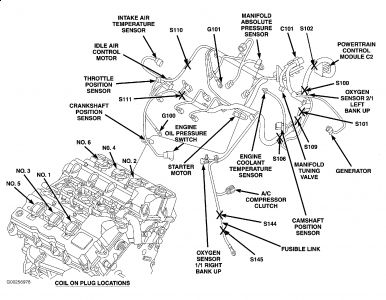

Are you still refering to the cam position sensor? I thought you replaced that. If not, is the engine a 2.7 V6? They were in nearly 85% of the vehicles. The camshaft position sensor is mounted to the top of the timing case cover. The bottom of the sensor is positioned above the left camshaft sprocket. Here is a picture of the wiring harness and engine:
https://images.2carpros.com/forum/automotive_pictures/249084_cam_1.jpg
Let me know if this is for the right engine and if it helps. Joe
Jan 13, 2010 at 11:05 AM
MYCAREATSMONEY
Yup, still referring the cam position sensor. Travelzoo replaced his. Me - not yet!
It is a 2.7 V6.
I found it in my car, pulled it out (is there supposed to be oil all over the sensor?) and put it back in causing the malfunction light to go off.
However, I still plan on putting in a new sensor -- but every sensor I see at a parts store is just a little bit smaller / shaped just a little differently than the one in my car (they are for the right year, make, model, engine at the store). Maybe it is an after factory update?
Thanks!!
