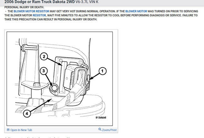

My blower motor does not work. I have removed the motor and jumped it to the battery and it works fine. All the fuses checked out ok. I also checked the wiring harness plug which has power. I am assuming that the switch grounds the hot lead to the motor. Could it be the switch or a resistor that may not be functioning properly? I don't have a wiring diagram to see where the resistor would be. Would anyone know where it might be located?

Check to see if you have power to the blower motor resistor. If you do, replace the resistor. If you don't, check the switch for power in and out. If there is power in and not out, replace the switch. Here is a guide to help you step by step with instructions in the diagrams below to show you how on your car.

I cannot find the resistor to check it. Would you know where it is? With the plug on the blower motor having power, is it a grounding circuit that runs thru the switch and resistor?

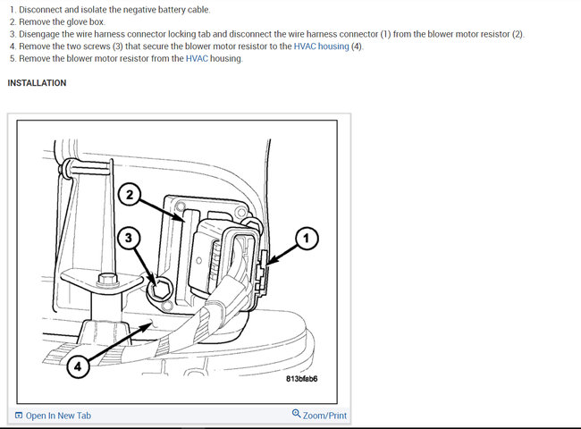

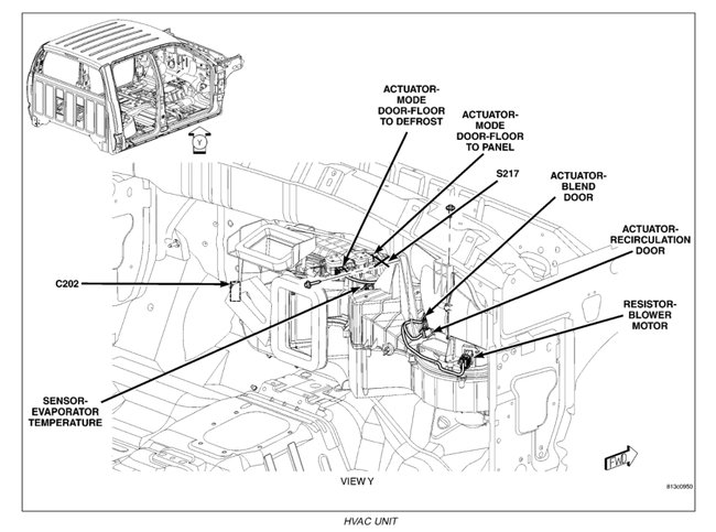

Yes, the resister is between the motor and the switch. I just looked it up in the manual and the resister is on the passanger side interior under the dash. It is attached to the right side of the HVAC unit. If your not geting a ground through the wiring harness and have to run a seperate ground, the resister is the problem. Keep in mind, the switch redirects the 12 volts to different areas of the resister. Thus the resister is responsible for how much power the motor gets. See if you can find it. I think that is your problem.

Joe, Thanks for all of your help. I finally found the resistor, replaced it and now everything is working fine. It's the somewhat simple things in life that make you happy. Having heat again is one of those simple things. Your persistence and expertise is unparalleled and beats going to a repair station just to pay a lot of money to find a simple solution.

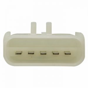

The blower motor resistor wiring pigtail melted onto the resistor. I purchased a repair kit for the pigtail. It was a universal repair kit and has 3 wire sets. I used the set that appeared to be the same guage wire as the original wires.
Now the blower fan blows low on the low(1)and low/med(2) setting and medium on the med/high(3) and high(4) setting.
I plan on purchasing another resistor to see if that is the problem but also would like your opinion.

Bolted to the heater box, near the fan, usually with a pair of 5/16" bolts.

The heater resistor card is located right under the glove box lower front left right over your left foot if you sit in the passenger seat you should see a 4 wire plugged into it. you need to remove 2 screws with a 1/4inch socket and you will have your resistor...

It should be located on the heater box. Here is a picture of what you are looking for:

I'm having a short problem in the wiring harness at the plug it's burning the plug out in already replaced the resistor and put a pig tail on to replace the burnt out plug because the first time it had looked like a wire had been pulled out somehow and it shorted but now it's done the same thing is there any way if yall have it I can get a wiring digram or yall can tell me what the dark blue wire with a yellow stripe leads to so I can figure out what is causing this. No fuses have been blown so I don't know what could be causing this.

Okay, that must be what it is. If it is melting again, chances are the blower motor itself is drawing too many amps and causing the wiring to heat up. Other than that, a poor connection can cause excessive heat. Make sure everything is clean and tight. However, my guess is the blower motor.

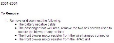

JDL
  • 16,098 POSTS

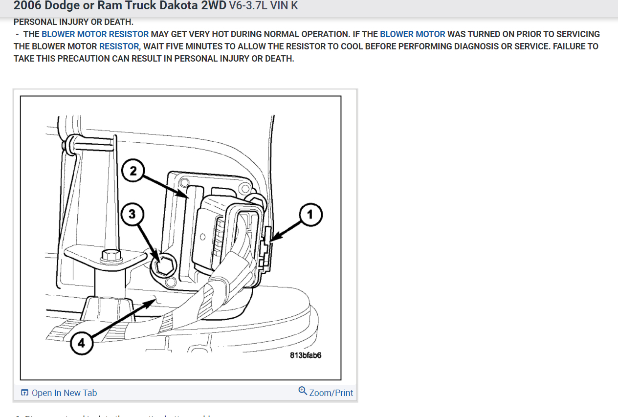

https://images.2carpros.com/forum/automotive_pictures/170934_dodge_blower_resistor_1.jpg
Yes, although the high speed doesn't use a resistor, it's wired through that assembly. The resistor assembly is on the ground side of the blower motor, I can't rule out the heater control.
Jan 18, 2021 at 1:27 AM (Merged)
TIMSIT
  • 11 POSTS
do you have an image of the spot or part to replace?
JDL
  • 16,098 POSTS
Hello, the procedure was changed from 2000 to 2001. I have a procedural picture for 2000 but not 2001.
https://images.2carpros.com/forum/automotive_pictures/170934_blower_resistor_3.jpg
According to the partsbook, the resistor looks like the above picture.

Yes behind glove box can remove box to access just left of motor in air plenum. No need to pull dash. What is problem high speed only?
