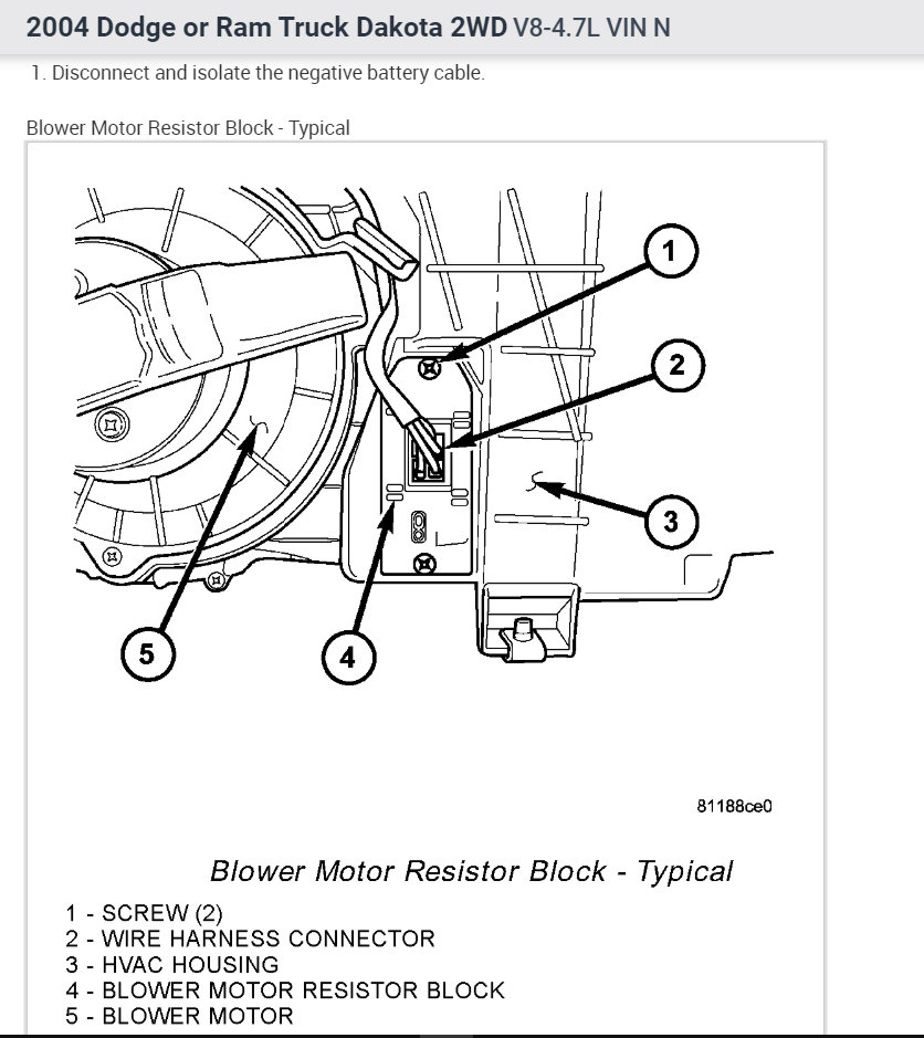

it sounds like the speed control resistor is out here is the location so you can check it out. It is right next to the blower motor. Check out the diagrams (Below). Please let us know what happens.

BLUELIGHTNIN6
  • 16,542 POSTS
check fuses and blower motor relay. if both OK suspect faulty blower motor resistor

SHORTCHANGE15401
My blower for the climate control has quit working. I took out the blower motor and tested it with the battery and it works so the problem must be somewhere else. I also checked the fuses and they are ok. Where should I look next and how do I test it?
Dec 1, 2020 at 12:11 PM (Merged)
  • 110,194 POSTS
Most common problem is the blower motor resister. That is where I would check next.
