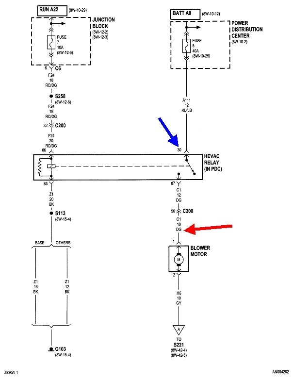

BRANDON FLORES
Hello. I bought the truck used last year. I replaced the blower motor, resistor, and control unit. A/C compressor turns on and off, mode doors work you can hear them rotate. I have checked fuses and relays, swapped some around and nothing. I need help please.

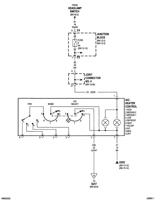

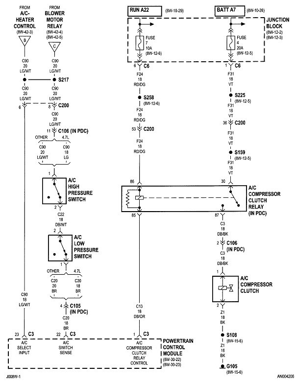

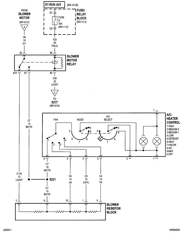

CARADIODOC
  • 34,367 POSTS
First check if you have 12 volts on the dark green wire to the fan motor. If you do not, check for it on terminal 30 of the relay.
These diagrams are for the heater with AC. If you have just the heater system, I'll prepare different diagrams for you.
If you have 12 volts on the dark green wire, check also on the gray wire. That has to be done with the connector plugged in. The weakest link in the chain is the fan speed switch. It's common to find the connector terminals burned and melted, especially if the fan is used on the highest speed often. This is a good suspect if you have 12 volts on the gray wire.

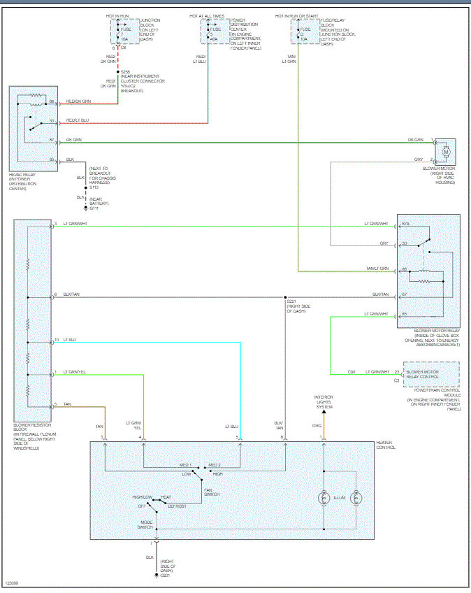

  • 110,240 POSTS
In addition to checking fuses, have you confirmed there is power to them and the relays?
I attached a pic below which is the wiring schematic for the blower motor and HVAC system. Take a look at it and see if you touched on the relays, resister, and all fuses related. Also, check to make sure there is power at the fuse locations.

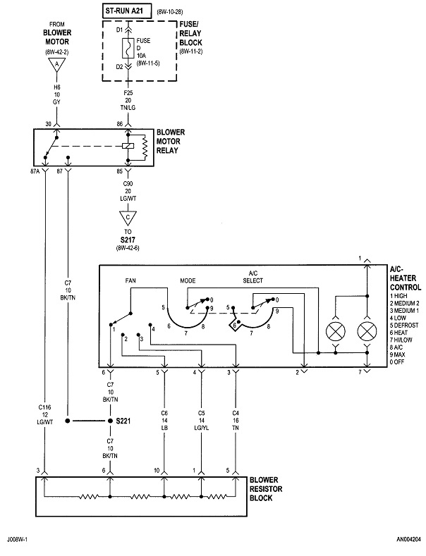

CVN65
  • 6 POSTS
I turn the heater/AC switch to the on position and nothing happens (car running), the blower does not come on. I checked the fuse and is ok. Any suggestions? Thanks
Dec 1, 2020 at 4:17 AM (Merged)
  • 75,992 POSTS
See below heater circuit-
https://images.2carpros.com/forum/automotive_pictures/12900_blower1_5.jpg
https://images.2carpros.com/forum/automotive_pictures/12900_blower2_6.jpg
