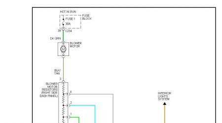

I turn the heater/AC switch to the on position and nothing happens (car running), the blower does not come on. I checked the fuse and is ok. Any suggestions? Thanks

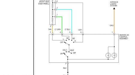

See below heater circuit-
https://www.2carpros.com/forum/automotive_pictures/12900_blower1_5.jpg
https://www.2carpros.com/forum/automotive_pictures/12900_blower2_6.jpg

Hello, you need to do some testing when the problem occurs. I'd check the fuse circuit, when the motor refuses to run. That circuit goes hot when you turn on the key. Might be something wrong with the motor itself, I've seen bad motor brushes cause an intermittent problem. The blower motor on-off/speeds are controlled on the ground circuit. Is it only one speed where the problem occurs, or it doesn't matter?

Sounds like the blower motor, to me. You can double check, Take the connector loose from the blower motor, run jumper wires from the battery for B+ and ground to the blower connector, use an inline fuse, just in case. If the blower motor still runs intermittently, faulty motor.

Pretty hard to tell over a computer but I bet the fan isn't running. If it will run on just the highest speed, suspect a defective resistor assembly in the heater box. If it doesn't run on any speed, the fan motor is the most likely suspect but the switch could be bad too. The place to start is by measuring the voltages on the two wires to the fan motor.
