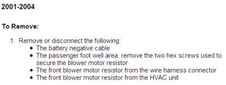

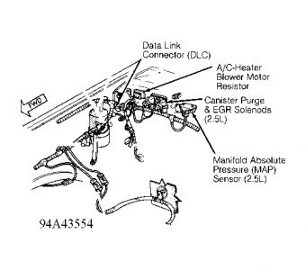

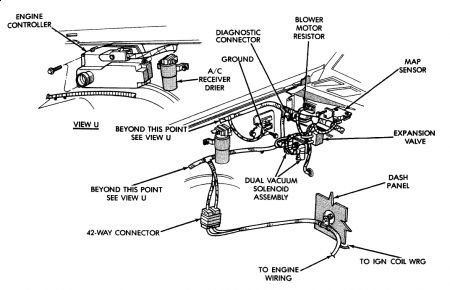

Check under the hood passenger side in the firewall. Check out the diagrams (Below). Please let us know if you need anything else to get the problem fixed.

where is the blower resistor , what does it look like, how can i swap out the blower resistor for a new one. is it complicated?
