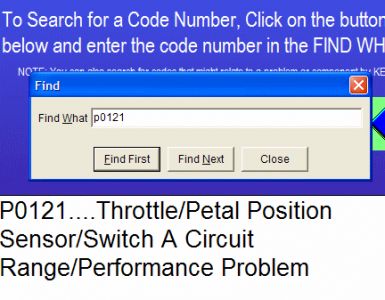

Code is p0121 can u tell what it is and how much to fix it
thank you
Tuesday, July 14th, 2020 AT 11:52 AM (Merged)
MERLIN2021
  • 17,250 POSTS
https://www.2carpros.com/forum/automotive_pictures/62217_dakota_1.jpg
Not sure how much, but it's the sensor on the gas pedal...look up price here:
