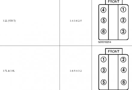

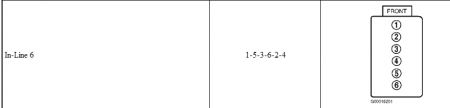

My 2004 Dakota pickup has the engine light on ,I need to know were I will find the 02 sensor, bank 2
Jul 14, 2020 at 4:50 AM (Merged)
MERLIN2021
  • 17,250 POSTS
Need the engine size in liters, there are three sixes used on this... Unless you know where the #1 cylinder is, that's bank 1 the other side is bank 2, there will be 2 sensors on each side for dual exhaust, and one each side(upstream) before the cat, and one after the cat.
https://images.2carpros.com/forum/automotive_pictures/62217_I6_1.jpg
https://images.2carpros.com/forum/automotive_pictures/62217_V6_2.jpg

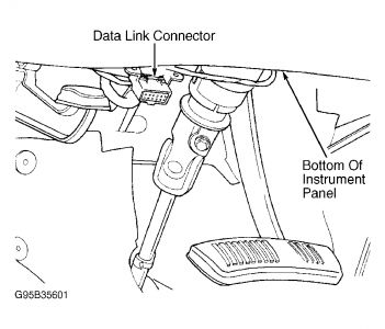

check engine light on have to scan for codes try this some Chrysler product will allow you to get the codes by cycling key on off 3 times ending with key ON read trouble codes in the odometer area Diagnostic Trouble Codes (DTCs) can be retrieved using scan tool. Connect scan tool to Data Link Connector (DLC). DLC is located below instrument panel near steering column.
