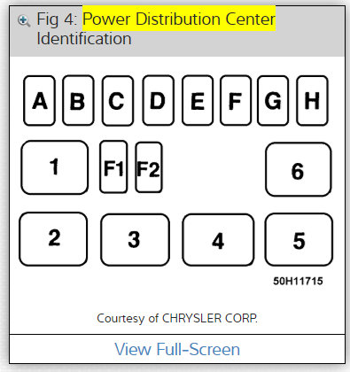

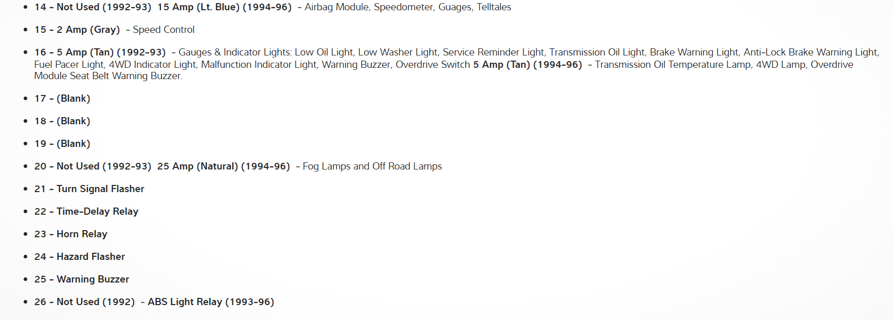

I have a 1992 Dodge Dakota and the check engine light won't come on and won't start. Already put a new fuel filter and fuel pump on it and checked fuses and relays.Can't figure out whats wrong.
Sep 24, 2010 at 1:57 PM
  • 110,244 POSTS

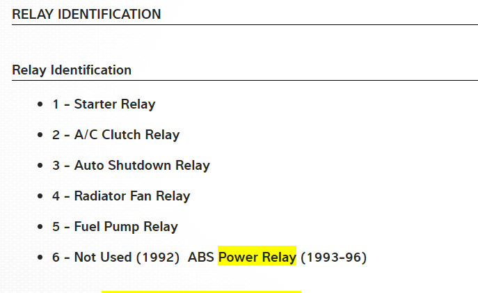

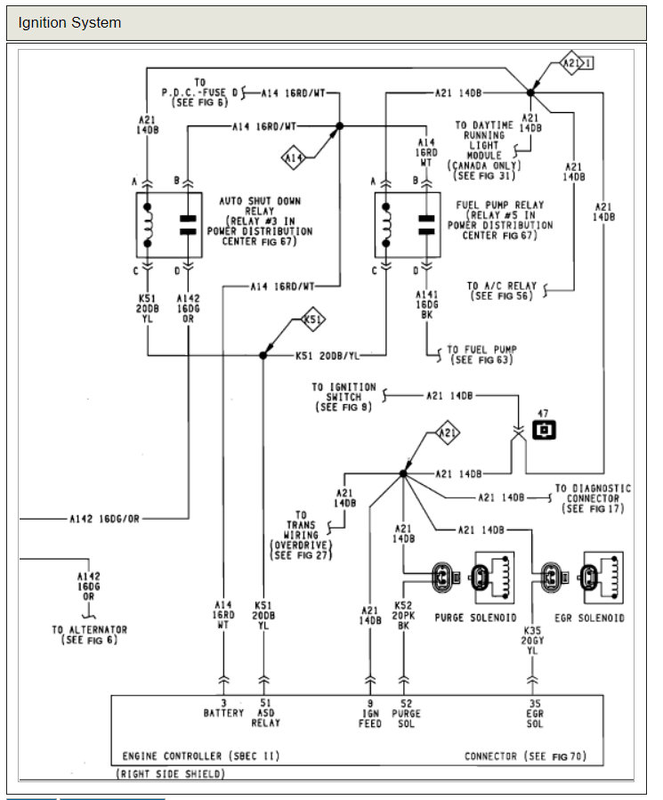

This sounds like you have an auto shut down relay that is having a problem here is a guide and a wiring diagram so you can see how the system works and a guide to help you test the relay.
Do that and let me know what you find.

Like i said check engine light does not come on. Cant get any codes when it don't come on. I will check the relay tonight

On these vehicles, the light doesn't need to come on. I have owned Dakotas for years. Presently I have a 93. Sold my 92 to get an extended cab.

Unlike the newer vehicles, the light can be off and codes still be stored in the computer. If you have already tried the process, let me know.

I was trying to check the codes to see what the problem is but when I replaced the relay the system came back to life now everything is running great! thanks for your help this site rocks.
