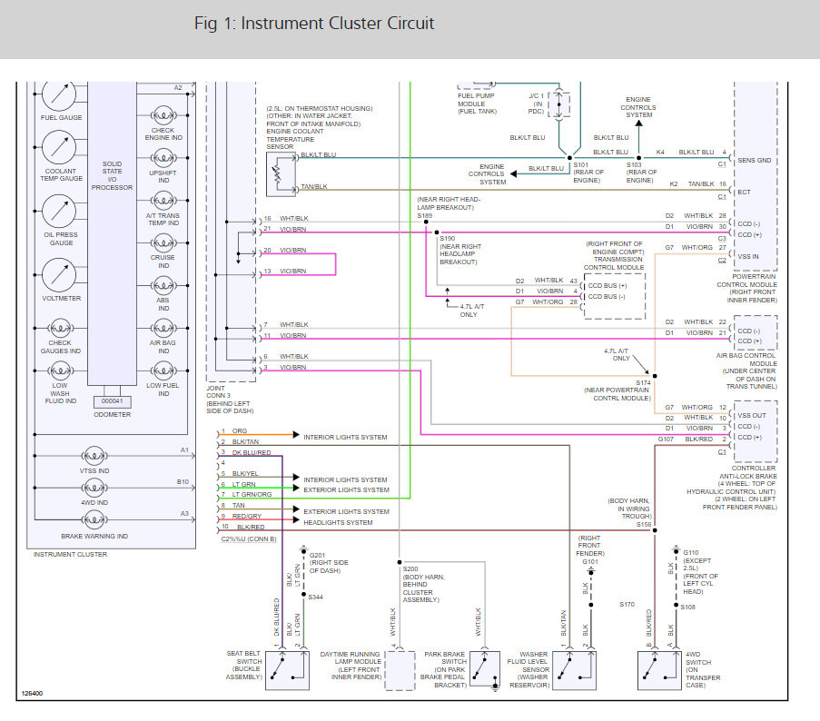

Hoping someone can help me I need a pin out for the Instrument cluster on my 2000 Dakota. Pulled to get to a line and lost it all. Im sure its a ground.

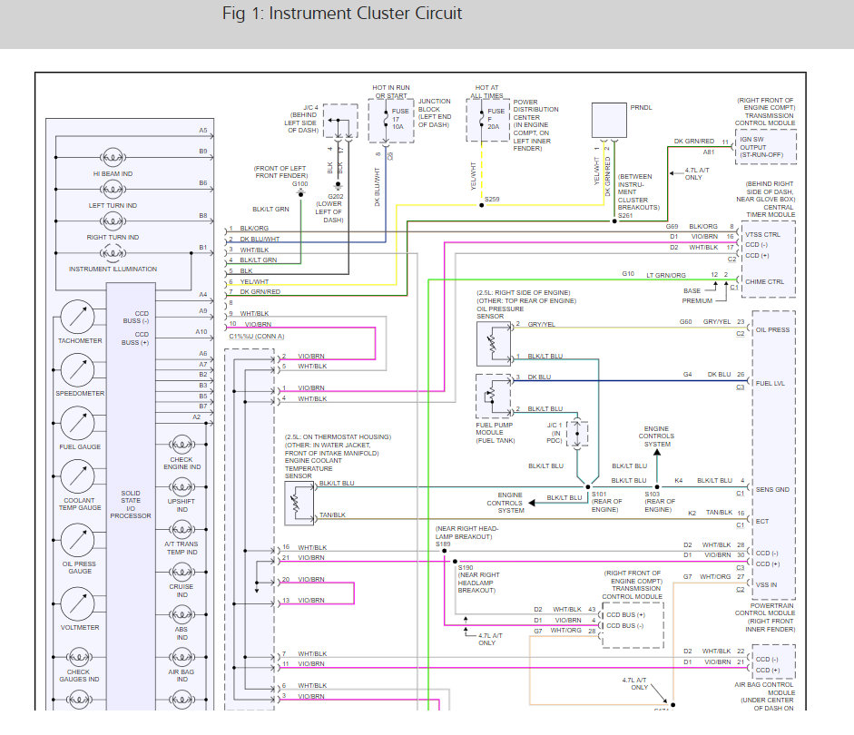

Here is a guide to help you check the wiring with the cluster wiring diagrams below so you can see how the system works:
Friday, August 16th, 2019 AT 11:16 AM
Just to add my $.02 the most common cause of this No BUS message is a faulty cluster. While a loose ground can cause the module to go off line, you normally would have some other fault codes because the loose or no ground will cause a lot of other sensor and gauge issues. If you have just a no bus signal then I would suspect the cluster is faulty first.
Let us know how you make out with this because we get this issue frequently so the more info about them, the better. Thanks
Monday, July 13th, 2020 AT 1:39 PM
