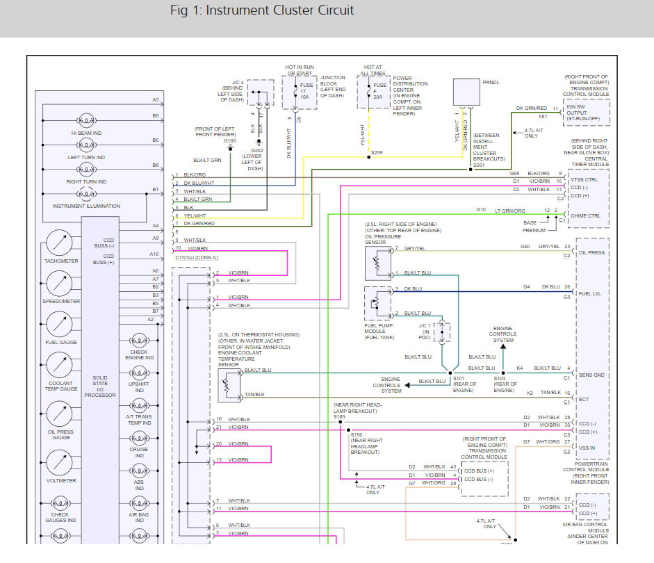

Hoping someone can help me I need a pin out for the Instrument cluster on my 2000 Dakota. pulled to get to a line and lost it all.. im sure its a ground.....
Aug 15, 2019 at 12:57 PM
  • 55,694 POSTS

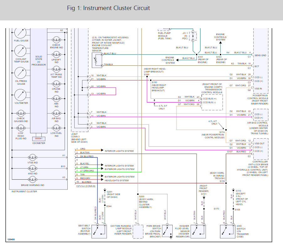

Here is a guide to help you check the wiring with the cluster wiring diagrams below so you can see how the system works:
Aug 16, 2019 at 4:16 AM
Just to add my $.02 the most common cause of this No BUS message is a faulty cluster. While a loose ground can cause the module to go off line, you normally would have some other fault codes because the loose or no ground will cause a lot of other sensor and gauge issues. If you have just a no bus signal then I would suspect the cluster is faulty first.
Let us know how you make out with this because we get this issue frequently so the more info about them, the better. Thanks
