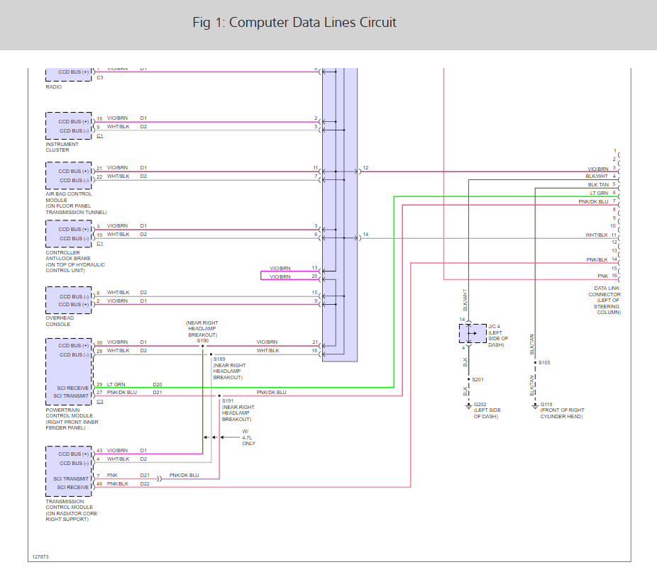

All the gauges went to ZERO while driving. The odometer reads "no bus error". The engine icon lights up and after maybe 10 seconds, the gas icon (service station pump) lights up, like a low gas tank warning. The engine cranks strong, just no spark or gas. Everything I read said to replace the ECM. So $300 later, I install the re manufactured ECM, reconnect the battery, turn the key...No Bus Error. Any help at all?? I have visually inspected all the fuses but don't know how to test the relays. It looks like this weekend I'll be checking all the fuses with a tester.
Apr 23, 2009 at 10:50 PM
BMRFIXIT
  • 19,053 POSTS

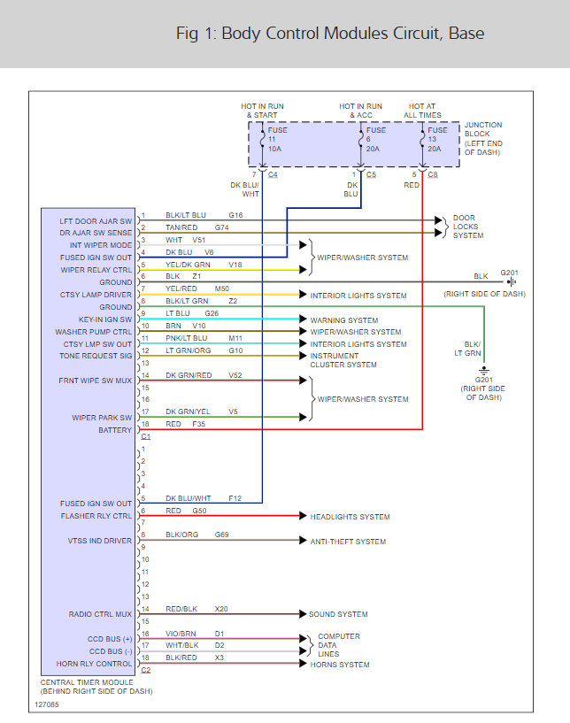

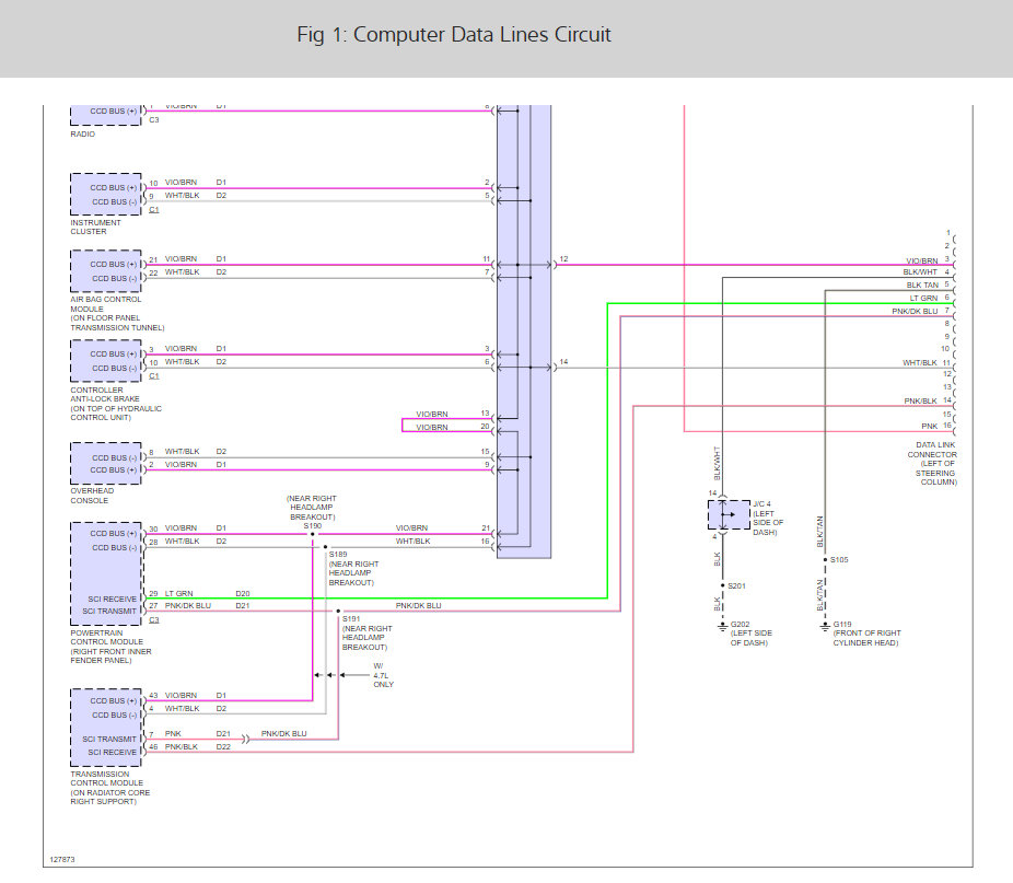

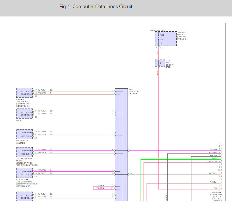

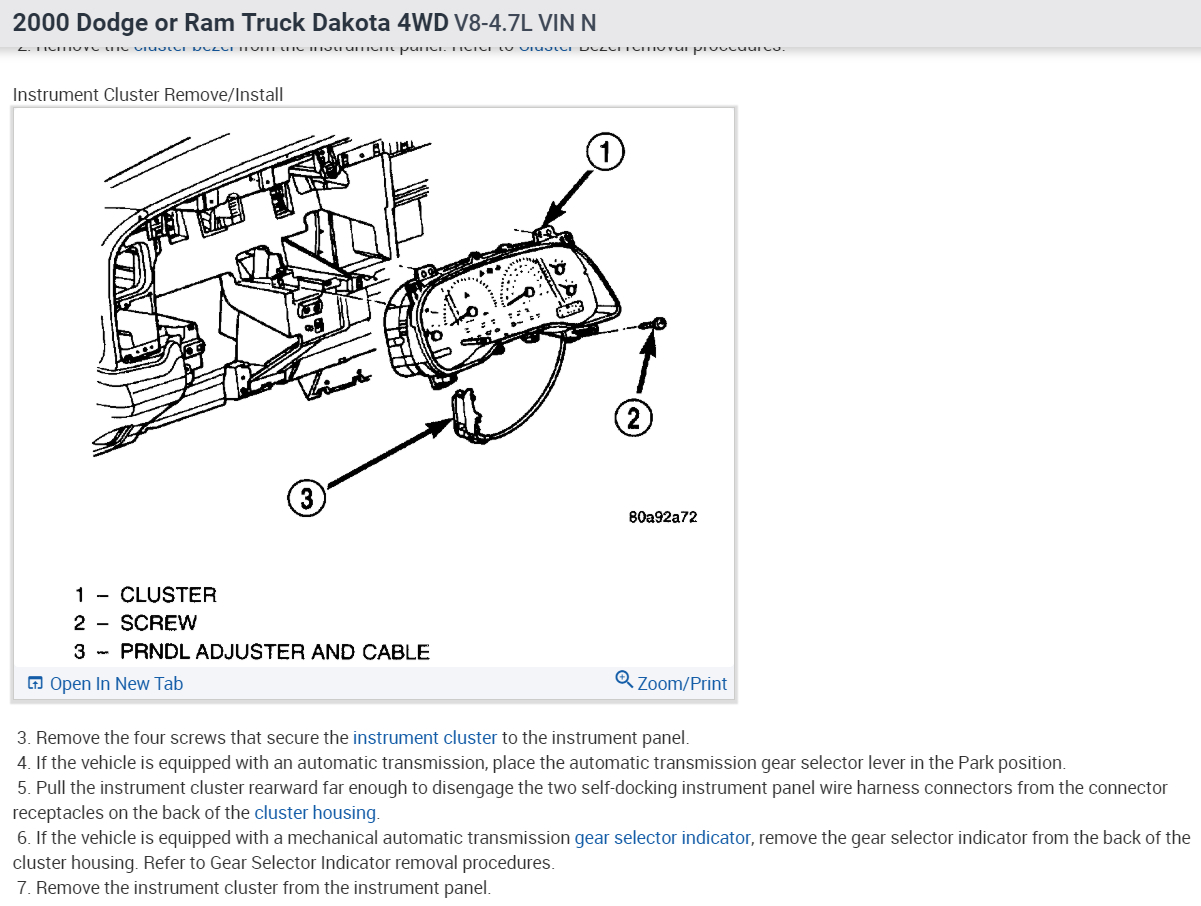

I have seen the cluster go bad and cause this problem here are diagrams and a video of the job being done on a similar car so you can change it out with a used/rebuilt unit.
https://youtu.be/_HEC44xENxw
Check out the diagrams (Below). Please let us know what you find.

My next idea was to pull the instrument cluster and clean up any contacts, as well as getting a hold of a light tester and checking my fuses. When the odometer blinks several times and then the no bus error shows up, an engine icon also lights up, followed in about 10 seconds by a low fuel icon. Should the fuel icon lighting up direct me somewhere?

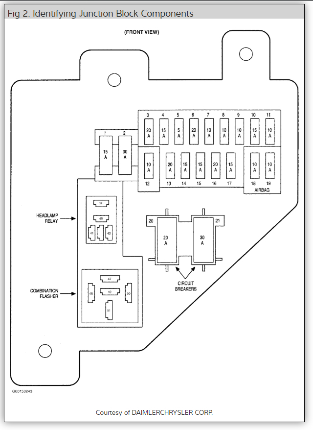

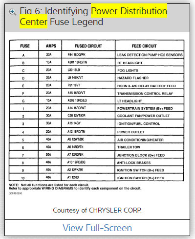

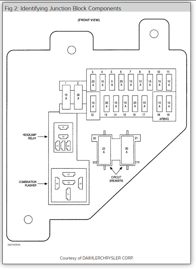

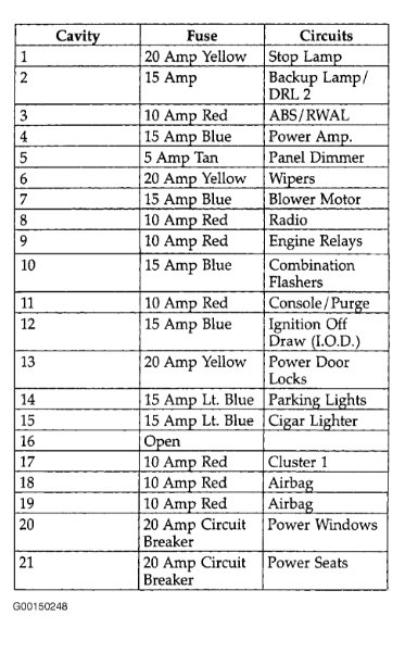

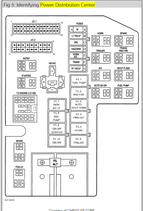

Where I'm seeing a reference to a fuse, that means there is a fuse at that spot? So there could be fuses besides by the battery and inside at the drivers end of the dash?
I've checked all the fuses in those 2 places. I could not get the 2 for the airbags out - had a different type of clip and I didn't want to force them and have the air bags blow up!!
On the diagram, for instance, The Power Distribution Center shows a 20A and a 30A fuse. Is that someplace I should look for fuses also?
And I don't think there's a way I can check the control relays, is there? I have a fuse tester and a circuit tester.

BMRFIXIT
  • 19,053 POSTS
Now we have a problem
can not read the wiring schematic
as for the relay just mark it and switch it with similar one
use a test light to check for power at both sides of the fuse
and no need to remove fuse
at the PCM unplug it and check wire where it say power also use a test light and or voltmeter

  • 55,381 POSTS

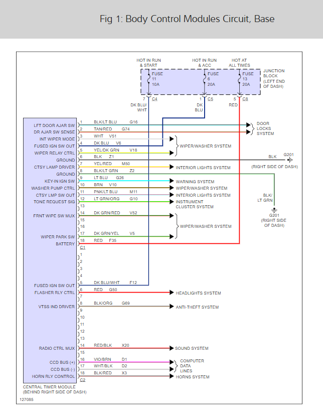

There are four fuses (6, 13,11 and 12) that run the BUS we need to check for power. here is a guide to help and the wiring diagrams so you can see how the system works with the fuse locations as well:

the PCM, or engine computer is like any device that provides power fused. There are two places where all these must be checked with a test light. under the hood and in the interior fuse block also. you know where the engine compartment fuses are, near the battery in the power dristribution center. check em with the key on. the crank sensor gets a power feed from the PCM so if a wire was pinched and as it ran wore through you may have lost any one of 3 or 4 fuses it needs. And the crankshaft sensor itself is a tought nut to get to and easy to get damaged or if it's gray wire gets shorted you may have blew the PCM, the controlling computer for spark, timing, and fuel. Check the fuses and make sure the gray wire has voltage while cranking. ok, I just wanna help. You may have squeexed a wire. Happens all the time, it's not an easy job to change the trans on a truck. Good luck. ok
Jun 26, 2019 at 5:03 AM (Merged)
  • 110,240 POSTS
Which relays are hot?
HELENJAY
  • 10 POSTS
ok its the 6 on the left of relay box ...
auto shut down
a/c clutch
trailer relay
fuel pump relay
headlamp relay
trans relay
then there are 2 missing under them
thet are suppose to be o2 sensors front and rear
  • 110,240 POSTS
Try replacing the fuel pump relay to see if that takes care of the problem.
