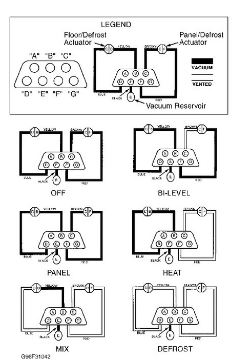

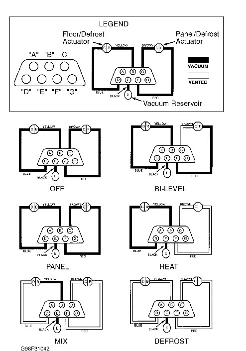

Ok so just got everything put together but for some reason one of the things on the outside of the ac/heatercore housing is not functioning. It has two hoses connecting to it. A brown hose and a red hose and they are together side by side and I have tried both positions of the hose how they would fit on the vacuum-like mechanism. It has an arm going from it to the middle of the housing and make one slot open while one closes. It seems like it distinguishes where the air flow goes in the dash but it is not functioning. Immediate help would be great I have everything set to go and it is just this little thing that is holding me up. Thanks. I have attached an I age to show you which part I am talking about. The hose about it is for climate control with a cable running through it. You can see the two hoses that hook up to it if you look very closely.
Wednesday, February 6th, 2019 AT 2:47 PM (Merged)
HMAC300
  • 48,601 POSTS
That is for your panel/defrost selection i'm sending a chart along. If the actuator is marked red goes to the "f" terminal. It may be hard to see on the thumbnail. Make sure you are plugged in an dgetting vacuum to the control switch your main line may be off

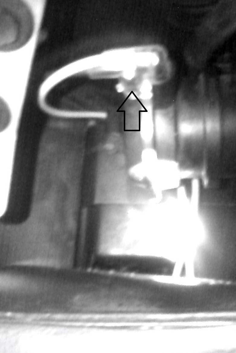

I have a 1994 Dodge Dakota 3.9L W/ AC. I am in the process of replacing the heater core. I have taken the lower instrument panel completely off, and now I am stuck looking at the heater box, with no idea what to do next. I need to know how to get the box off so I can access the core.
  • 109,885 POSTS
Here are the directions I was able to find for you. Let me know if it helps.

I have these instructions already, and I have gotten down to the step where it says "disconnect the blower motor connector and remove the thermal insulator retainer from the heater unit." I don't know where these are located, nor the demister hoses, vacuum harness connector, or really anything else listed there. I don't think that is super important though, my main goal is to find the 4 Heater/Air Conditioning Unit attaching nuts and the heater/AC Support Screw and Bracket so that I can get the actual heater box out. Once i'm past that step, I think I can tackle it. Is there any pictures of this anywhere?

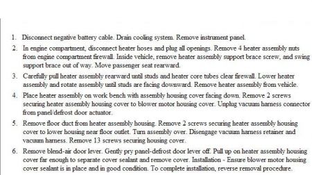

I need to replace my heater core. Misting thru the ac vents and pooling fluid in the passenger side floor. Can you route me to previous forum descriptions for the repair process so I can review.
Thanks

BLUELIGHTNIN6
  • 16,542 POSTS
https://www.2carpros.com/forum/automotive_pictures/261618_Noname_1183.jpg

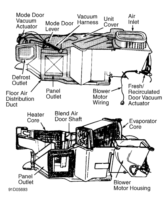

How to replace heater core and 1996 Dakota, v-6 with air?
  • 75,992 POSTS
EVAPORATOR CORE & HEATER CORE
Removal & Installation (Dakota)
Remove the evaporator/heater assembly. Refer to EVAPORATOR/HEATER ASSEMBLY.
With evaporator/heater assembly removed, remove nut from blend air door shaft. See Fig. 2. Using pliers, press linkage arm off b lend air door shaft. Disconnect vacuum lines from vacuum actuators.
Remove assembly cover screws from defroster outlet and air inlet openings. See Fig. 2. Remove remaining screws from top of unit cover. Remove unit cover.
Remove retaining screws, and remove heater core. Remove evaporator core. To install, reverse removal procedure.

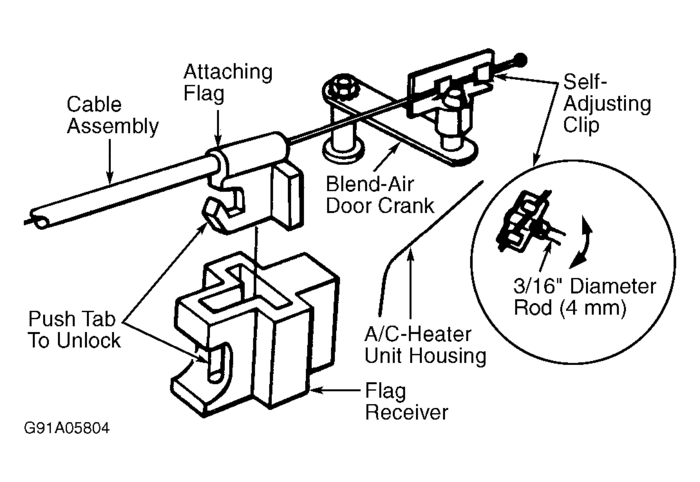

Slip cable self-adjusting clip upward from blend air door crank. Insert a 3/16" (4 mm) diameter rod in crankpin access hole, and rotate self-adjusting clip from cable. See Fig. 3.

need instructions on heater core install

The 2carpros manuals are very easily followed and the job will require the a/c to be evacuated, recycled, and recharged.
It is about a 6 hour job start to finish with air, and power tools.
