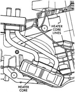

having trouble getting heater core back in is there a secret to making it easier

No, they are a pain. Here are the directions I was able to copy for you:
https://www.2carpros.com/forum/automotive_pictures/249084_heat_1.jpg

I must have hit submit too fast. Here are the directions I found:
Disconnect the battery negative cable.
Remove the instrument panel from the vehicle.
If equipped with air conditioning, recover the refrigerant.
Disconnect the liquid line refrigerant line fitting from the evaporator inlet tube.
Ram: remove the accumulator.
Dakota, Durango: disconnect the accumulator inlet tube.
Drain the cooling system.
Disconnect the heater hoses from the heater core tubes.
Ram: remove the powertrain control module from the dash panel. Disconnecting wiring is not necessary.
Remove the four nuts from the heater-A/C mounting studs on the engine compartment side of the dash panel.
Remove the nut(s) that secure(s) the heater-A/C housing mounting brace to the stud(s) on the passenger compartment side of the dash board.
Pull the housing rearward far enough for the mounting studs and evaporator condensate drain tube to clear the dash panel holes.
Remove the housing from the vehicle.
Lift the heater core out of the housing.
Installation is the reverse of removal.
