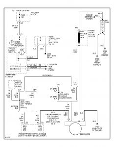

I have had the altenator bench tested and tried a new altenator, I had the battery tested (checked good) and still can not get the altenator to charge the battery. I have replaced the PCM twice. When I put the 1st new PCM in the battery charged at 13.57 for about 5 minutes and then dropped to 11.97 and declined. I had a repair shop check the charging system and put the second new PCM. They drove it and I checked it at the shop and it was charging at 13.75. I thought I had the problem fixed. I drove 35 miles home and all seemed fine. Went to drive the truck to the store and same old problem was back. The system is only chraging at 11.87. The repair shop does not have a clue as to what is happening.What could be burning out these PCM,s. HELP!!!

Don't suspect PCM 1st wiring issue most likely check connector at the PCM plug
https://images.2carpros.com/forum/automotive_pictures/99387_Graphic_91.jpg
Using an external voltmeter, connect one voltmeter lead to B+ (battery) terminal on rear of generator. Connect other voltmeter lead to positive battery terminal. Go to next step. Start engine and note voltage reading on voltmeter. If voltage is more than 0.4 volt, repair B+ circuit between battery and generator for high resistance If voltage is 0.4 volt or less, go to next step. Turn ignition off. Using external voltmeter, connect one voltmeter lead to generator case. Connect other voltmeter lead to negative battery terminal. Go to next step. Start engine and allow to reach operating temperature. Note voltage reading on voltmeter. If voltage is more than 0.1 volt, repair generator ground circuit between battery and generator for high resistance If voltage is 0.1 volt or less, go to next step. Maintain engine speed at 1600 RPM. Using scan tool, read target charging voltage and charging voltage. Compare readings. If difference between readings is more than one volt, repair or replace generator as necessary . If difference between readings is one volt or less, go to next step. Allow engine to idle. Turn ignition off. Perform TEST CH-1A - CHARGING SYSTEM NO CODE TEST. TEST CH-1A - CHARGING SYSTEM NO CODE TEST NOTE:Perform DTC TEST , Ensure battery is fully charged before proceeding. Inspect generator belt for proper tension and good condition. If generator belt is okay, go to next step. If generator belt tension is incorrect or belt is damaged, repair as necessary. Start engine. Using scan tool, set engine speed at 2000 RPM for 30 seconds. Using scan tool, return engine speed to idle and read Diagnostic Trouble Codes (DTCs). If any DTCs pertaining to charging system exist, go to appropriate test. . Turn ignition off. Turn ignition on with engine off. Using scan tool, actuate generator field. Using scan tool in voltmeter mode, backprobe Dark Green wire at 2-wire connector on rear of generator. Voltage should cycle from zero volts to battery voltage every 1.4 seconds. While monitoring voltage display on scan tool, wiggle wiring from 2-pin connector on rear of generator to Powertrain Control Module (PCM). PCM is located between driver's side front fender and power distribution center, near battery. If no interruption of normal voltage cycle exists when wiggling wiring, go to next step. If interruption of normal voltage cycle exists when wiggling wiring, repair wiring as necessary. Using scan tool, read DTCs. If any DTCs exist pertaining to charging system, go to appropriate test. Using external voltmeter, connect voltmeter positive lead on B+ (battery) terminal on rear of generator. Connect voltmeter negative lead to positive battery terminal. Start engine and note voltage reading on voltmeter. If voltage is 0.4 volt or less, go to next step. If voltage is more than 0.4 volt, repair B+ circuit between battery and generator for high resistance. Turn ignition off. Using external voltmeter, connect voltmeter positive lead on generator case. Connect voltmeter negative lead to negative battery terminal. Start engine and note voltage reading on voltmeter. If voltage is 0.1 volt or less, go to next step. If voltage is more than 0.1 volt, repair generator ground circuit from generator case to negative battery terminal for high resistance. Remove external voltmeter. Using scan tool, read and record battery voltage reading. Using external voltmeter, read and record battery voltage between positive and negative battery terminals. Compare both voltage readings obtained in step 11). If difference between both voltage readings is less than one volt, test is complete. If difference between both voltage readings is one volt or more, go to next step. Turn ignition off. Disconnect PCM connectors. Using external voltmeter, check voltage between ground and terminal No. 22 (Red/Black wire) at PCM Black connector. Compare voltage reading to voltage reading obtained using scan tool in step 11). If voltage reading is not within one volt of voltage reading obtained using scan tool in step 11), replace PCM If voltage reading is within one volt of voltage reading obtained using scan tool in step 11), repair high resistance on Red/White wire between PCM Black connector terminal No. 22 and battery.

I have completed all checks, although I do not have a scan tool the machanic that worked on my truck said he ran all scan checks. I traced Red/white wire and found everything fine. Today I tried to do an external voltage regulator with no improvement. I connected the external voltage regulator as discribed on the internet (both field terminal wires connected to each prong on the external voltage regulator and a 12v wire connected to the the top prong with one of the field wires also mounted it to the firewall for ground). The only time I have been able to get the altenator to charge is by replacing the PCM (like I said twice), however it seems like something is burning out the PCM's after a short while.

OPERATION The amount of amperage produced by the generator is controlled by Electronic Voltage Regulator (EVR) circuitry within the PCM. EVR circuitry is connected in series with the generator field driver terminal and ground. A Battery Temperature Sensor (BTS), located in battery tray, is used to sense battery temperature. Sensed battery temperature and data from monitored line voltage is used by PCM to adjust battery charging rate. This is accomplished by cycling the ground path to control the strength of generator rotor magnetic field. PCM then compensates and regulates generator amperage output accordingly. 80% of the test depend on a scan tool to communicate and energize the field And other than using an Ohm meter to check for short and or poor connection most of the test is invalid
https://images.2carpros.com/forum/automotive_pictures/99387_Graphic_94.jpg

check email for wiring daigram

Thanks for the wiring diagram. I will continue to shot wires. In the mean time, I got an external voltage regulator to work. I wired as I had seen on this website and NOW HAVE (woo hoo) the battery charging at 13.52 volts. Maybe you can tell me why the coil fuse blows anytime I tramp the gas pedal on the highway or in park in the driveway? I replaced the 10 amp fuse with a 30 amp and am able to drive it a normal speeds. But if I tramp the gas it will blow the fuse and shut the truck down. Putting another good fuse in gets me going again. I appreciate all the help you have provided.
