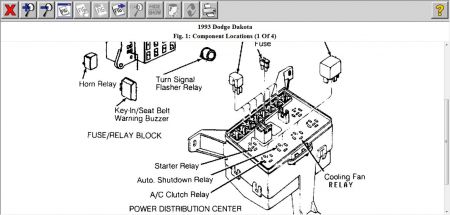

my truck dont have power in the coil I did check all fuses and I change the coil but stiil dont send pawer to the distribuitetor

Check and test the ASD relay it powers the coil and injectors.

Where is locate the asd relay

Its in the PDC
