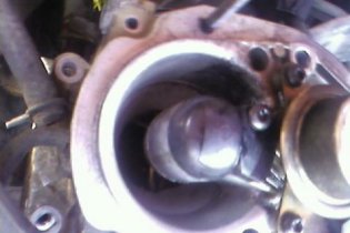

Replaced fuel pump still no gas inside carb, is there something else i should check, i will donate again. i have attached pictures.

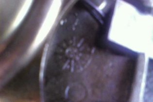

I am sorry but confused there is no float on carb took apart this seems to be electrical, i want to donate more money but might need it if i do not figure this out is it possible this is electrical, thank you

https://www.2carpros.com/forum/automotive_pictures/307237_pulled_carb_1_1.jpg

I didn't say anything when I saw the picture, but this doesn't look like a carb. It looks like a throttle body (fuel injection). If I am correct, the injector is the round part on the top. That is where the fuel should come from. If there is none, the injector it self may be bad. It is replaceable.

Jacobandnickolas is right; that's a throttle body, not a carburetor. Before you get wrapped around the axle and pedal down the wrong road, you need to do a complete diagnosis and check for spark. More than likely it's missing too. The common cause is the Hall Effect pickup assembly under the rotor in the distributor.
Pulses from the pickup assembly tells the engine computer to turn on the Automatic Shutdown (ASD) relay. That relay sends voltage to the alternator field, the injector, the ignition coil, and the fuel pump or pump relay. If you have spark during cranking, the ASD relay has to be turning on and the pickup assembly has to be working. Chances are it's not.
Your parts guy recommended a noid light to determine if the computer is trying to fire the injector. That's a non-issue if you also don't have spark. The pickup assembly isn't real expensive and only takes a few minutes to replace.
